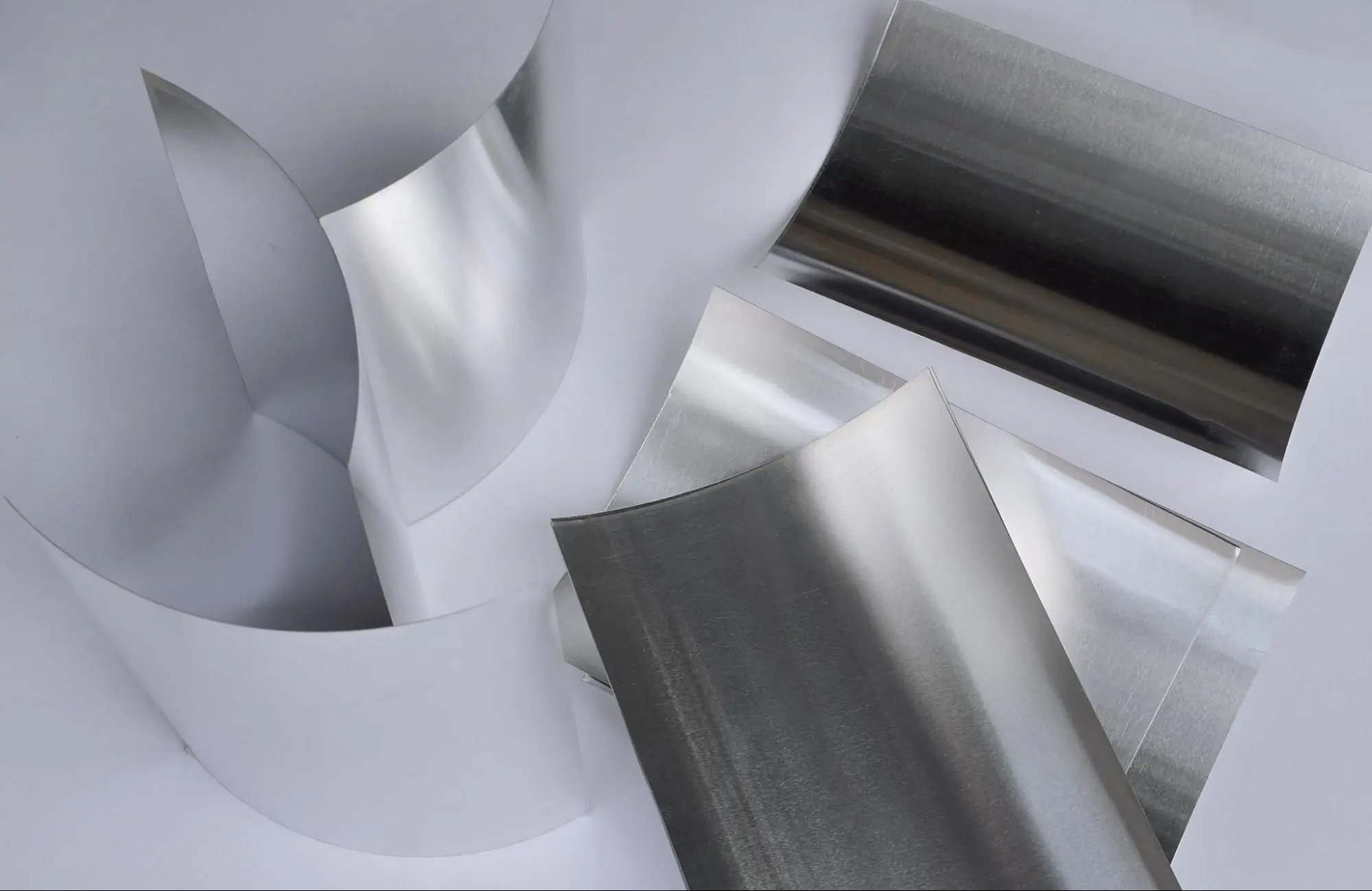

Thin sheet metal parts are components manufactured from low-thickness metal stock. There’s no universal definition of what qualifies as “thin,” but the parts discussed here are typically less than 3 mm thick. However, low-thickness metal parts are not defined by the manufacturing process used, but by their low material thickness relative to their overall geometry.
While it’s common to associate thin metal parts with sheet metal, the category is broader; it also includes precision-machined components that require thin walls or fine features. These parts can be produced using processes such as laser cutting, punching, bending, and CNC machining to achieve higher-precision features.
Because of their reduced thickness, thin metal parts behave differently from thicker components made using the same processes. They are more sensitive to the forces generated during manufacturing (heat, stress, etc.) and handling, which makes them more prone to warping, bending, tolerance variation, and damage during assembly.
This is why designing thin metal parts isn’t as simple as just making them as thin as possible. Manufacturers must consider how far a given process can reliably go while still maintaining structural integrity and precision. As parts approach low-thickness ranges, design constraints become more critical, and even small features require careful consideration.

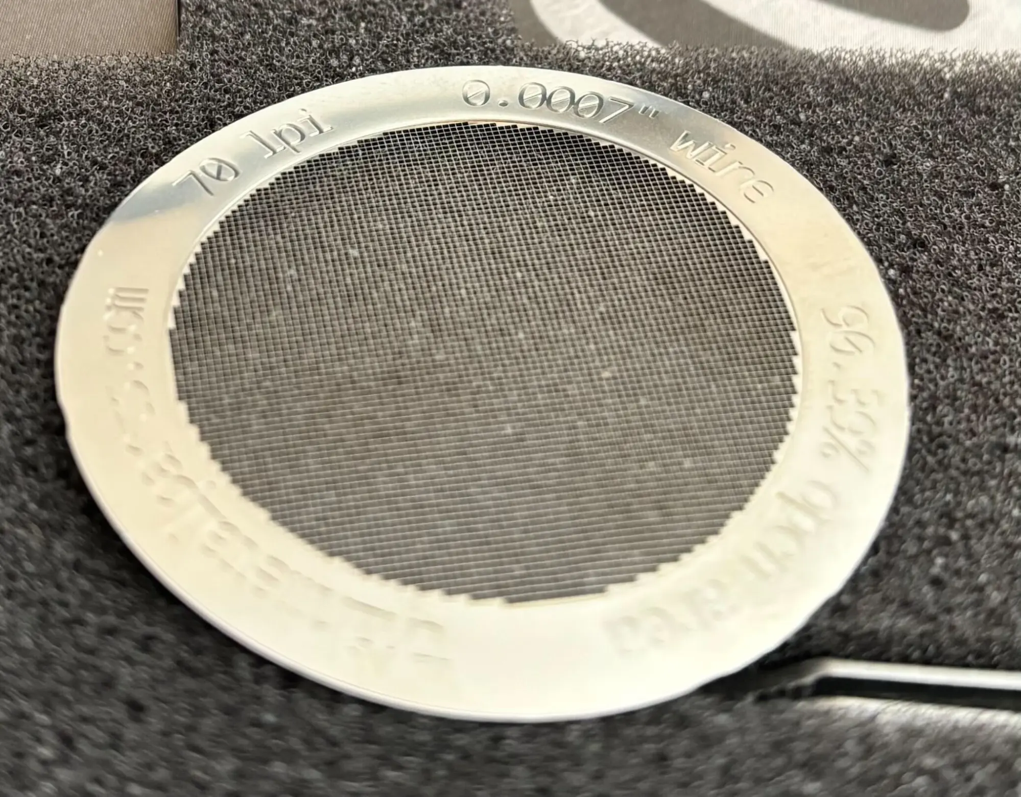

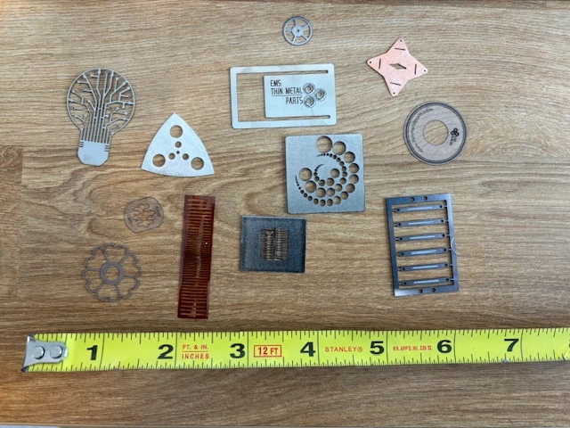

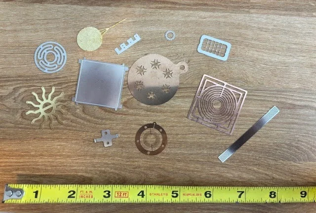

Photochemical etching (PCE), also called photochemical machining, is the process behind the thinnest parts in this guide, including foil-gauge components down to 0.0003″ (7.6 microns). Rather than cutting or stamping, PCE applies a photoresist mask to the metal, exposes the desired pattern, and dissolves the unmasked material in a chemical etchant. With no mechanical force, heat, or tooling contact, PCE produces burr-free, stress-free parts with no work hardening or heat-affected zone — an advantage for foils and geometries too delicate for laser cutting or punching.
PCE suits flat, two-dimensional geometries: EMI/RFI shielding, battery tabs and contacts, encoder discs, flexures, fuel cell plates, fine mesh, and lead frames. Tolerances typically run ±10% of material thickness (tighter on ultra-thin foils), and minimum feature size generally needs to equal material thickness, similar to punching. Because etching removes material isotropically, edges have a slight taper rather than the perpendicular wall of laser cutting or punching — worth accounting for in tight-fit designs. PCE doesn’t form 3D geometry on its own; parts needing bends are etched flat and formed as a secondary step.
