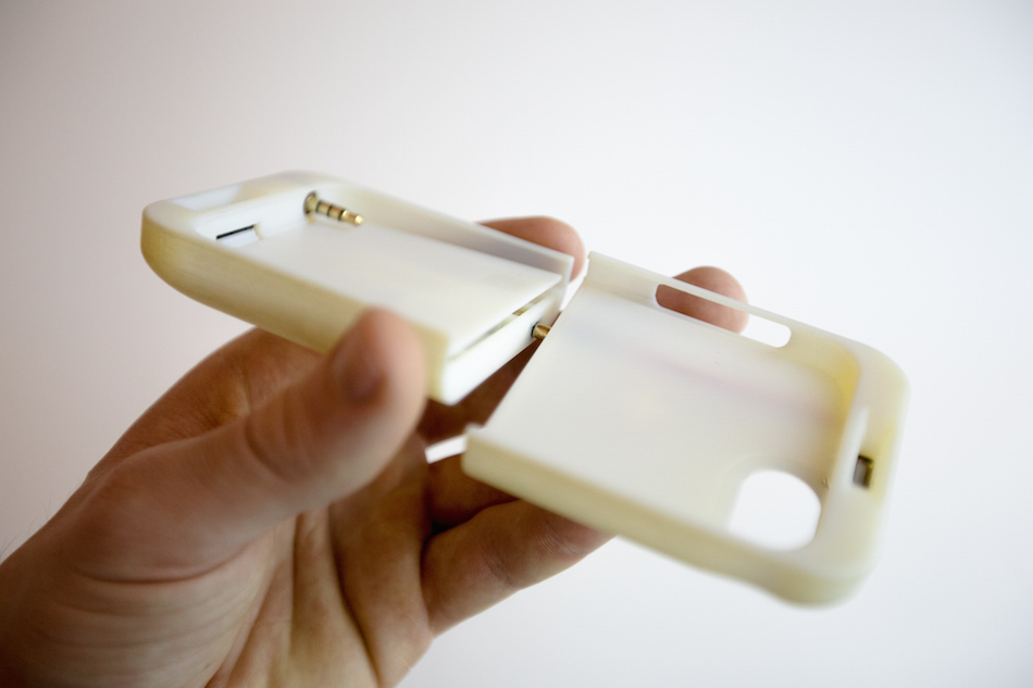

3D Printing Technologies
The most common rapid prototyping approach is 3D printing, and for good reason. The technology is versatile and fast for prototype fabrication. Many design options can be tested and printed in a matter of hours or days (depending on design factors like complexity and size). 3D printing utilizes inexpensive materials to test an idea or concept before transitioning to more expensive, high-grade materials. This allows designers to perfect their designs and prove their concepts before moving to production.
3D-printed phone case prototype
Various 3D printing methods can be used for rapid prototyping, but the most common include fused deposition modeling (FDM), stereolithography (SLA), and selective laser sintering (SLS). Let’s take a look at what sets these processes apart.
FDM is the most widely used technique for rapid prototyping. It works by creating objects by extruding melted thermoplastic, one layer at a time. FDM is popular because it is affordable and compatible with materials such as ABS, PLA, and even engineering-grade plastics. However, it has limitations in resolution and surface quality, with rough finishes and challenges in producing intricate geometries unless post-processing or soluble support materials are used.
Stereolithography (SLA)
SLA offers much higher accuracy by curing liquid resin with a UV laser, creating smooth parts with fine details that closely resemble final products. SLA supports a variety of resins with different optical, mechanical, and thermal properties. With SLA, it’s possible to mimic end-use materials. While it can be fast, especially with DLP or MSLA systems, SLA requires additional steps like washing, curing, and support removal, and its build volume is smaller than that of other methods, which can slow down the workflow for large parts.
SLS takes a different approach, using a laser to melt and bond plastic powder into solid parts. Because unfused powder supports the print during the build, no support structures are needed. SLS is ideal for complex geometries such as undercuts or internal channels. SLS parts are strong and functional, often resembling injection-molded components, and the process can produce multiple parts in a single run. The main drawbacks of SLS are rough or porous surfaces, along with risks of warping or shrinkage. To overcome this, parts often undergo finishing steps like bead blasting, media tumbling, or chemical smoothing for plastics, or heat treatment and hot isostatic pressing (HIP) for metals.

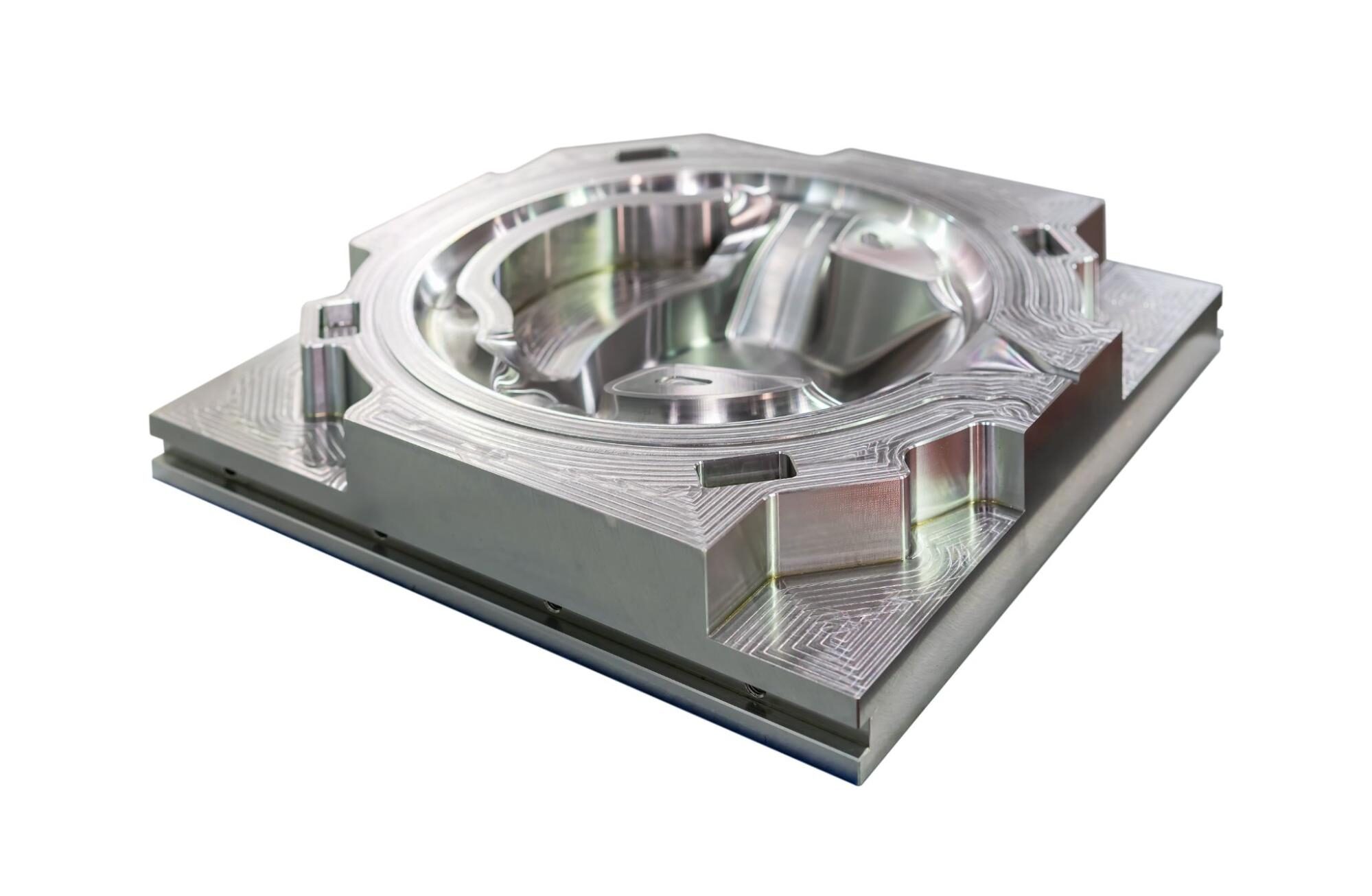

CNC Machining
CNC (computer numerical control) tools, unlike 3D printing methods, are subtractive in nature. This means that material is removed from a base “block” to form the desired shape, rather than being built from the ground up in a layer-by-layer fashion as with 3D printing. Various cutting and drilling tools are used to shape the workpiece. The tools are directed into a cutting path using CAD or CAM (computer-aided manufacturing) files.
CNC-machined prototype part
CNC machined prototype part
The big advantage of CNC machining is that it works with many materials that you may use in production. You can use plastics or metals such as aluminum, steel, brass, copper, or titanium. It can also handle non-traditional materials like wood, foam, and fiberglass. However, CNC machining can be more expensive than 3D printing. There are also design constraints to keep in mind. The size of the part will be limited to the size of the material block, and highly complex geometries are often better suited for additive manufacturing techniques.

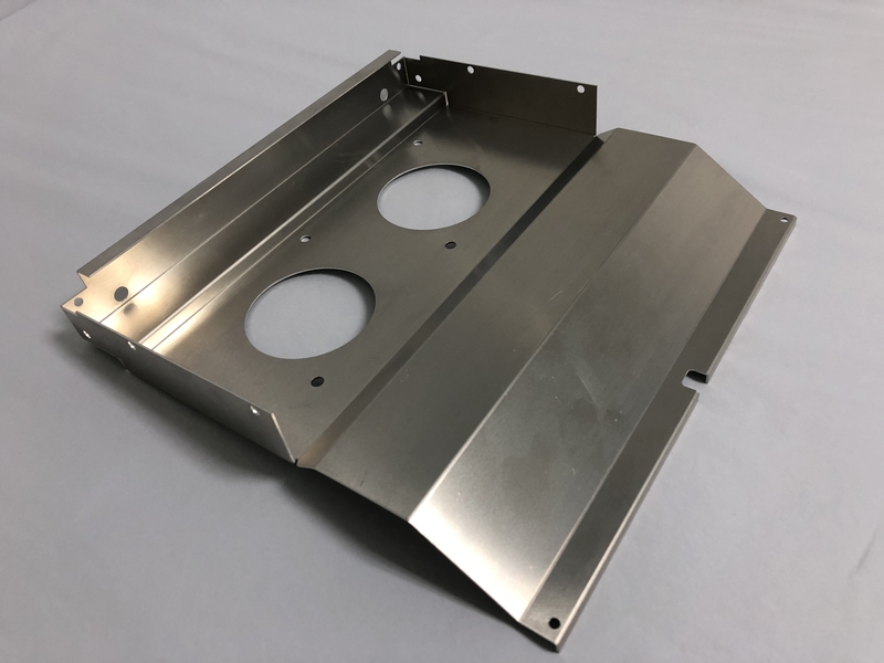

Sheet Metal Prototyping
Sheet metal rapid prototyping is a manufacturing process that uses thin sheets of metal to quickly create a physical prototype of a product or component. It uses manufacturing techniques such as laser cutting, waterjet cutting, bending, stamping, and welding, which produce functional prototypes in the actual material of the final product. It is particularly well-suited for making brackets, housings, enclosures, chassis, and other structural components that need to resemble final production parts in both strength and functionality.
Prototype sheet metal part
One of the main advantages of sheet metal prototyping is that it uses actual production-grade materials such as aluminum, steel, stainless steel, or copper. This allows engineers to test parts under real-world conditions, including load-bearing and environmental stresses, which is not always possible with plastic-based prototyping methods. Because the process relies on the same forming and fabrication techniques used in high-volume manufacturing, it also helps identify design-for-manufacturability (DFM) issues early, reducing costly adjustments later in the production cycle.

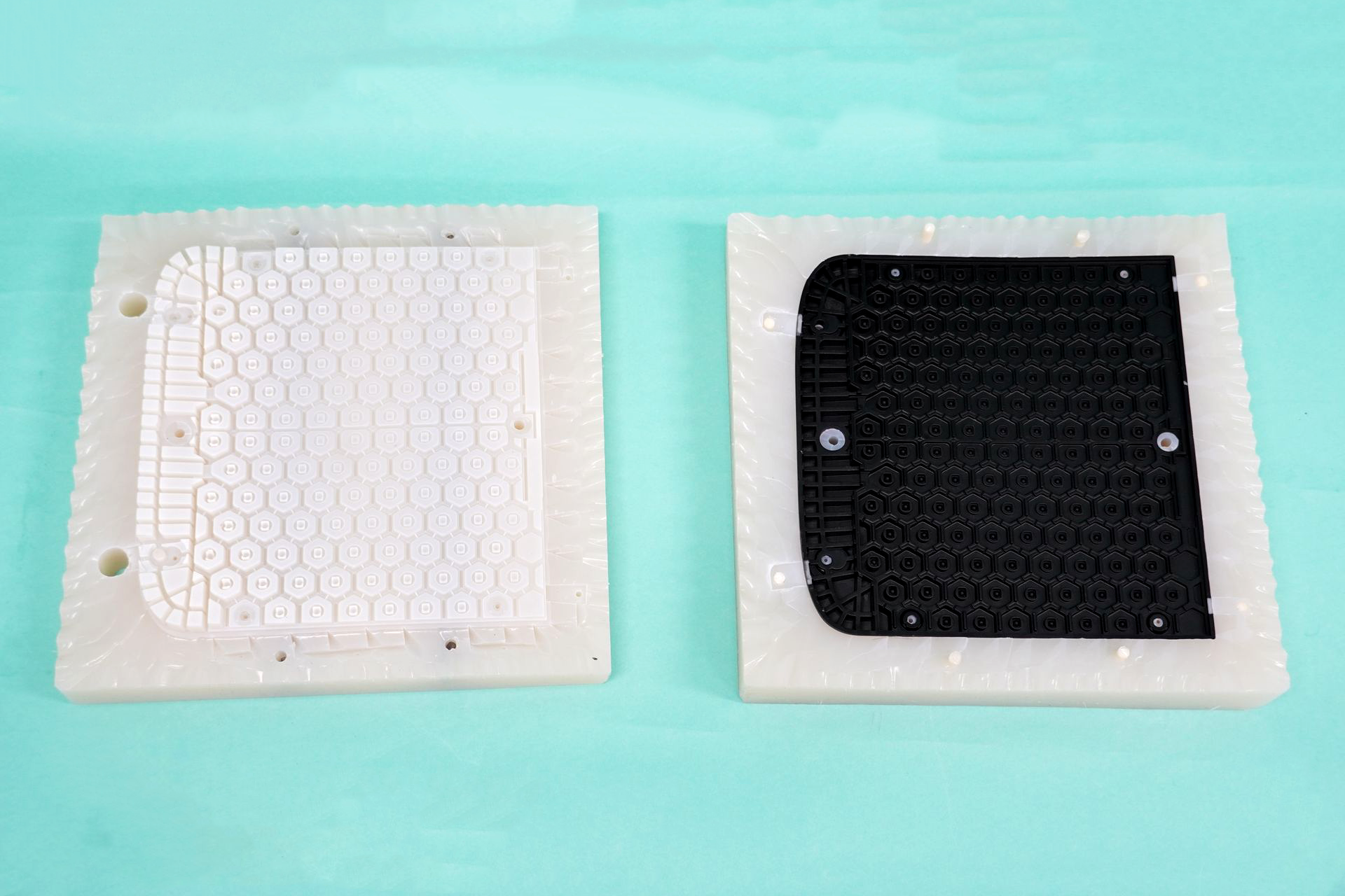

Urethane Casting (Vacuum Casting)
Urethane casting, sometimes called vacuum casting, is a rapid prototyping technique in which liquid polyurethane resins are poured into a silicone mold to create highly detailed parts and cosmetic models. The process often takes place under a vacuum, which removes air bubbles and ensures that the finished part is smooth and defect-free.
Urethane casting prototype
One of the biggest advantages of urethane casting is the versatility of the materials. Polyurethane resins can mimic the mechanical, thermal, and visual properties of a wide range of production plastics, from rigid ABS-like parts to flexible elastomer-like components. However, the molds can wear out after a limited number of uses.
Additionally, while urethane parts are strong and functional, they are generally not as robust as injection-molded parts, especially under high stress or heat. This is because these resins are thermosets rather than true thermoplastics, so their performance envelope is narrower. They can approximate production plastics but generally lack the same long-term durability, high-temperature resistance, and fatigue strength as injection-molded parts.

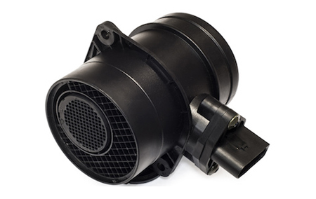

Rapid Injection Molding
Rapid injection molding is a prototyping and low-volume production method that uses aluminum or soft steel molds to quickly produce parts with the same materials and processes used in traditional injection molding. It’s designed to shorten the lead time of mold creation, making it possible to fabricate functional, production-grade parts in just days or weeks, instead of months.
Injection-molded prototype
This method is valuable for validating designs, performing functional testing, and even delivering small production runs before investing in expensive, hardened steel molds.  Because rapid injection molding uses production-intent material, the parts produced are nearly identical to those from mass production. It offers a high level of accuracy, detail, and repeatability.
The main advantage of rapid injection molding is the fast production of prototype molds. It can be used to bridge the gap between prototyping and full-scale production by giving engineers the ability to test designs under real-world conditions early on. It’s also more cost-effective than regular injection molding for low-to-medium volumes since the tooling is less expensive than traditional molds.
However, rapid injection molds aren’t as durable as full-production molds, typically supporting a few thousand shots instead of hundreds of thousands. For this reason, it’s not ideal for very high-volume manufacturing but excels in quick-turn prototypes, pilot runs, and parts needed urgently for testing or market validation.
