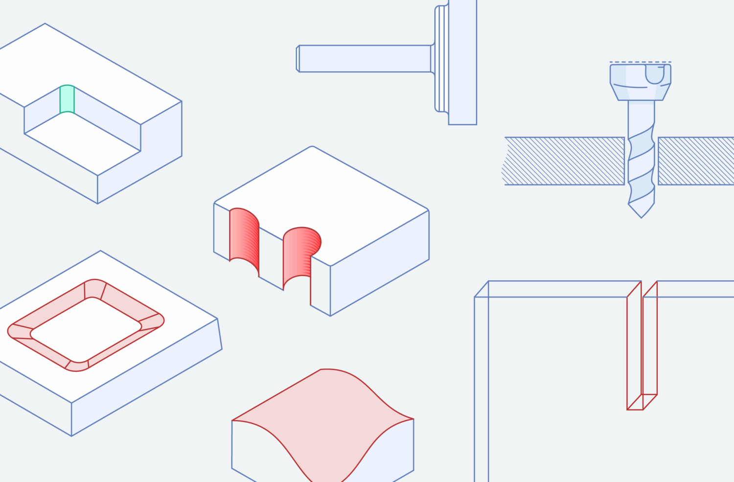

CNC Milling
CNC milling refers to the machining process of quickly subtracting material from raw stock until the desired shape is achieved. Milling is performed by round cutters (most commonly end mills) which chip away material laterally with shallow depths of cut. There are many different configurations of CNC mills from 3-axis all the way up to 12-axis. In a 3-axis CNC milling machine, the stock material is fixed in place, while the tool spins and moves up and down to remove material. The bed of the machine then moves side to side, and back to front. For more on what CNC machines can do beyond 3 axes, check out this article.
Commonly Available Cutting Tools
When designing your part, keep in mind the types of tools that are commonly available for CNC milling. If you are able to achieve the features and geometry you need with standard tools, you can reduce cost and lead time. Otherwise, the manufacturer will have to spend time and money sourcing or making specialty tools. Below are some tools that are commonly available in machine shops.
These standard tools also have standard sizes. Like drills and taps mentioned above, you want to design to these standard sizes as much as possible. For instance, with internal fillets, you don’t want to design them to have a radius that is slightly smaller than that of a standard cutting tool. This would require a tool change to a smaller tool just to achieve that one, probably unimportant, feature.
Avoid Sharp Internal Corners
Because milling is done with round tools, sharp internal corners cannot be achieved. Radiused corners are required, and must be larger than the cutter to be used. The radius of the corner will be half the diameter of the cutting tool. For instance, a 1⁄4 ” cutter can be used for fillets larger than 1/8”.
If another part with sharp corners needs to fit inside the cavity, the corners can be “broken” by drilling a hole. This opens them up, allowing sharp corners to fit inside.
Fillets are also necessary when a drafted or sloped surface meets a vertical wall or sharp edge. A square or ball end mill will always leave material between the wall and the surface below, unless that surface is perfectly flat and normal to the tool.
Avoid Deep, Narrow Slots
The final depth of cut of an endmill should be not greater than 15 times the diameter for plastics, 10 times the diameter for aluminum, and 5 times the diameter for steel.
This is because long tools tend to deflect and vibrate, resulting in bad surface finishes. For example, a slot for a machined steel part that is .55” wide (which will be cut using a .5” endmill) should be no deeper than 2.75”. Internal fillet radius, the above point, is also dependent on this tool diameter, meaning that any internal radii for this example should be greater than .25”. End mills with a high length to diameter ratio are also more difficult to source.
If you can, either decrease the depth of the slot or feature, or increase the diameter of the cutting tool (which may require increasing the width of the feature. If it is possible to reach the feature from two directions, reducing the necessary length of the tool, this could work. However, this will require an additional machining setup and will add to the cost and time of machining.
Design with the Largest Possible Internal Radii
The larger the cutter, the more material can be removed at one time, meaning less machining time and less cost. Always design with the largest allowable internal radii. Avoid radii less than 0.8mm whenever possible.Pro Tip: Make your fillets slightly larger than the radius of the endmill, for example, a radius of .130” (3.3mm) instead of .125” (3.175mm). This will produce a smoother path for the mill to take, resulting in a nicer finish.
