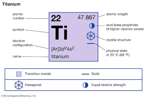

Titanium (Ti) is a shiny metal with a high corrosion resistance and high strength. Titanium is impressively lightweight and biocompatible. Titanium is a transition metal with atomic number 22, period 4 and group 4 on the periodic table. It has a hexagonal crystal structure and two electrons in its fourth orbital, with an electron configuration of 1s2 2s2 2p6 3s2 3p6 3d2 4s2. Titanium has common chemical properties with Zirconium.
