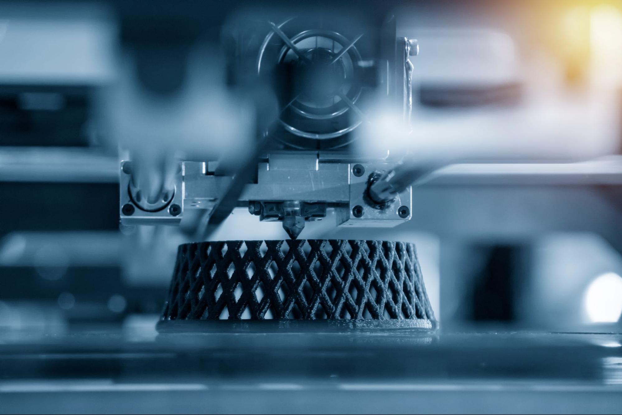

Close-up of FDM 3D printer making prototypes

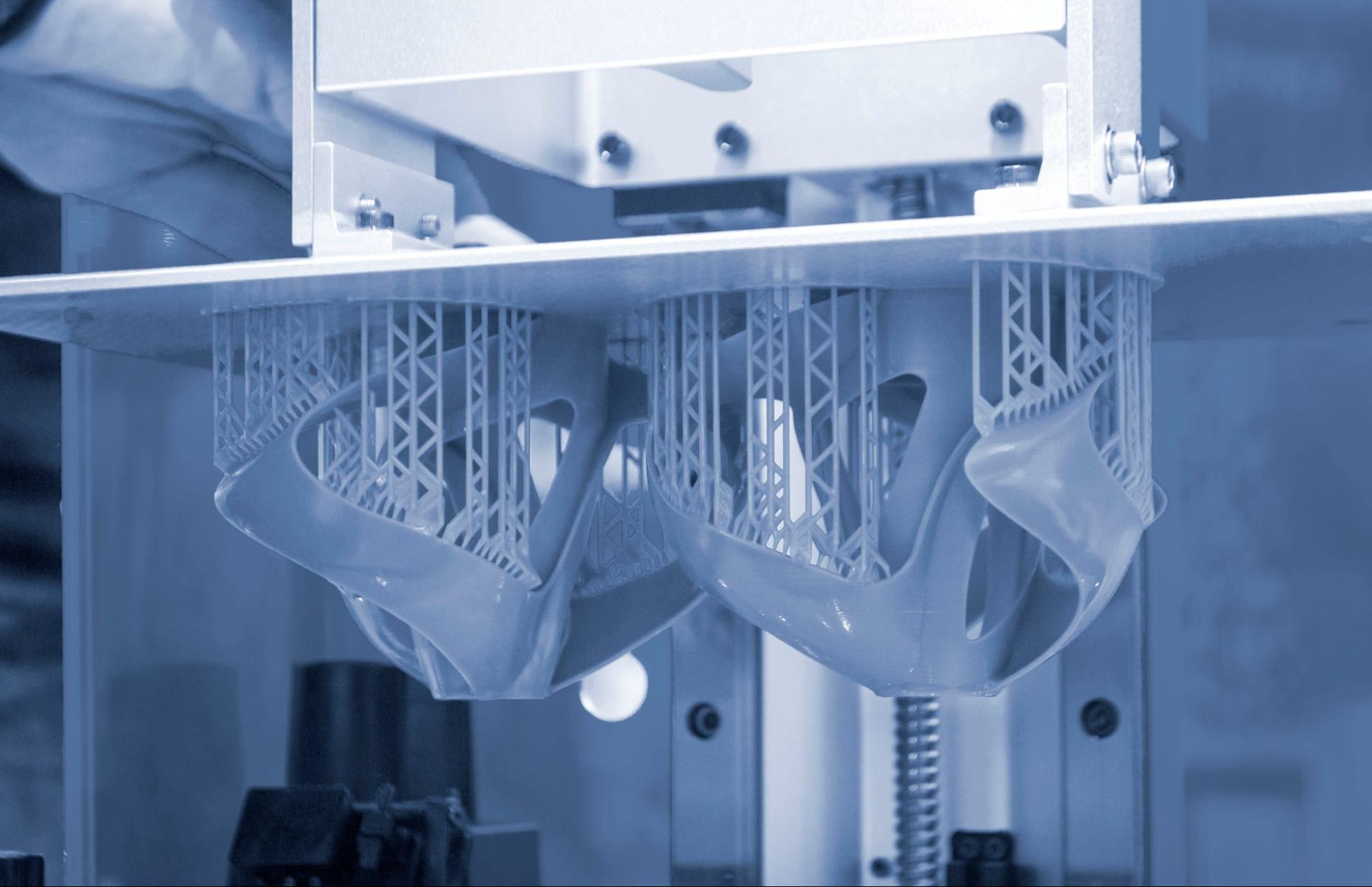

#SLA 3D-printed parts and support structure
SLA 3D printed parts and support structure

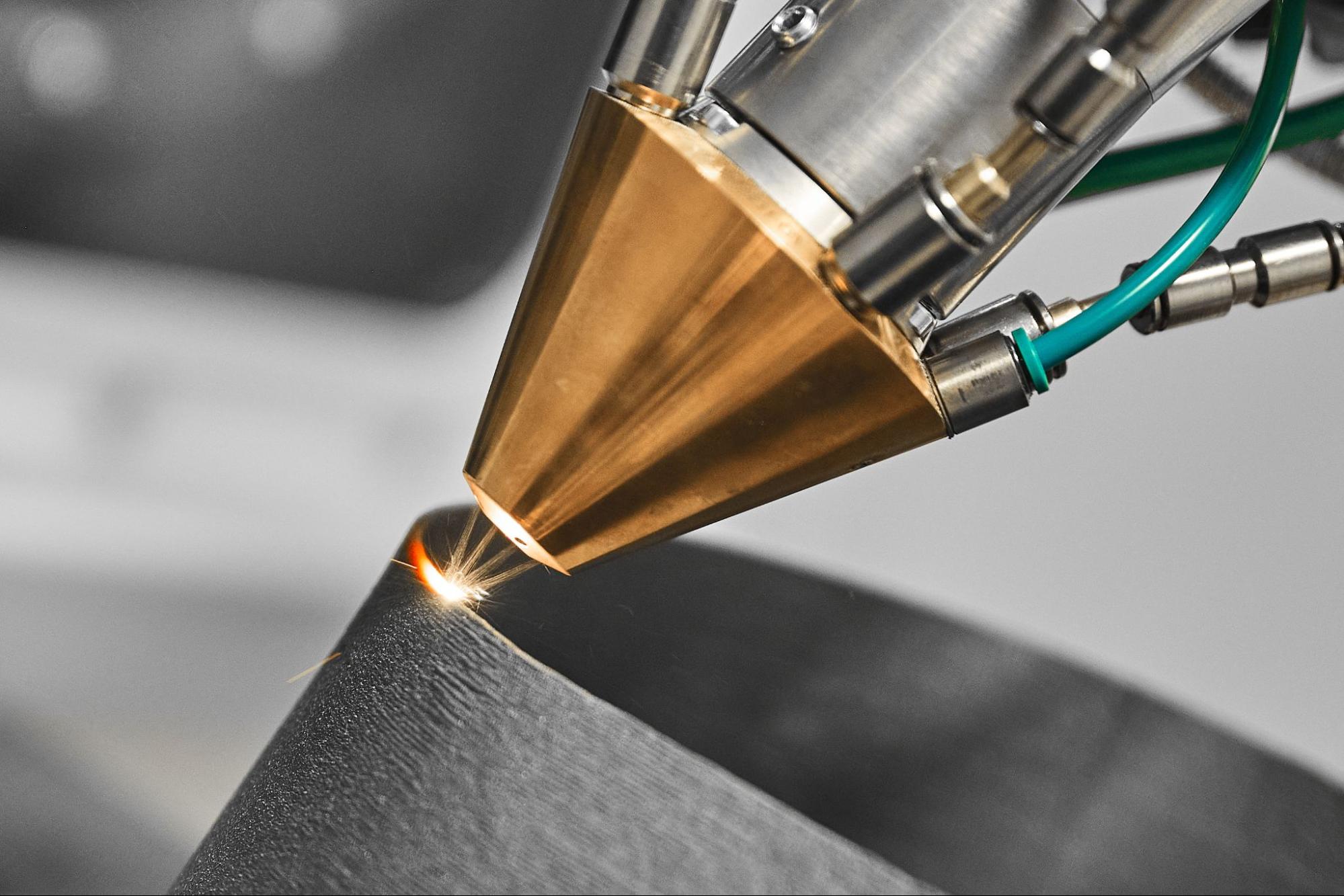

#SLS 3D printing using metal powder for prototype manufacturing

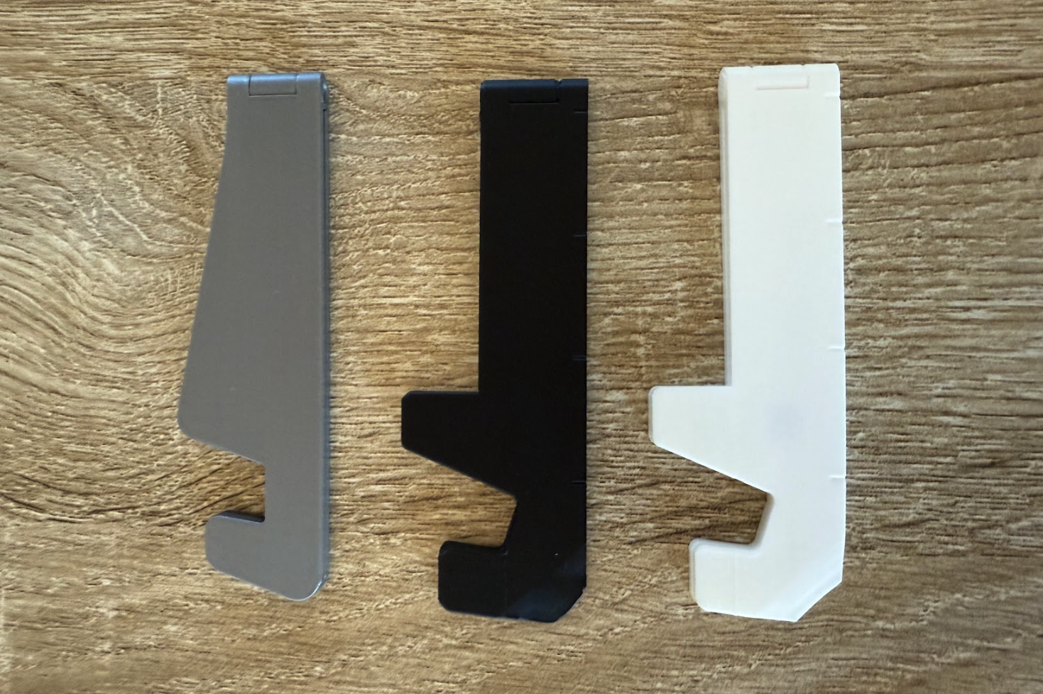

Learn more about how I used these processes to prototype and scale the FictivMade multi-tool phone stand project to production.
#3D-printed prototypes for the FictivMade project
3D printed prototypes for the FictivMade project

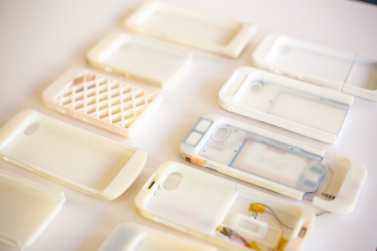

#3D-printed prototype phone case iterations
3D printed prototype phone case iterations
