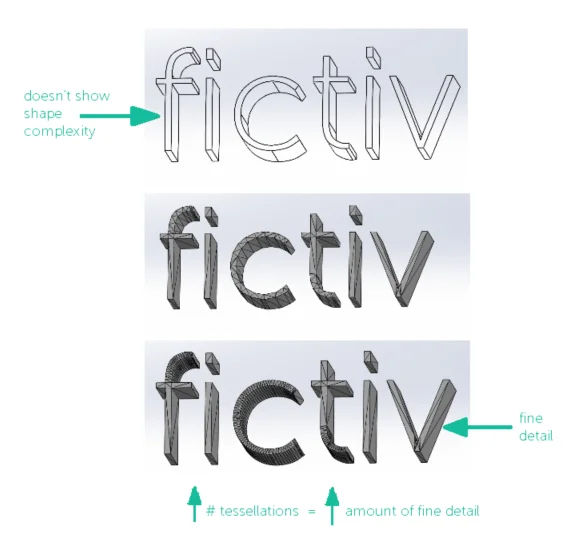

showing impact of tessellations on fine detail; image from:
showing impact of tessellations on fine detail image from
Mesh Modeling
A mesh model, on the other hand, is a collection of small triangles (tessellations) that make up a surface. A mesh model is typically created when a part is 3D scanned, which results in a copious amount of data points (dots) that comprise a point cloud. The mesh is created by resolving these points into variably sized triangles by connecting the dots. Although uncommon due to the complexity and tediousness of the process, a mesh may also be manually created.
