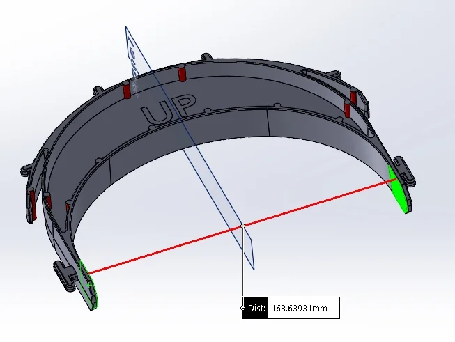

Bzzz: I was wrong. I did the calculation and got a clearance (see below):
This means that for the 95th percentile male head, the total expansion/contraction would need to be:
Scenario 1: Total Clearance=168.6-165=3.3 mm
I immediately thought, well, shoot, if it’s wide enough for this, and it needs to contract, then for a small female head, it’s going to need to contract way more! Back to the calc and back to NASA tables. Also, back to the top of my study, to expand the scope.
Following the same guidelines, I added my second scenario:
For the 5th percentile female head, the total head width is 144 mm.
Scenario 2: Total Clearance=168.6-144=12.3 mm

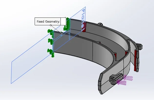

OK, so this part was right. The design would have to contract more. Now that I had a total clearance, I decided to assume that each side flexes equally and that people’s heads are mainly symmetrical. I took my total clearances and divided them by 2, to know how far each side of the head band would need to flex.
(If you’ve made it this far, this is really where I’m going to show you some tricks to get you where you need to go faster.)
To fully set up my boundary conditions, I divided my model in half and assumed it was symmetrical (that’s why I divided by 2 up above). I then fixed the portion of my cut in the FEA analysis (see green arrows). I then added a 1 N load to the head band strap fixation area (see image below).
![](https://www.fictiv.com/wp-content/uploads/2020/09/5ec5759a10bbeb25b1f857bd_fea-image02.jpg)

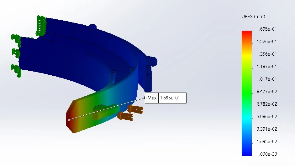

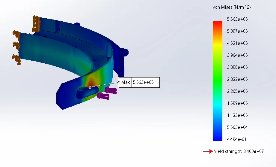

In rough, I had my simple boundary conditions of a more fancy looking cantilever beam scenario. Since I didn’t actually know my load force, I knew my target deflection. And since I have the simple, cheap FEA on Solidworks, I ran my analysis with a simple 1N load. And I got my results:
![](https://www.fictiv.com/wp-content/uploads/2020/09/5ec577b9845fc70cd32f5e4c_fea-image04.jpg)
For Taipro PP K1011, the maximum reported stress of Face B, and at a unit load of 1 N, was 5.633*10^5 Pa.
The deflection for the same 1 N unit load was 0.1695 mm.
