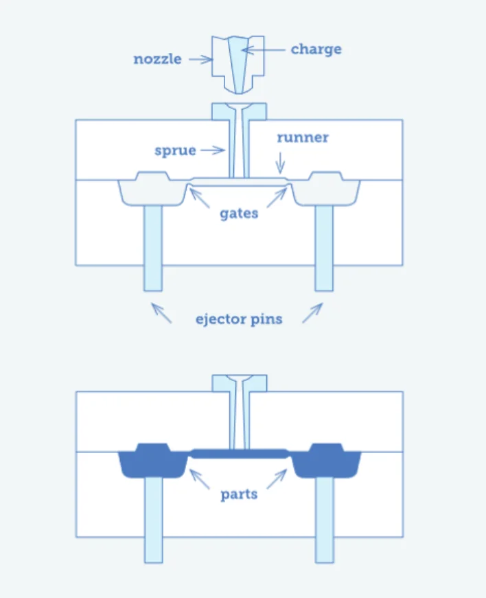

Ejection of molded parts is a fundamental step in the injection molding process. Proper ejection system design is essential for preventing injection molding defects such as drag lines, rib cracking, whitening, and deformation.
Injection pushes molten plastic into the mold.
Ejection pushes the part out of the tool after solidification and mold opening.

Cross-sectional diagram of an injection molding tool
Cross sectional diagram of an injection molding tool
This article will further discuss how injection molding ejection systems work, their types, design guidelines, and the common problems encountered.

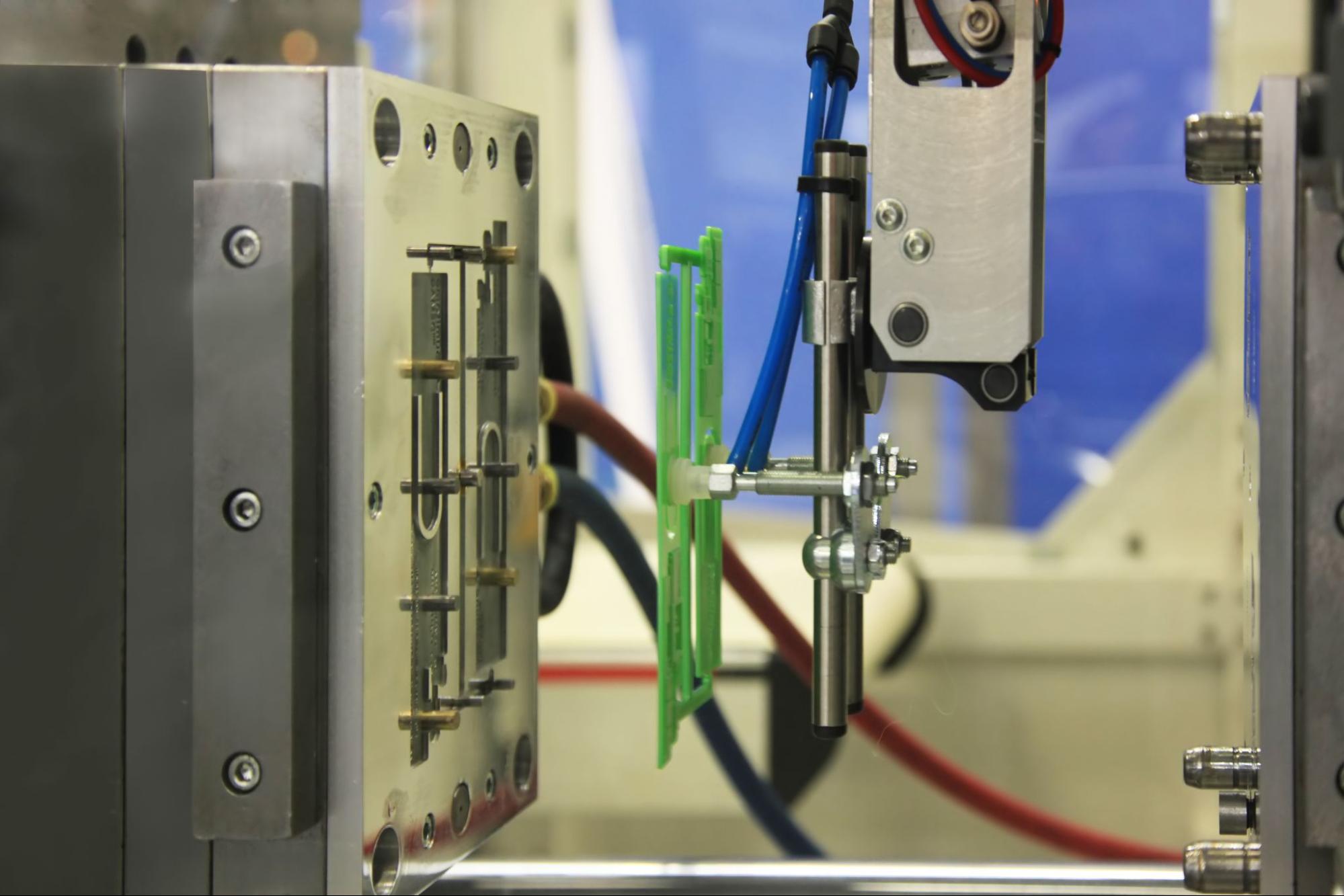

  • Mold opening distance must be sufficient before ejection.
Once the part fully clears the core, return pins bring the ejection system back to its starting position before the next mold closing event.
