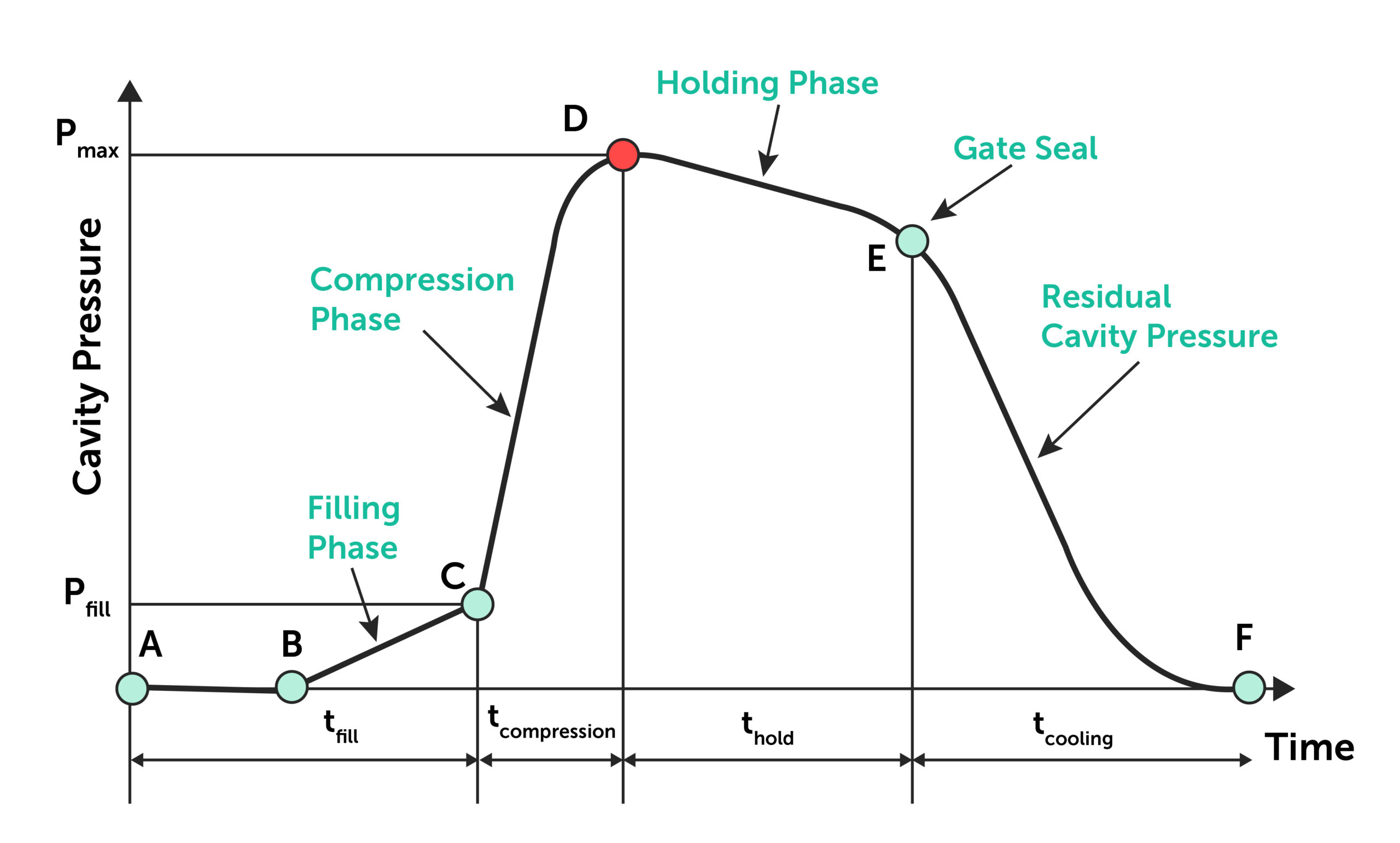

Injection, Packing, and Holding Pressure
Injection pressure drives molten resin into the mold cavity, rapidly filling the part geometry. Once the cavity is nearly full, packing pressure is applied to push additional resin in and compensate for volumetric shrinkage during the early stages of cooling. This ensures complete filling, prevents voids, and improves part density.
After the gate solidifies (gate freeze), no more resin can enter. At this point, the process shifts to holding pressure, which maintains pressure on the cavity to control shrinkage and minimize residual stresses as the material cools. Unlike packing, holding does not add more resin but stabilizes part dimensions until cooling takes over.

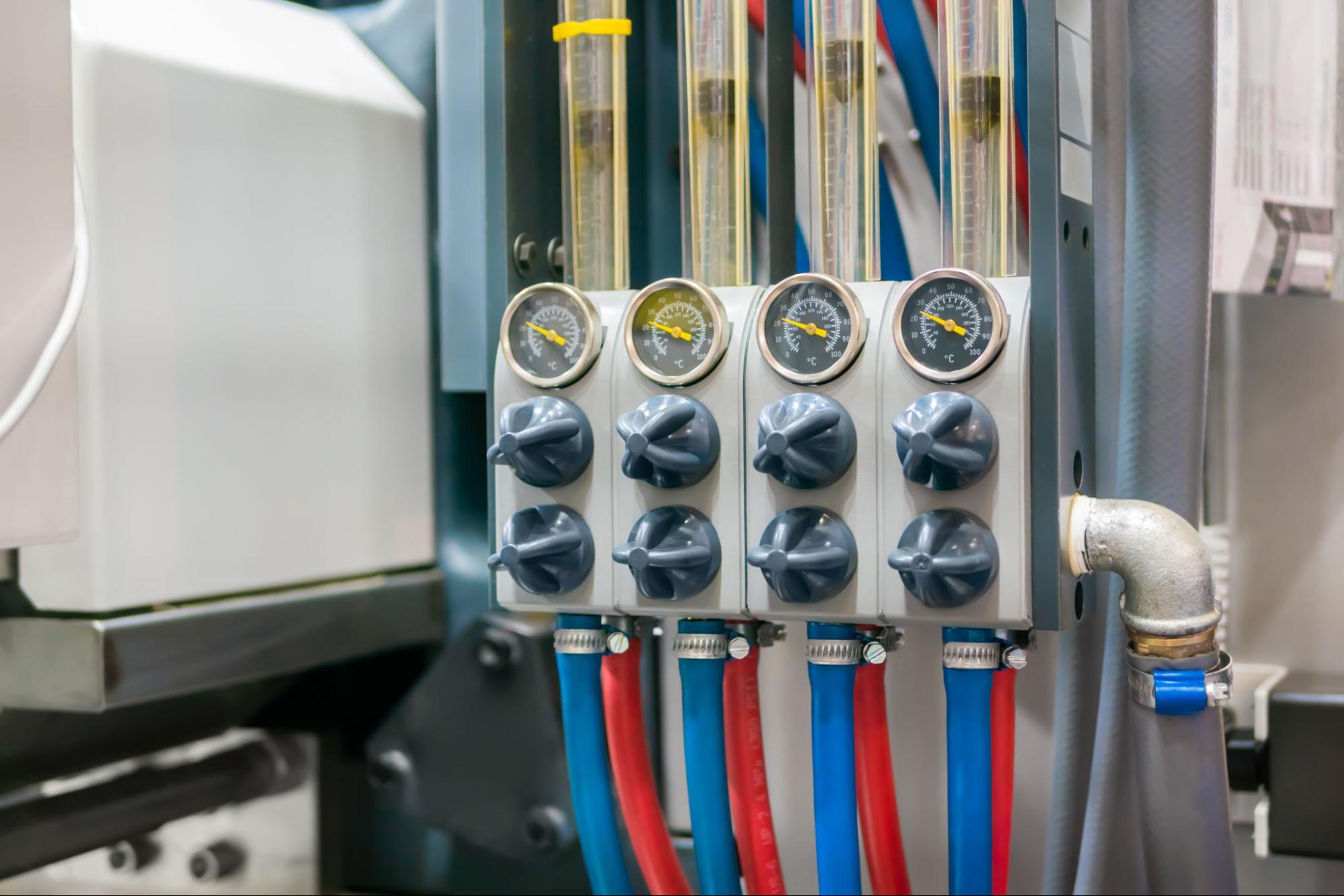

Cooling Time
Cooling accounts for 60–70% of the injection molding cycle, so it significantly influences efficiency. Shorter times improve productivity but can cause warpage or dimensional instability, parts shrinking unevenly, or drifting out of tolerance as they cool. Conformal cooling and optimized channel design can shorten cycles without sacrificing quality. Uneven cooling remains one of the biggest drivers of warpage.

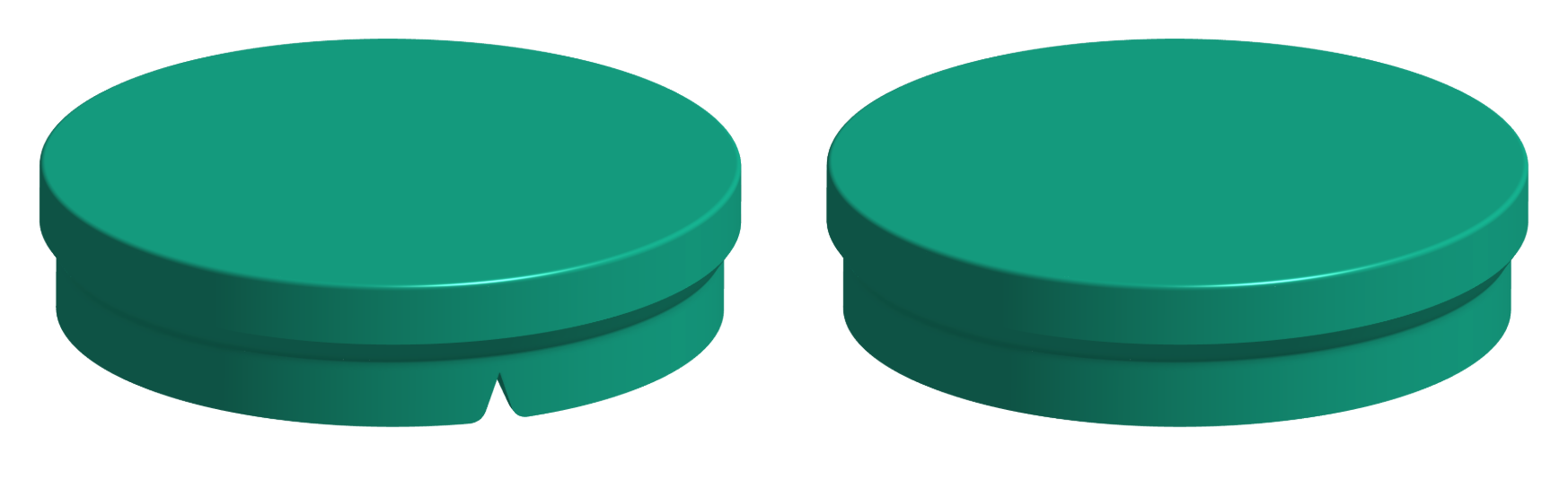

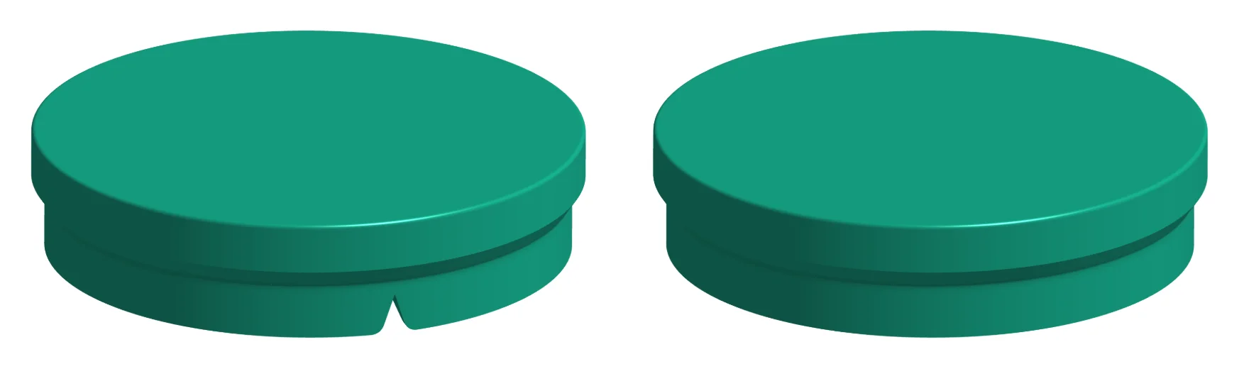

Clamp Force
Clamp force keeps the mold shut against injection pressure. Too little allows flash; too much strains the clamping system, particularly the tie bars, toggle, and hydraulic components, accelerating wear from repeated overloading. The optimal force balances projected part area with injection pressure, minimizing both defects and equipment stress.

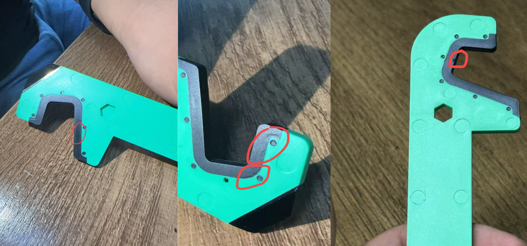

Example of a short shot in an injection-molded part
Example of a short shot in an injection molded part

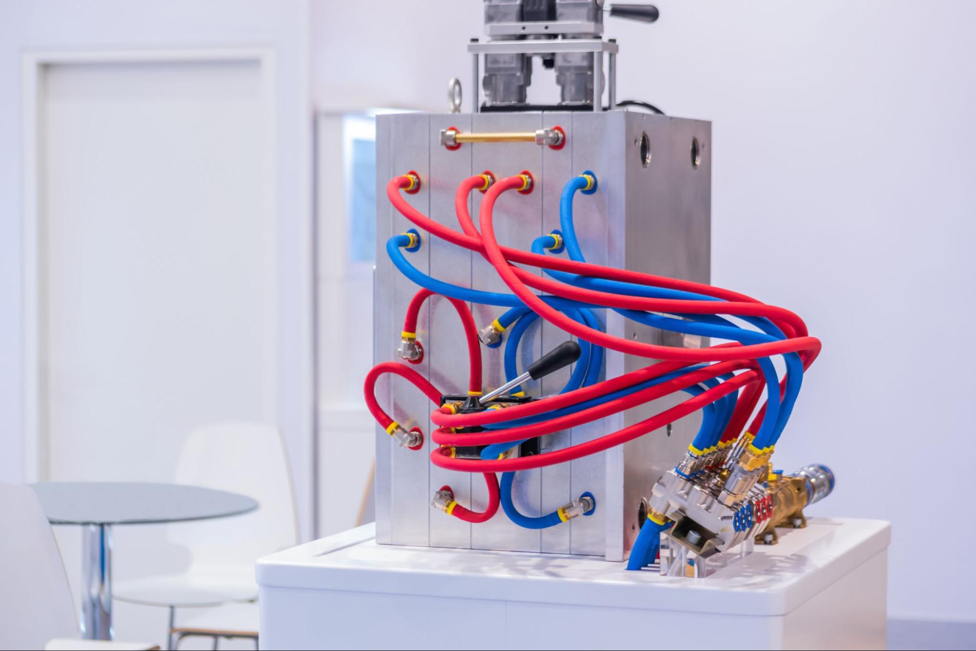

Warpage, Shrinkage, and Sink Marks
Warpage, shrinkage, and sink marks stem from uneven cooling or insufficient packing. These defects can be minimized by maintaining uniform mold temperature and using well-designed cooling channels that distribute heat evenly.

Sink marksInadequate packing or insufficient cooling rateHolding pressure, cooling timeIncrease holding pressure; lengthen cooling cycle to allow full solidificationMinimizes surface depressions and improves uniformity
FlashExcessive injection pressure or weak clampingInjection pressure, clamping forceReduce injection pressure; increase clamp forceEliminates excess material along parting lines
Short shotsInsufficient fill pressure/speed, premature freezeInjection pressure, speed, melt temperatureRaise injection pressure/speed; increase melt temperatureEnsures complete cavity fill

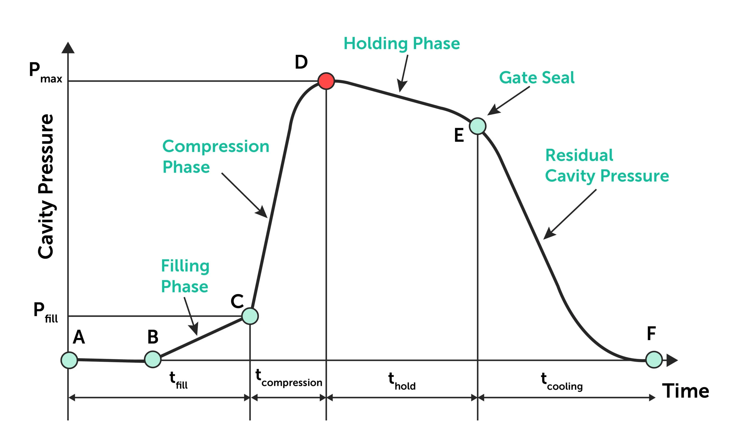

Pressure Optimization
The different stages of injection and holding pressure can be visualized in Figure 2, which maps how pressure rises during filling, peaks in the holding phase, and then drops off after gate seal into residual cavity pressure.
idealized chart of mold pressure over the course of an injection cycle
Chart of cavity pressure throughout an injection molding cycle
A Scientific Molding Approach Improves Repeatability
A scientific molding approach moves parameter setting from guesswork to data-driven control, helping engineers achieve consistent, repeatable results. A data-driven approach to setting injection molding process variables makes use of pressure curves, cavity sensors, and DOE (design of experiment) methods. The benefits of using a scientific approach include better repeatability, reduced scrap, faster setup, and the potential for predictive defect prevention.
For example, overlaying injection pressure curves can reveal cavity imbalance, where one cavity consistently fills or packs differently. This allows engineers to correct the issue through process or tool adjustments before it causes defects.

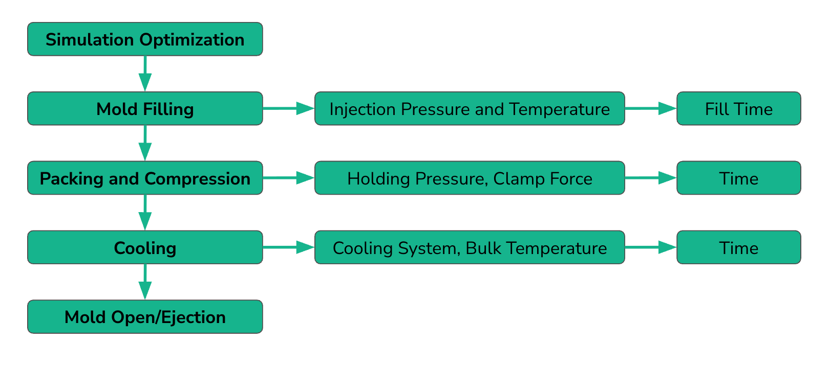

A Systematic Flowchart for Parameter Tuning

Gauges for controlling injection molding parameters
