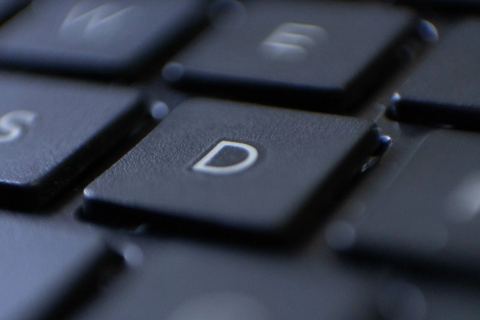

If you’re wondering why mold finish deserves its own “language,” consider how injection molded parts are made and the diverse requirements that they need to meet. Most injection molds are machined from aluminum or steel. The end mills that are used leave behind tool marks, surface imperfections that can be transferred from the mold cavity to the molded part. Improving the cavity finish improves part finish and helps to meet application-specific requirements for visual appeal and functionality.
In general, the type of product that you’re designing determines your choices for a mold finish. For example, optical lenses need a highly-polished finish that is free from defects (such as scratches) that could interfere with their use. Keyboard keys don’t need this same finish, and neither do shop vacs or steering wheels. For products that make contact with fingertips or that are designed to be handheld, there are advantages to a dull finish that hides fingerprints or a textured finish that won’t slip.

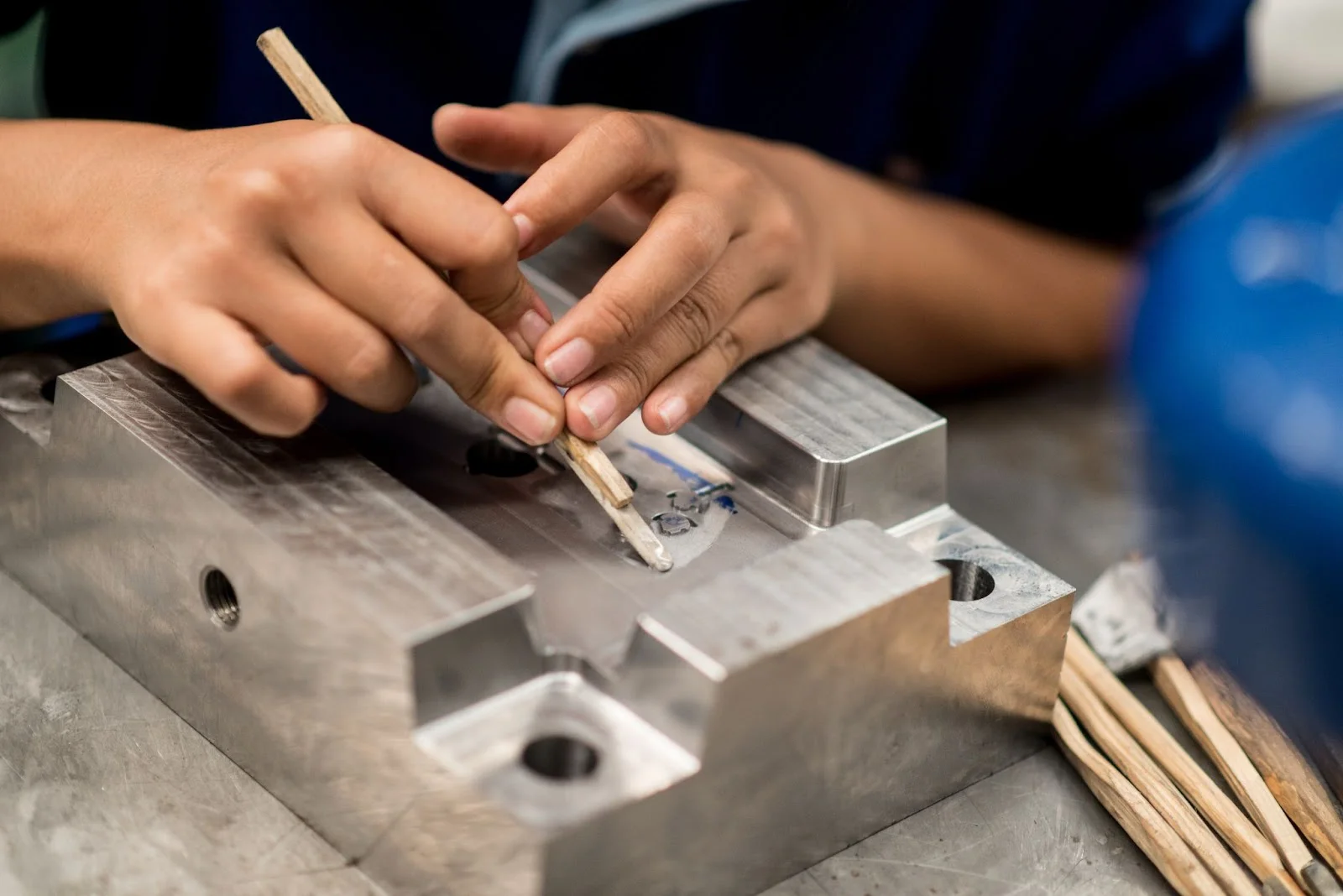

For injection molds that do not need one of these surface finishes, the SPI standard specifies an as-machined finish with a typical surface roughness of 3.20 RA and visible machining marks.
![injection mold polishing](https://www.fictiv.com/wp-content/uploads/2022/11/injection_mold_polishing.jpeg)

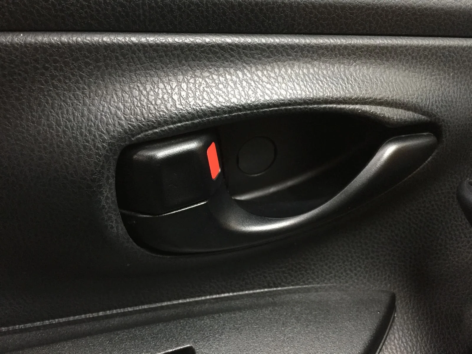

Textured Finishes
SPI textured finishes are used with products such as shop vacs and steering wheels that are meant to be gripped and held in the hand. Although SPI-D1, SPI D-2, and SPI D-3 surface finishes provide excellent results with some commonly used plastics, designers should avoid selecting polycarbonate as the injection molding material if the mold finish is SPI D-2 or SPI D-3.
