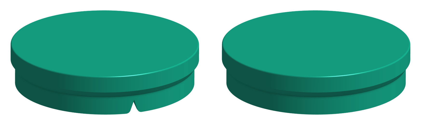

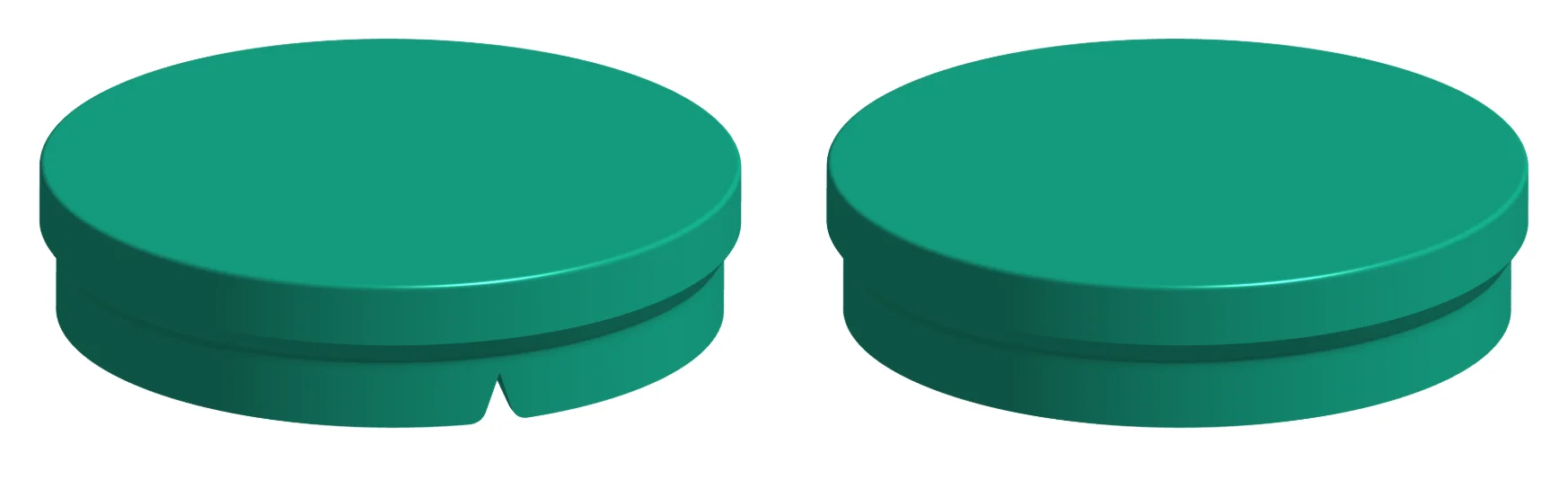

A short shot is an injection molding defect that occurs during the molding process when there is insufficient flow of molten plastic material. This causes the mold cavity to be incompletely filled and prevents the component from being fully formed. Simply put, gaps result, often in the form of missing features or incomplete areas of a product.
Any type of thermoset or thermoplastic material can be prone to this defect, which is relatively easy to identify. Short shots are not subtle; they often leave visible scarring or gaps that render the component useless. This defect typically appears as thin edges or missing plastic at corners. They can often occur at the furthest point from the injection point (gate), or near weld lines where plastic material meets in the mold.
Visual of a short shot part (left) vs. a fully formed part (right).

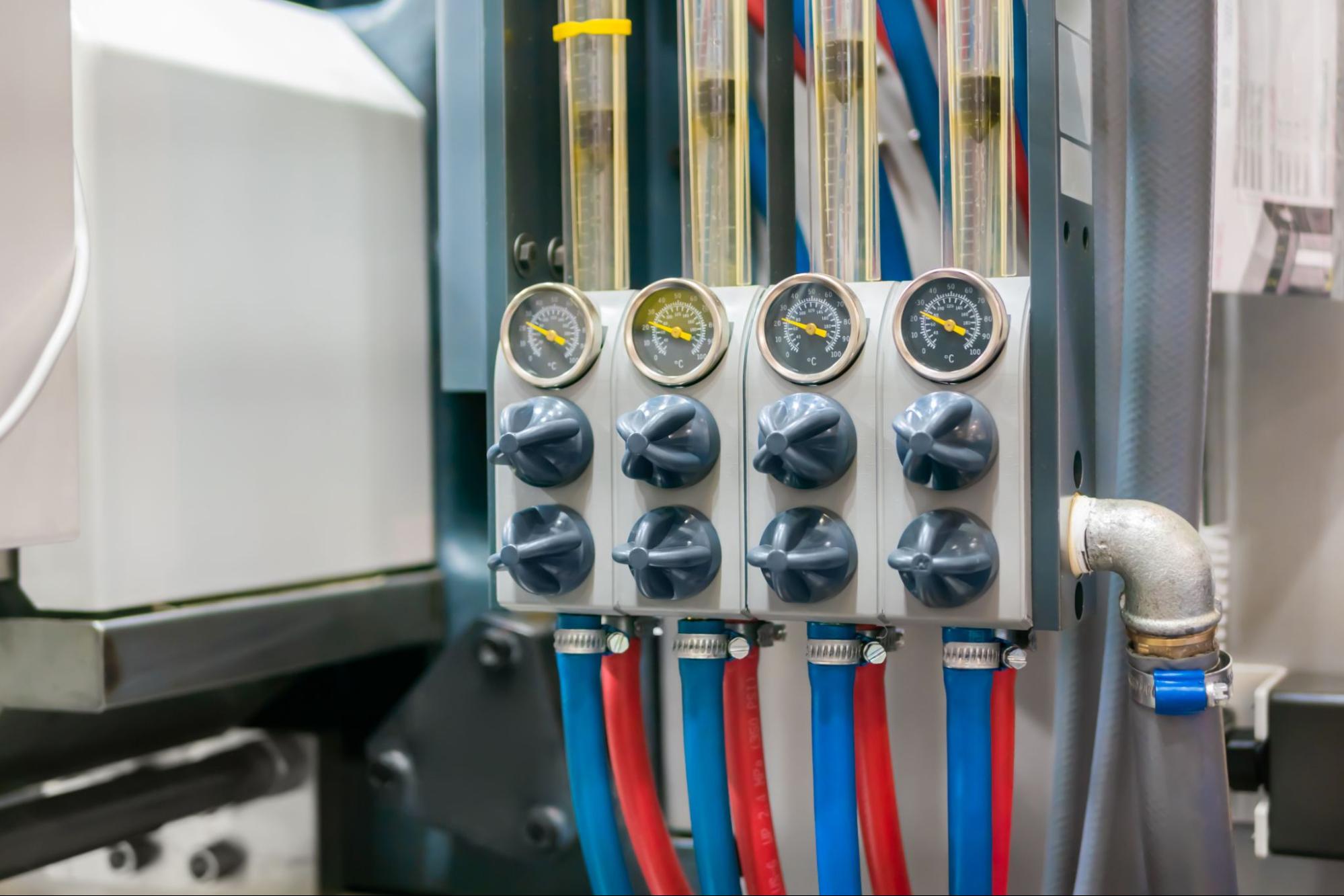

Injection molding water flow meter.

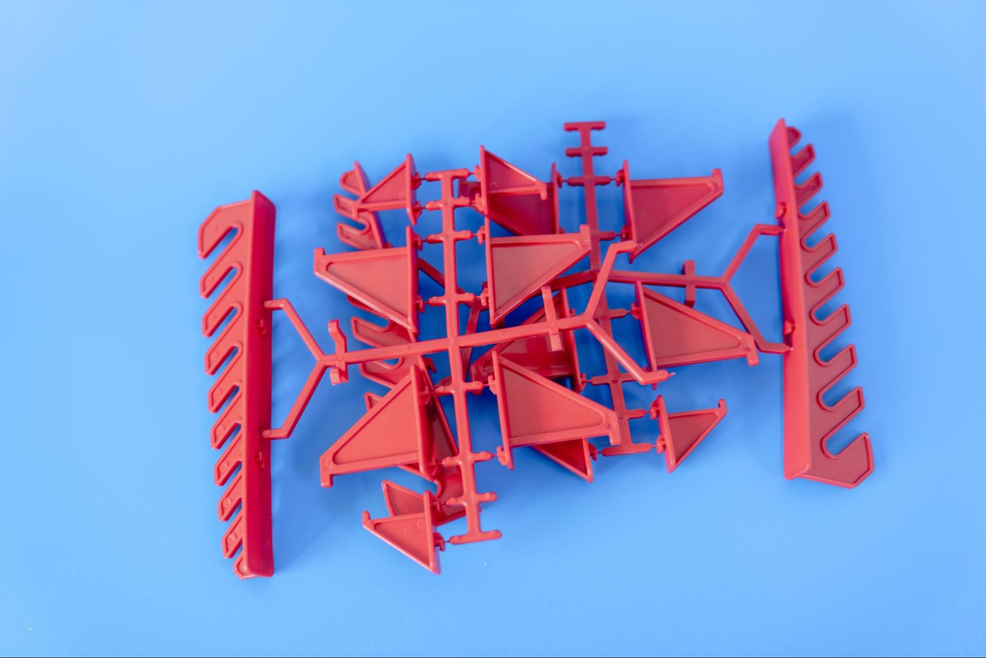

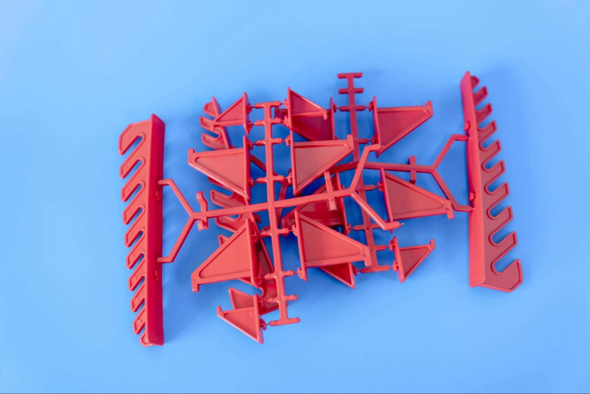

Injection-molded parts with runners attached.
