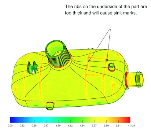

Most sink marks occur where ribs or bosses intersect with the nominal wall. By following Fictiv’s design for manufacturability (DFM) guidelines, however, you can minimize sink marks.

For DFM assistance, use Fictiv’s injection molding DFM tools to analyze your part design and check for wall thickness and potential sink marks — an example of the type of DFM feedback you can expect is below.

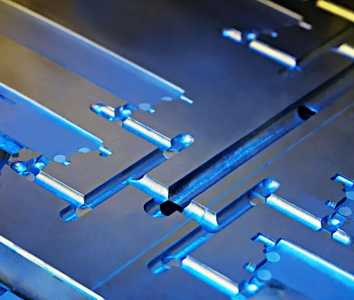

Cooling
Cooling lines, or cooling channels, support the uniform cooling of injection molds and the production of plastic parts that are free from defects. Whether achieved through air or water cooling, or with straight-line or conformal cooling, best practice is to make cooling as uniform as possible to avoid disparities in plastic shrinkage rates.
Sometimes, however, mold features like side actions and protruding steel make it difficult to add cooling lines everywhere you need them. These mold features also tend to become quite hot. By using metals with high thermal conductivity, such as beryllium copper, it’s easier to maintain even cooling across the mold.
