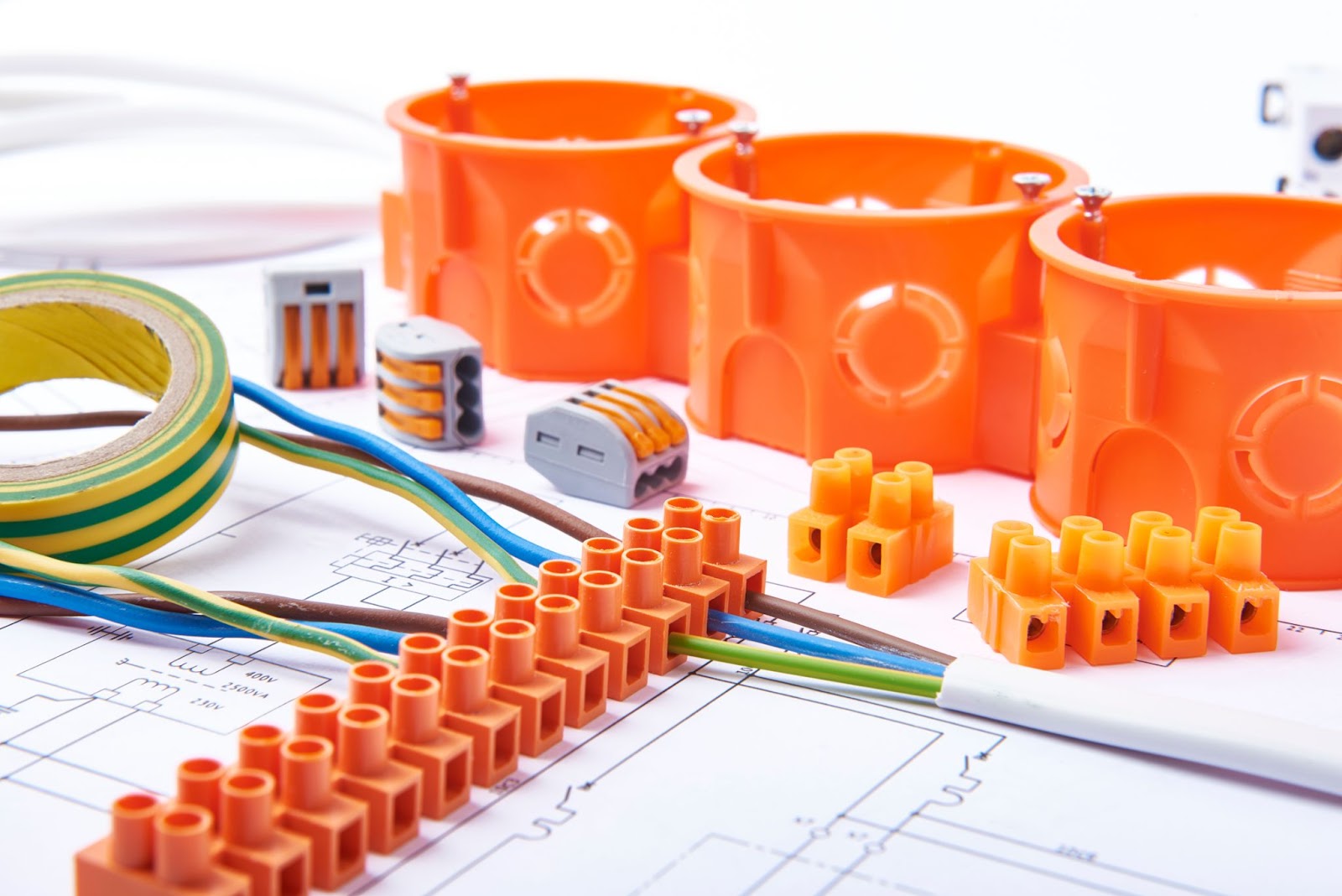

plastic injection molded resins
2. Plastic Injection Molding Materials
Does your part design use too much plastic? You can reduce material usage by replacing a thicker wall with a thinner wall that uses ribs for support or uses bosses for fasteners. Walls that are too thick (or too thin) also have longer cycle times for higher production costs. Walls need enough thickness to meet functional requirements, however, so cost isn’t the only consideration.
When it comes to materials, there are other cost-saving decisions you can make. For example, based on your application requirements, do you need a commodity plastic or a specialty plastic? Does the material require the added expense of drying, or is there an additional cost associated with an additive? Can you use regrind instead of virgin plastic?
Commodity plastics are less expensive and available in hundreds of different resins, each with specific end-use properties. There are also different grades of the same plastic material, including resin types with fillers such as glass or fiberglass. Just note that commodity plastics aren’t the right choice for tough applications, and an inexpensive polymer might not support the tolerances you need. Along with polymer price, you should consider the processing requirements because longer cycle times carry higher costs.
Specialty plastics cost more than commodity plastics, but have material and performance properties suited for more demanding requirements. Typically, these engineering plastics and resins are used in medical, automotive, and electronics applications. Sometimes, especially tough requirements demand the use of polymer blends instead. Before choosing one of these more expensive plastics, make sure there isn’t a less expensive material that can meet your need — and Fictiv can help you find them.
Try our new materials AI generator to discover the most cost-effective materials for your application.

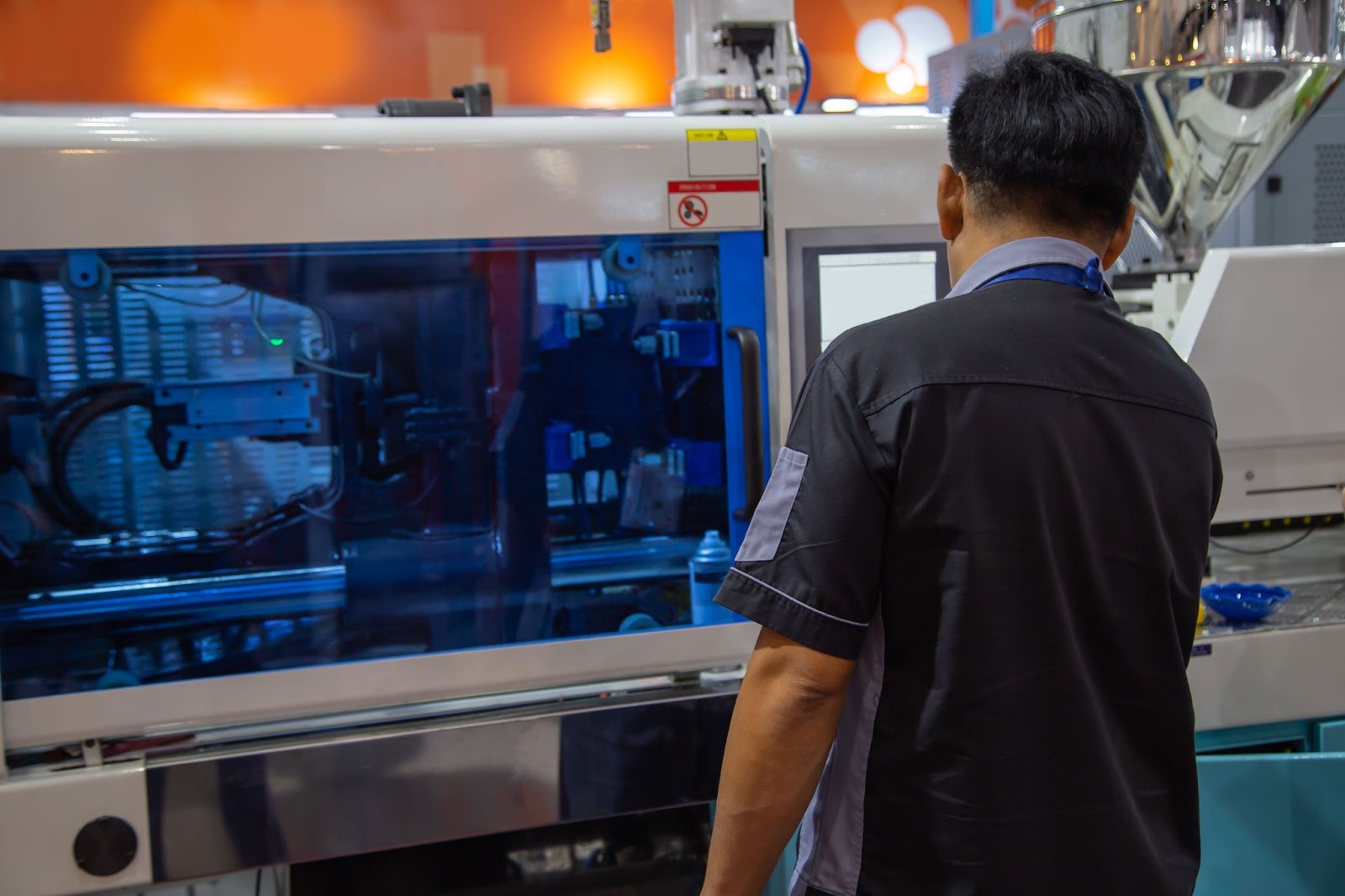

injection molding production costs
4. Injection Molding Post-Processing
Additional processes after molding increase production time and cost. Effective part design, DFM, and tooling design can help minimize unwanted defects and reduce the need for rework and other secondary processes.
For example, during plastic injection molding, a molder needs to use the proper clamping pressure to hold the mold closed. If this pressure isn’t high enough, the mold may open prematurely. This can cause flashing on the surface of the part, a defect that may require post-processing for removal.
Expert DFM also considers ways to minimize secondary processes, such as custom inserts and painting. By changing a part design or selecting a different material, you may be able to achieve your design goals while avoiding additional setup fees. Also, mechanisms such as living hinges produced during injection molding can eliminate the need for unnecessary assembly and other costly operations.

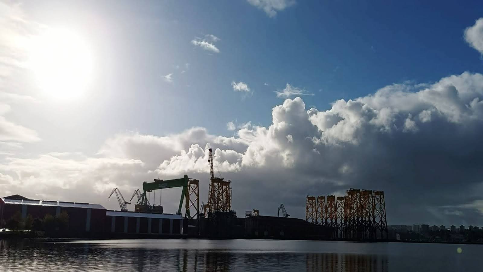

nearshoring injection molding
5. Nearshoring Production
Global supply chains often face risks, including shipping delays, raw material shortages, and geopolitical tensions. Nearshoring mitigates these risks by using regional suppliers and logistics networks. This strategy may involve shipping your tools from overseas to a closer location, or choosing a nearby supplier from the start for your manufacturing and/or assembly needs.
Nearshoring can help address common issues in sourcing for injection molding, such as longer lead times, increased shipping costs, and tariffs. By relocating your tooling and other processes closer to home, you can eliminate hidden costs associated with offshoring, while also enhancing supplier communication, quality, and overall supply chain resilience.
While nearshoring may involve higher labor costs or upfront investments, its long-term benefits often outweigh these cost factors. Fictiv can simplify your nearshoring process, helping you save money while increasing supply chain efficiency.
Is your business facing supply chain disruptions and increased costs due to unpredictable logistics? Watch our on-demand webinar to learn how nearshoring can help.
