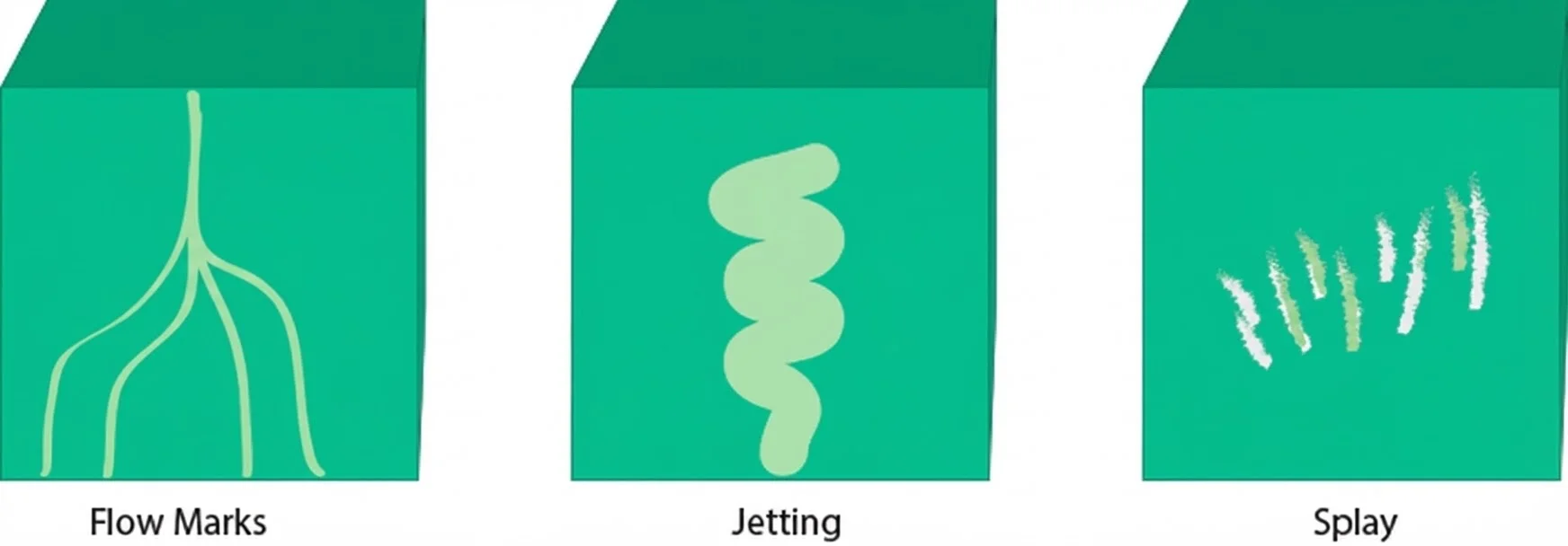

Jetting vs. Flow Lines vs. Hesitation Marks vs. Splay
It is easy to confuse jetting with some other common defects. The descriptions below should help with distinguishing among them:
  • Flow Lines: Usually ripples or waves on the part surface caused by the cooling of the “flow front” as it moves across the surface.
  • Hesitation Marks: These occur when the flow slows in a thin section, then speeds up again, leaving visible lines.
  • Jetting: Jetting defects look like “snakes” or “worms” frozen on the part surface.
  • Splay (Silver Streaks): Look like fan-shaped silver marks. Splay is caused by moisture or gas in the resin, not flow physics.
Attempting to fix jetting by drying the material (a fix for splay) will waste production time. Similarly, increasing injection speed might fix flow lines, but will almost certainly worsen an injection molding jetting defect. Similarly, modifying mold geometry to counteract hesitation marks may eliminate hesitation marks, but then introduce flow lines. It’s important to balance product and mold design with processing parameters to achieve acceptable parts.

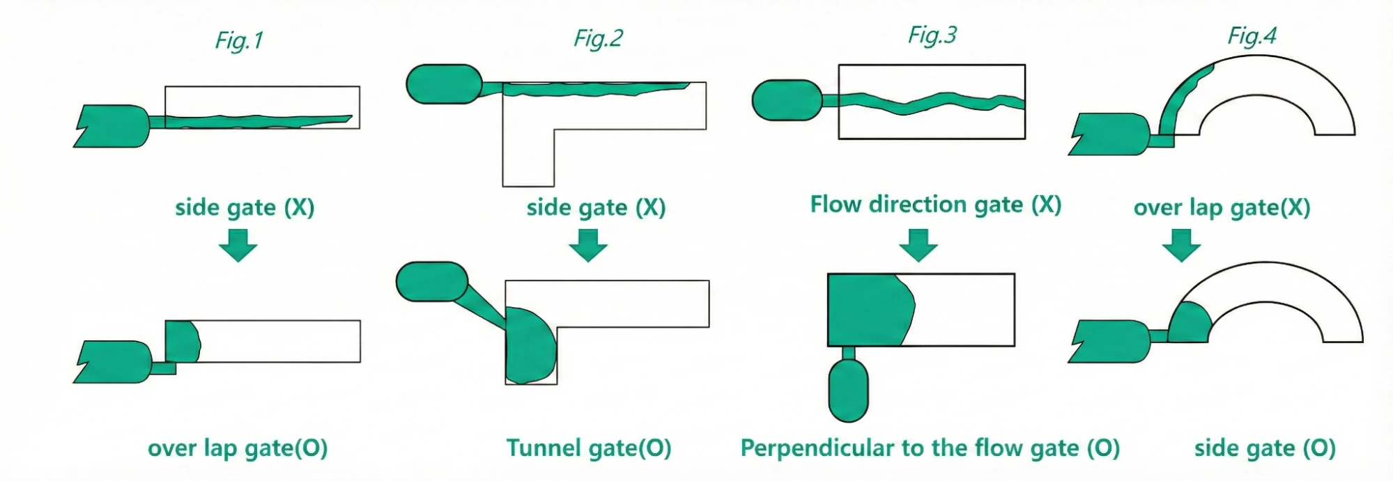

  • Direct Gate Onto a Cavity Wall: This is the most effective fix. When the gate is aimed at a wall or pin, the plastic hits the surface, slows, and begins to fill the cavity uniformly.
  • Use a Fan or Tab Gate: A tab gate creates a small “sacrificial” area where any jetting that occurs will not be part of the final part. By the time the plastic enters the actual part, the flow has stabilized.
  • Increase Gate Size: Reducing the “nozzle effect” by enlarging the gate cross-section lowers the melt velocity.

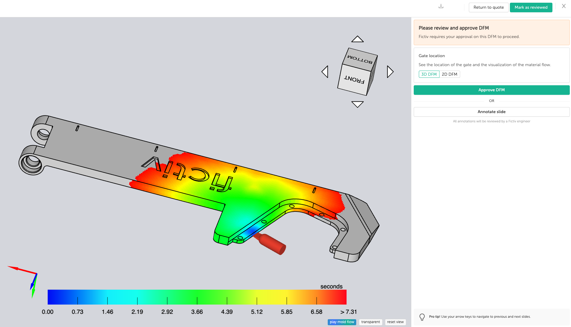

Mold flow analysis can help predict and prevent jetting and other defects by simulating the flow of molten plastic. Learn more about Fictiv’s mold flow offerings.

  • Gate Placement Rules: Always try to interrupt the flow immediately after the material enters the mold. If the gate must be on a flat surface, consider a sub-gate that enters at an angle to hit the bottom of the cavity.
  • Gate Design Rules: For parts with demanding cosmetic requirements, tab gates are the industry standard for preventing jetting. They move the turbulence zone outside of the finished part.
  • Mold-Flow Simulation: Use simulation software early in the design process. Modern AI-driven simulations can predict the exact velocity at the gate and determine if jetting is likely before mold fabrication.
