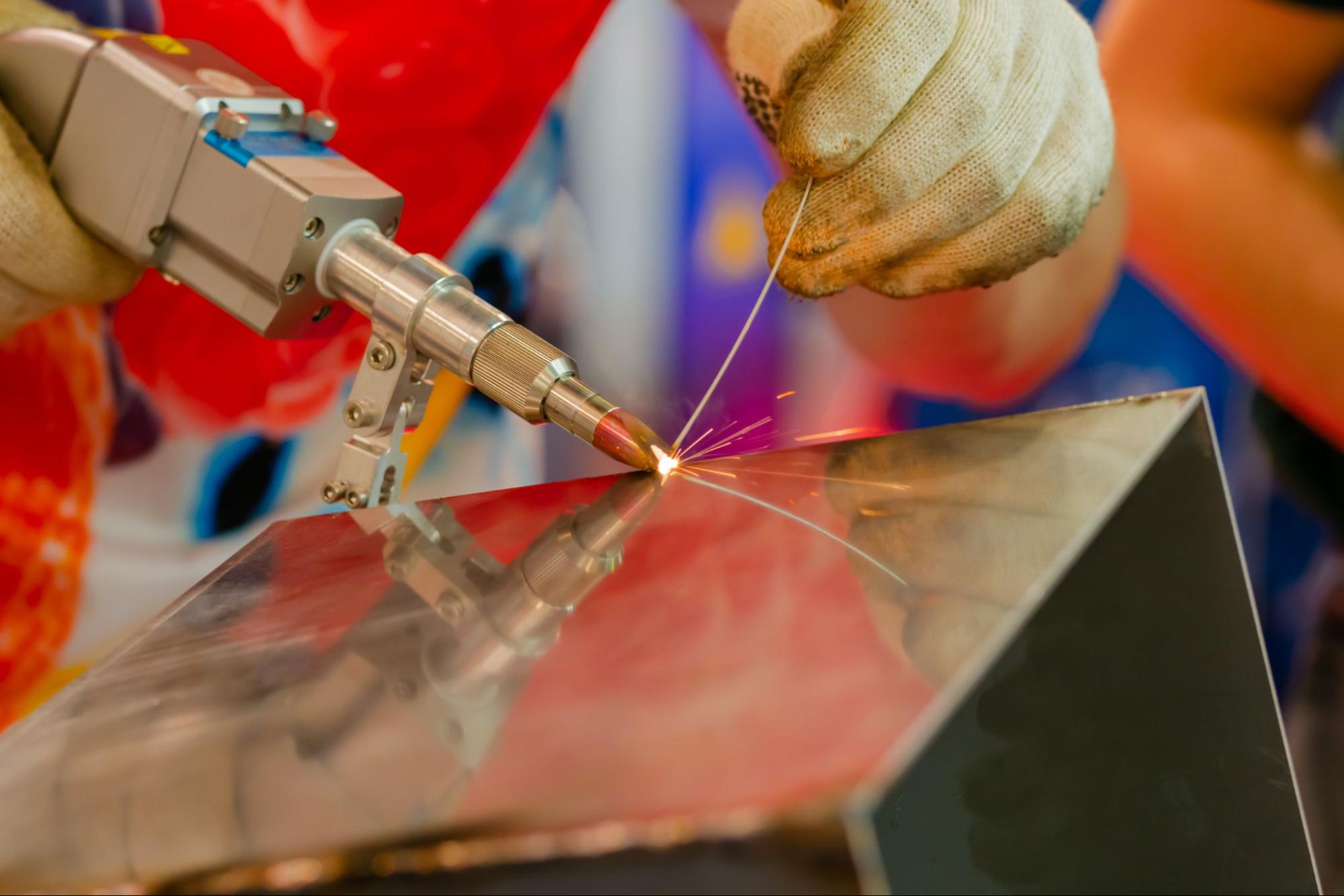

A worker laser welding the corner of a sheet metal box.

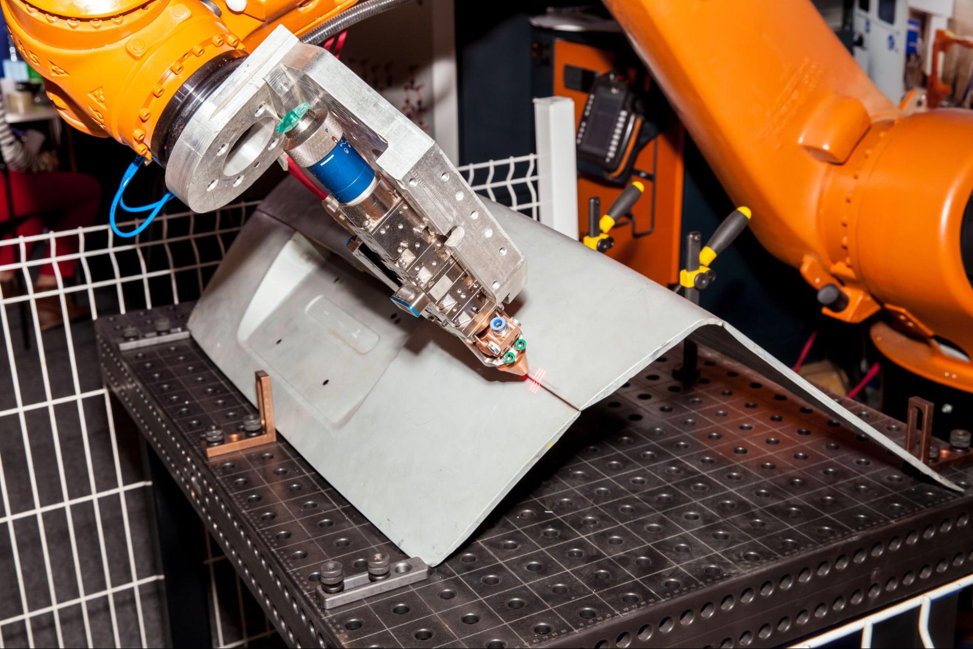

A robotic arm performing laser spot welding

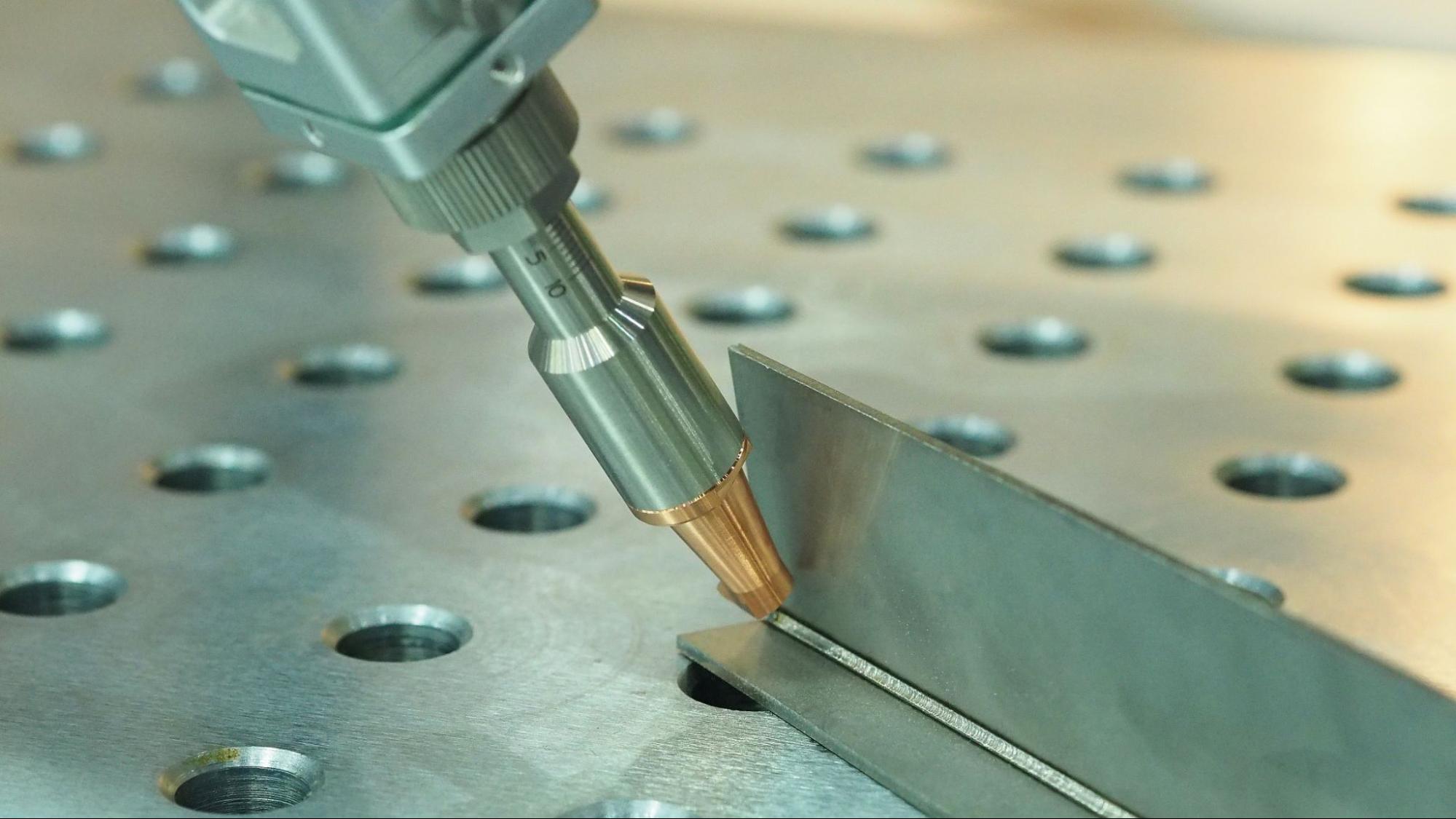

laser welding
laser welding
