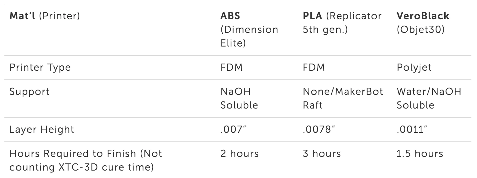

Results and Closing Thoughts
Differences in Process
ABS (Dimension Elite)
VeroBlack (Objet30)
PLA (Replicator 5th gen.)
Differences in Time
Differences in Cost and Materials

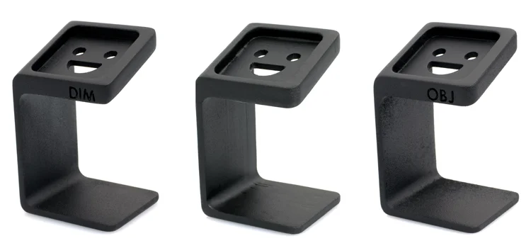

Comparison of the Final Results

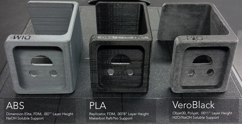

Knowing how to finish 3D prints is a useful skill if you’re 3D printing parts or having 3D printed parts manufactured. This article details the different 3D printing finishing methods for FDM and PolyJet 3D printed parts, plus techniques and tips to elevate the look and feel of your prototypes.

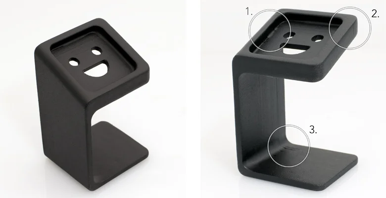

Let’s start with a simple Apple Watch stand design as a case study. This stand has pockets and internal and external features that need to be finished to a standard that complements the shiny exterior of an Apple Watch. Usually, parts need extra work to get to the desired surface finish, and learning how to create such a finish is a key skill that can save you money on post processing in the long run.
![watch stand design](https://www.fictiv.com/wp-content/uploads/2017/01/finishing-3d-parts-1.jpg)
3D printing post processing is ultimately dependent on the type of material your 3D printed part is made from. For the purposes of this analysis, we’re going to compare three base materials:
- PLA: PLA is the optimal material choice for tight budgets; the results aren’t as polished but the price is cheapest.
- ABS: For moderate budgets, ABS is a great choice. It’s not as cost-effective as PLA but it provides more reliability than PLA.
- VeroBlack or VeroWhite: VeroBlack and VeroWhite create the highest quality parts, with the best dimensional accuracy and the most polished finish.
![watch stand design](https://www.fictiv.com/wp-content/uploads/2017/01/finishing-3d-printed-parts-2.jpg)
Overview of Post-Processing
Every print presents unique challenges and considerations that must be accounted for in order to arrive at the best finish possible. The post-processing for our watch stand involves a combination of repairing and preparing the print for sanding and painting, and the finished sample of all three materials should have smooth, matte black surfaces.
Note: We have detailed the print settings process for each material separately below and included a summation of the results in the conclusion of this article.

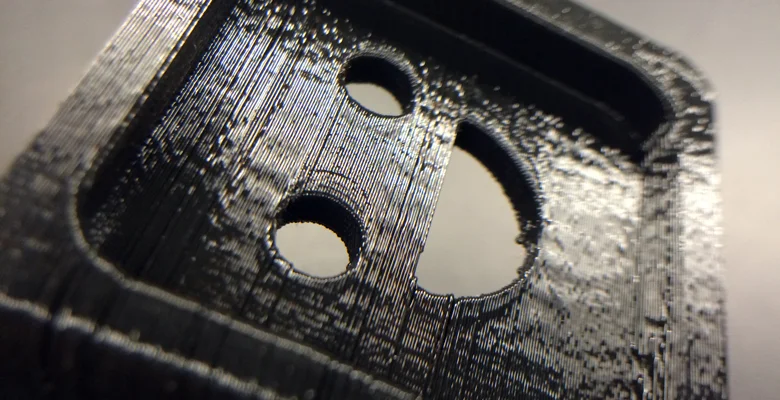

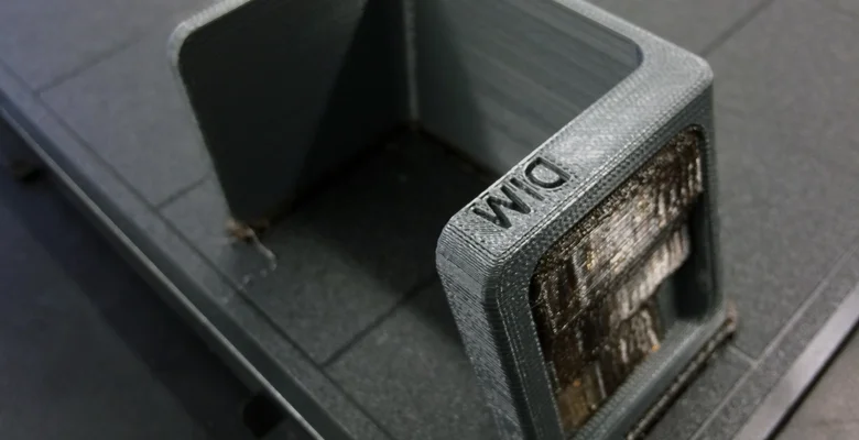

ABS (Printed on a Dimension Elite)
The Dimension Elite prints are smooth, clean, and ready to sand out of a post-printing NaOH bath.
![ABs 3d printed part](https://www.fictiv.com/wp-content/uploads/2017/01/finishing-3d-printed-parts-4.jpg)
There are, however, clear stepping lines between the printed object layer lines. If we don’t remove those lines, they’ll show up in the final coat of paint and ruin our smooth finish. Thankfully, removing these lines is easy thanks to ABS’s high melting point and sandability.

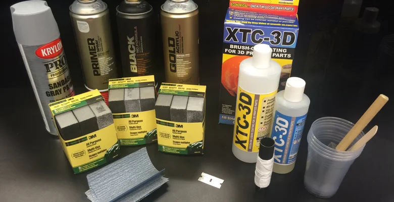

ABS 3D Printed Part Finishing Process Materials Needed
![finishing materials](https://www.fictiv.com/wp-content/uploads/2017/01/finishing-3d-printed-parts-5.jpg)
The materials needed for finishing 3D printed parts:
- Sandpaper (grits 100 to 600)
- Medium, fine, and extra-fine sanding sponges
- XTC-3D brush-on coating (As an alternative, Bondo putty is a common solution to fill holes in parts. We chose XTC-3D for its viscosity, sandability, and ability to penetrate small perforations, which makes it desirable over Bondo putty)
- Razor blade
- Foam brush, mixing cups and popsicle sticks
- Sandable Krylon Primer
- Montana Acrylic Primer in Shock Black
- Matte Acrylic Varnish

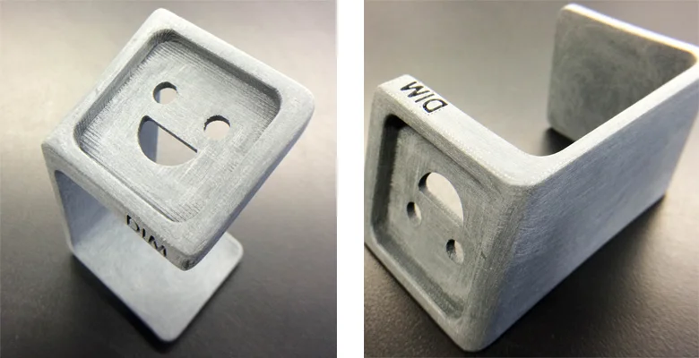

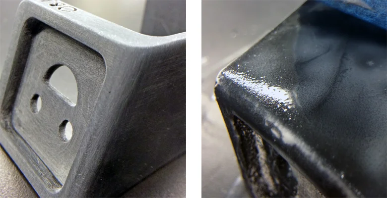

ABS 3D Printed Part Sanding
Learning how to smooth 3D prints with sandpaper is not as intimidating as it may seem, and sanding our ABS print is simple and straightforward. First, start with 100 – 200 grit sandpaper to remove stepping lines and then gradually increase up to 600 fine grit sandpaper to achieve a smooth finish and remove all sanding lines.
Pro Tip: Sand in small circular movements evenly across the surface of the part, and avoid sanding 3D prints in one direction only, especially in the direction of the stepping lines to prevent striations or “trenches” in the print.
Beware that sanding ABS removes material quickly, so be careful not to overdo it — as little as .010” can be enough to completely remove any stepping layers and oversanding can compromise critical dimensions.

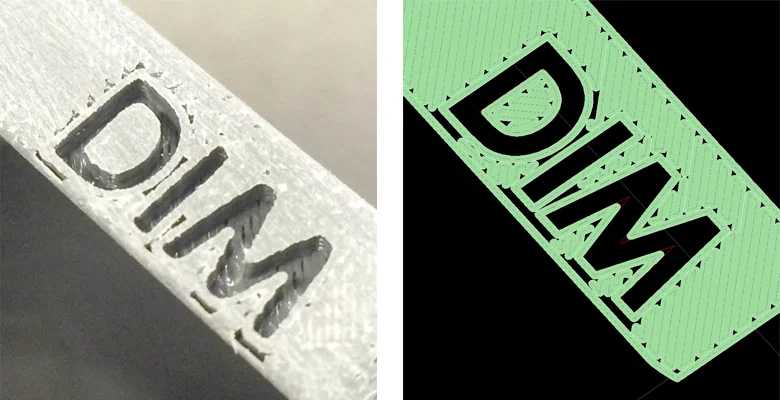

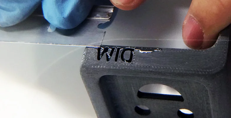

After sanding, there are some holes on our part left by an incomplete layer around the letters DIM. These holes can perforate through the finished paint coat and create sinkholes, so we need to find a solution.
![CAD model](https://www.fictiv.com/wp-content/uploads/2017/01/finishing-3d-printed-parts-6.jpg)
As you can see in the Catalyst tray to the right, there are large holes between the DIM and the edge of the part. Moving the DIM up in our Solidworks model would solve this issue, but we’ll have to find a way to fill these holes with a sandable 3D print filler.

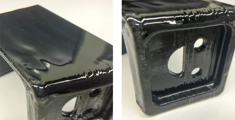

Repairing the Incomplete Layer

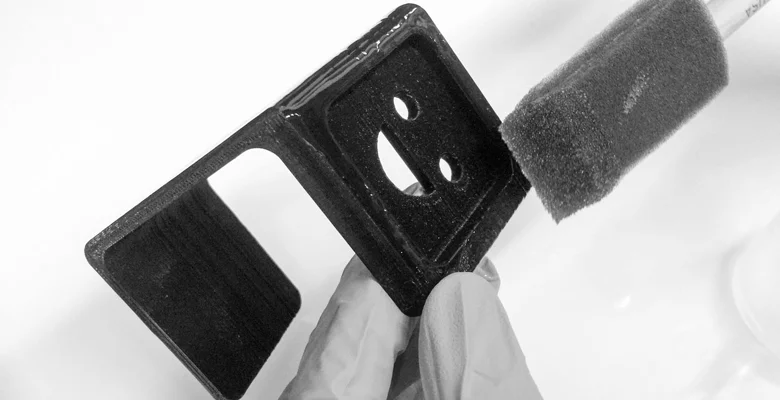

We’re going to use a thin, sandable epoxy called XTC-3D to fill in the print. XTC-3D is cost-effective, quick, thin, and high-performing. Note that a small amount goes a long way, and you should always follow the manufacturer’s recommended pot life.
Pro-Tip: Maintain a weight ratio of 100 Part A to 42 Part B and mix thoroughly for one minute and coat your part within the pot life. For more details, check Smooth-On’s technical bulletin here, and there’s a great instructional example here.
Before applying the XTC-3D, wash the part with soap and dry with compressed air to ensure your part is thoroughly clean and free of any oils and sanding dust — and wear gloves so you don’t get any hand oils or sweat on your part.
![glueing 3d printed part](https://www.fictiv.com/wp-content/uploads/2017/01/finishing-3d-printed-parts-8.jpg)
Fill in holes or gaps in your print with a very thin (1/64”) coat — a thin layer of XTC-3D will level itself out. We used a razor blade to scrape excess XTC-3D into the unwanted holes and gaps, making sure to avoid any areas we didn’t want filled (like the letters DIM).

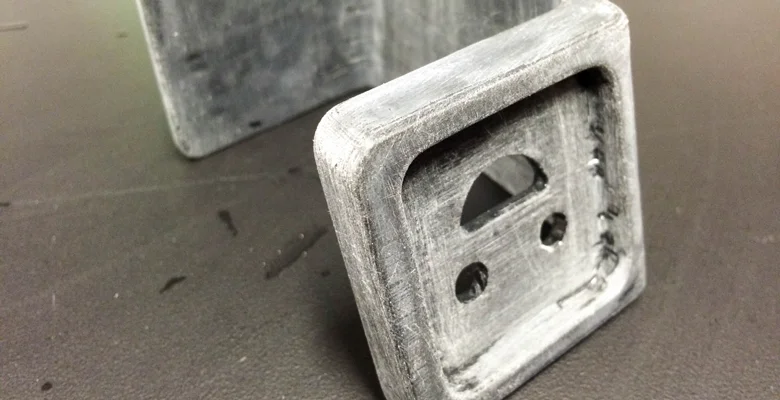

Allow the XTC-3D sufficient time to become tack-free dry by following the manufacturer’s recommended cure time. Then sand away at the excess XTC-3D layer with 300 to 600 fine grit sandpaper to finish the repaired uniform surface.
![sanded 3d printed parts](https://www.fictiv.com/wp-content/uploads/2017/01/finishing-3d-printed-parts-9.jpg)
After another thorough cleaning of the print, we’re ready to prepare our uniform surfaces for painting.

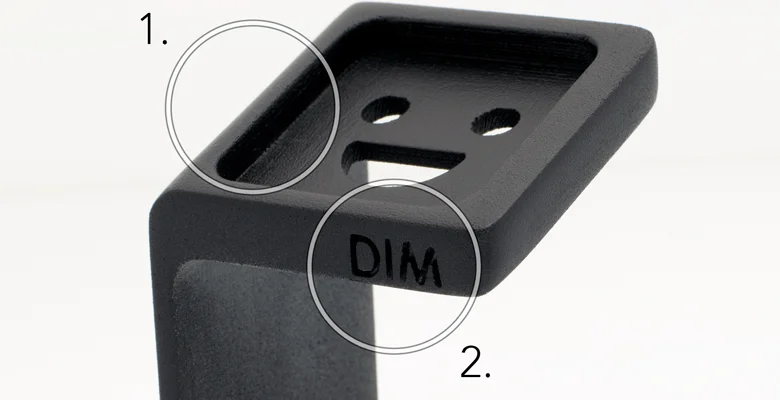

As you can see in the image above, our finished ABS part is matte black and smooth to the touch, with little evidence of layering on most surfaces. Also, there are a few important elements to note specifically:
- Sharp internal pockets are tough to sand. After 30 minutes of sanding, we still couldn’t remove all the layering and the stepping even after priming, painting, and varnishing.
- Because we had to remove more surface material during sanding, we had to sacrifice some dimensional accuracy in the final geometry of the part.
- Filling the incomplete layer with a thin coat of XTC-3D worked well — the holes disappeared in the final paint layer.

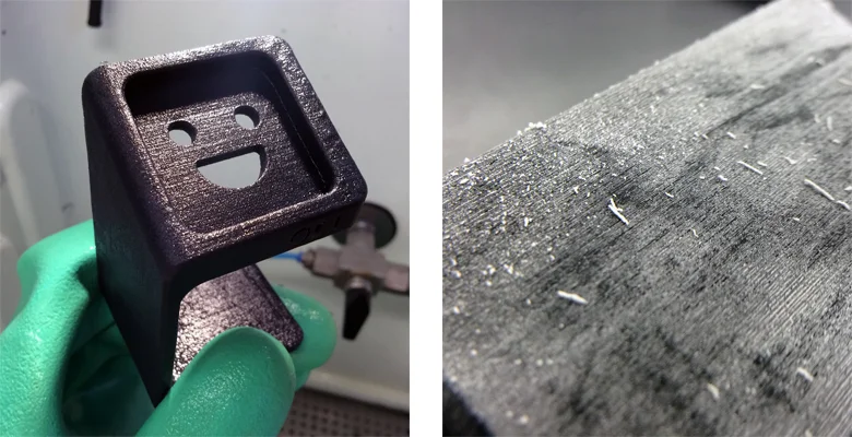

VeroBlack 3D Printed Part Sanding
Once the support structure has been removed, start with 100 grit sandpaper to wet sand the residue, then gradually move to wet sand with 300 grit sandpaper — the residue will fall off in small soft white chunks. This is the hardest part of the VeroBlack finishing process and it took about 40 minutes to remove the residual layer. If you rub the part with your fingernail before sanding, you’ll feel it’s harder and more plastic-like beneath the gummy residual coat.
![veroblack sanded 3d printed part](https://www.fictiv.com/wp-content/uploads/2017/01/finishing-3d-printed-parts-12.jpg)
After removing the residual layer, the surface of the part will begin to feel smooth, so continue wet sanding through to 600 fine grit sandpaper until the part is fully smooth.
Pro-Tip: Water breaks up the residue, so wet sanding is a highly effective method to get a smooth, residue-free, paintable, and homogenous surface.
After sanding, thoroughly clean your part with soap and water to remove any additional residue. Again, we recommend using compressed air to dry the part and clear any accumulated dust.
Note that VeroBlack is like ABS. Once you break through the residual layer, the actual VeroBlack material is easily removed, so be careful not to overdo it and compromise critical dimensions. Removing as little as .005” is usually enough to completely remove any stepping layers.

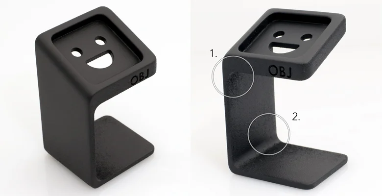

VeroBlack 3D Printed Part Final Results
![VeroBlack 3D Printed Part Final Results](https://www.fictiv.com/wp-content/uploads/2017/01/finishing-3d-printed-parts-13.jpg)
Our finished VeroBlack part is matte black and smooth to the touch, however, some of the internal corners weren’t sanded enough to remove the residue, so you can see how the paint powdered up in these areas (see item 1 in the image above). This will likely result in peeling paint over time. Also, some small stepping is visible on the part (see item 2 above), but another 30 minutes of thorough sanding would have eliminated both issues.

After finishing all three parts to a smooth, matte black finish, let’s take a look at the differences in process, time, materials and finish.
![3d printed parts - process, time, materials and finish](https://www.fictiv.com/wp-content/uploads/2017/01/finishing-3d-printed-parts-18.jpg)
![3d printed part specs](https://www.fictiv.com/wp-content/uploads/2017/01/finishing-3d-printed-parts-19_0.png)
- Sand from 100 to 600 grit
- Repair holes with XTC-3D (may not apply to your part)
- Sand away XTC-3D with 300 to 600 grit
- Prime, Paint, Varnish
VeroBlack (Objet30)
- Coat in 1 to 3 layers of XTC-3D (depending on how bad the striations on your print are)
- Sand away XTC-3D with 100 to 600 grit
Differences in Time
The part that took the longest to finish was PLA due to the XTC-3D coating application, but even without XTC-3D, PLA typically takes longer to sand than ABS or VeroBlack.
In our example, the VeroBlack was ultimately faster to finish since we repaired our ABS print with XTC-3D and stepping between layers was not as significant in the VeroBlack print.
All things considered, VeroBlack was the quickest to get to a smooth, matte black finish.
Pro-Tip: If you’re in a rush to get from printer to photoshoot, use the Dimension Elite or Objet30 printers. Especially in models with overhangs and significant amounts of support material, the Dimension Elite and Objet30 support material is quickly removable via dissolution, whereas the PLA supports on a Replicator print require a lot more time to remove.
PLA is the cheapest out of the three, at $20 per part, followed by ABS at $55, and VeroBlack at $110 — though that doesn’t account for the value of the time and effort required to get a finished part. In our opinion, VeroBlack is the best bang for your buck since it’s the easiest surface to finish and will give you the most accurate model.
The Final Results
At first glance, all three Apple Watch stands look similar, but there are a few key differences in the final finish.
Both the ABS and the PLA finished prints have evidence of stepping between layers that is visible in the final product. The VeroBlack print requires far less effort to remove these steps, and they ultimately are not as obvious in the final paint coat.
Although the ABS and the VeroBlack finished prints have similar surface finishes, more material (approximately .020”) was removed in the sanding process for the ABS to remove stepping between layers. In contrast, the VeroBlack print required less sanding, so the final dimensions are closer to the original design intent.
Here’s a summary of key points to understand about each print:
VeroBlack: High layer resolution (.0011”) means little sanding is required to get a smooth, paintable part. Critical dimensions don’t need to be compromised to get a smooth surface quality part and no repairs are needed for fine detailed features.
ABS: Parts are easy to sand, but small fine detailed features may require repairing and careful sanding to remove stepping between layers. Once this stepping is removed, painting is straightforward.PLA: The cheapest option, but also has the potential to be the most difficult to finish, depending on support structures and quality of the print. May require significant sanding and repairing via XTC-3D or Bondo filler.
