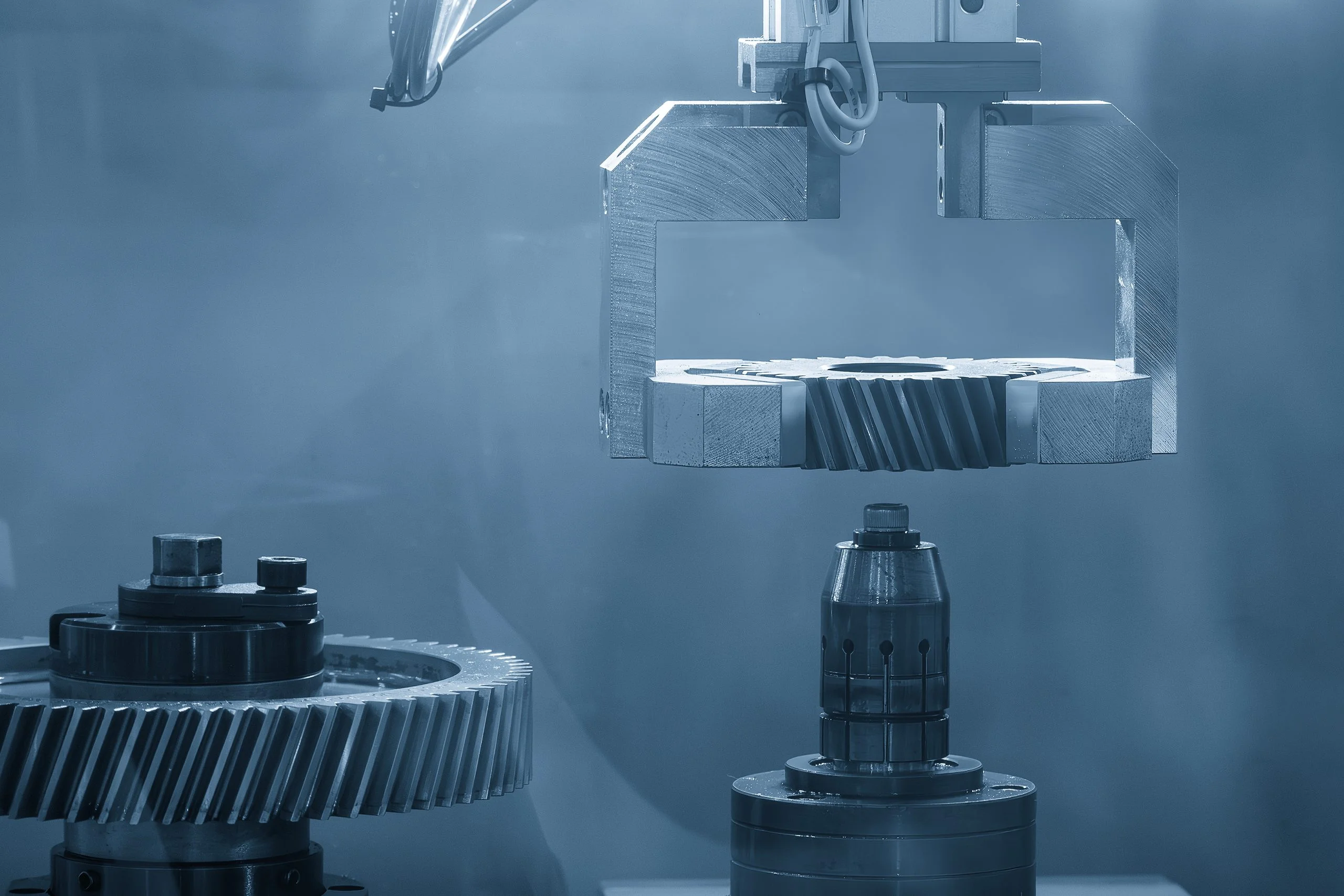

Grippers (Parallel Jaw, Three-Finger, Angular)
Off-the-shelf electric or pneumatic gripper bodies provide the internal actuation, but standard flat fingers can’t always hold real-world parts securely. Custom gripper fingers with contoured geometries, compliant pockets, or specific clearance angles are manufactured to match the workpiece’s CAD model. Custom fingers prevent part slippage during high-acceleration movement without requiring excessive clamping force that could damage delicate surfaces.
Common applications: Machine tending, part loading and unloading, part transfer, and assembly.

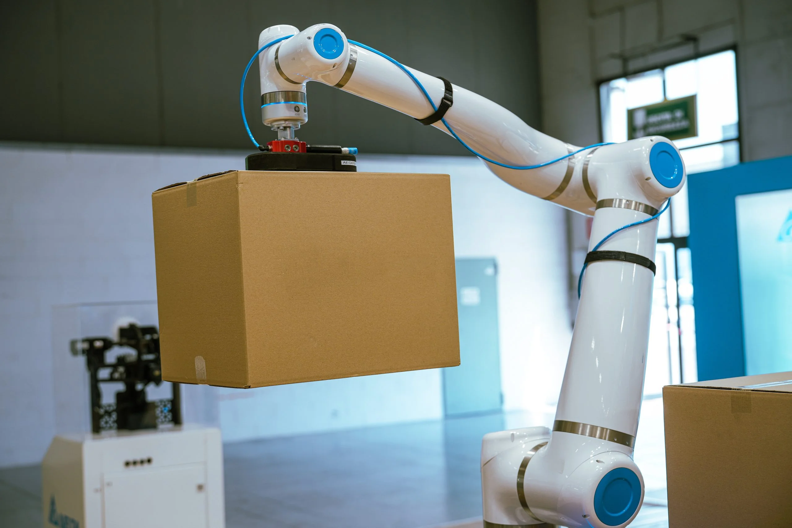

Vacuum Cup Assemblies
Vacuum end-of-arm tooling uses standard off-the-shelf suction cups and vacuum generators, but the underlying distribution manifold, mounting frame, and tubing architecture are frequently custom. Custom aluminum or 3D-printed vacuum frames position multiple cups precisely across irregular surface contours, ensuring balanced lifting points and preventing part deflection on thin sheet metal or molded components.
Common applications: Packaging, palletizing, sheet metal and panel handling, and pick-and-place on assembly lines.
Vacuum end effector assembly lifting a shipping box

Custom machined jaw grippers placing a gear component
