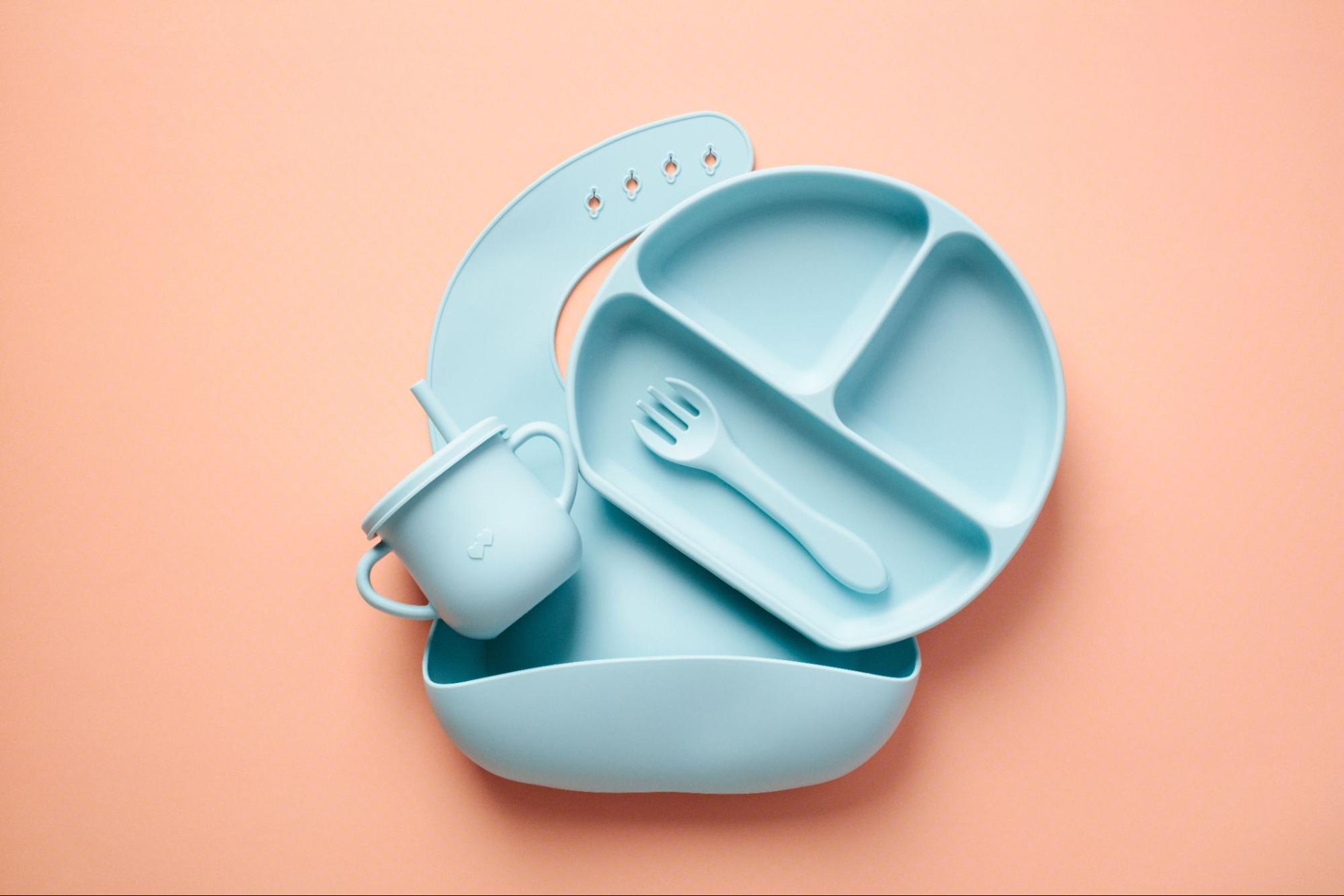

Silicone rubber is a versatile, high-performance material prized for its biocompatibility, heat resistance, and lasting flexibility. It’s ideal for medical-grade wearables, soft-touch buttons, heat-resistant seals, and oven-safe kitchen tools.
Silicone baby products
Its ability to perform in extreme conditions, such as high heat and pressure, is desirable but comes with trade-offs. Unlike thermoplastic elastomers, silicone requires more complex injection molding techniques due to its unique thermal cure behavior. It is also commonly used in compression molding.

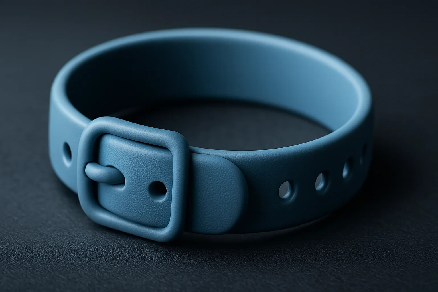

This rubber-like thermoplastic elastomer material stands out for its exceptional durability, excellent abrasion resistance, high elasticity, and strong tear resistance. These properties make TPU a common choice for applications such as footwear soles, flexible housings, and wearable device wristbands.
TPU wearable band
While it offers impressive mechanical performance, the raw material can be hygroscopic, meaning it can absorb moisture and require drying before molding. TPU temperature resistance does not match silicone, but it is still well-suited for everyday and industrial uses. Commonly processed through injection molding or 3D printing methods, such as FDM (Fused Deposition Modeling), SLS (Selective Laser Sintering), or MJF (Multi Jet Fusion), it provides a flexible solution for demanding environments.

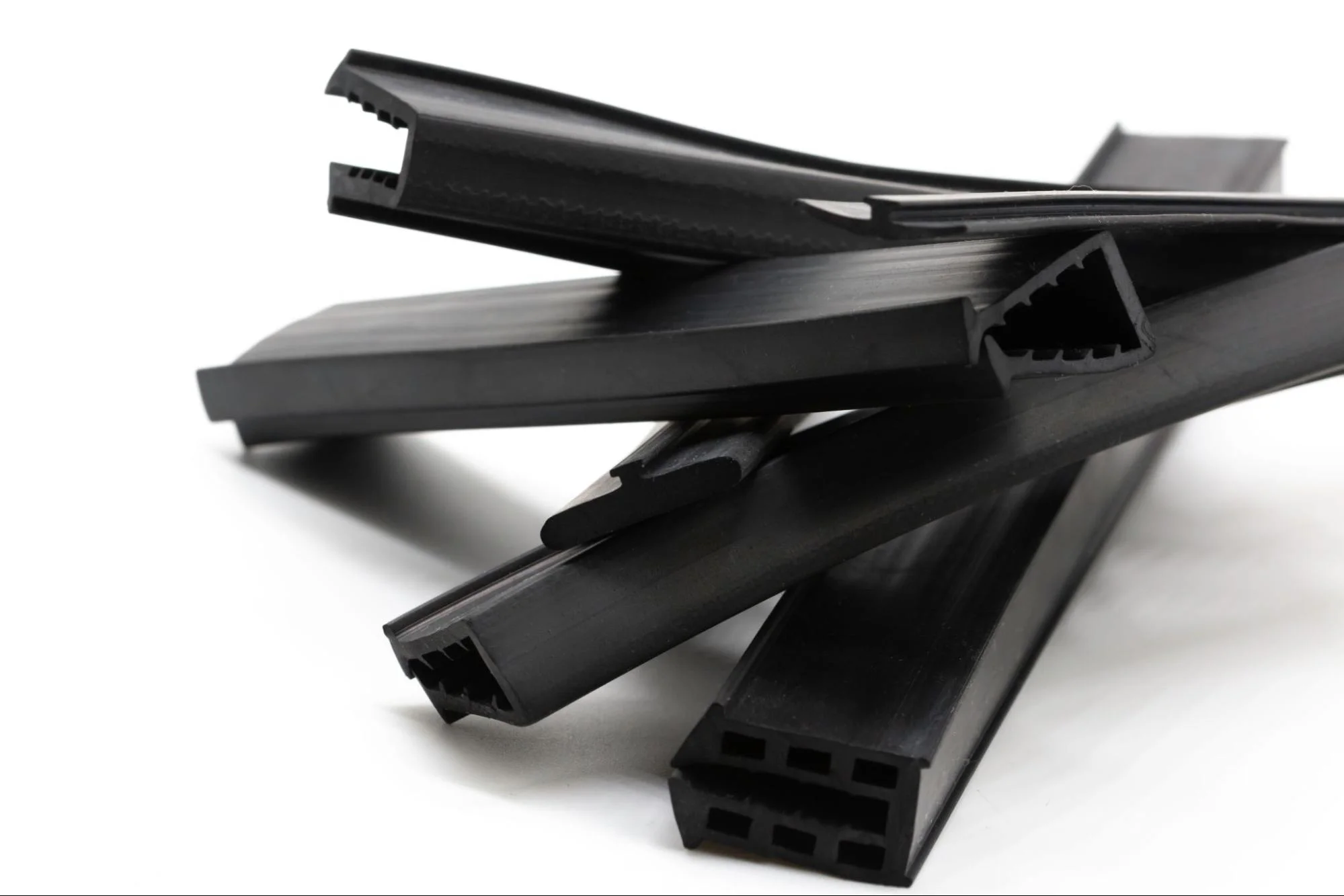

EPDM rubber is known for its outstanding resistance to weather, alkalis, and various solvents. This synthetic rubber maintains its flexibility over time, making it a reliable choice for outdoor seals, automotive weatherstripping, and HVAC gaskets.
EPDM rubber extrusions
flexible epdm
While it withstands harsh environments, EPDM offers limited chemical resistance and is not as commonly used for complex part geometries. It is a thermoset (not a thermoplastic), but processing includes extrusion, compression molding, and injection molding. Despite its chemical limitations, its long-term durability and resilience to outdoor and environmental applications make it a practical elastomer material fit for various applications.

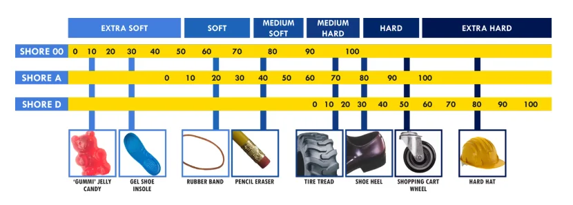

Note: Durometer can vary on the Shore hardness scale depending on formulation. Consult material datasheets or test parts when durometer is critical to performance. The image below shows examples across a range of durometers.
Durometer scale with shore hardness
