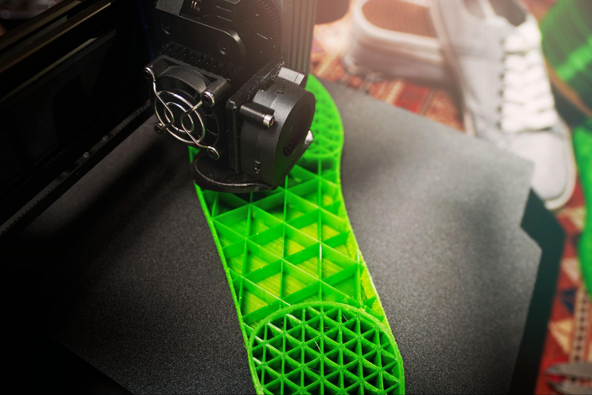

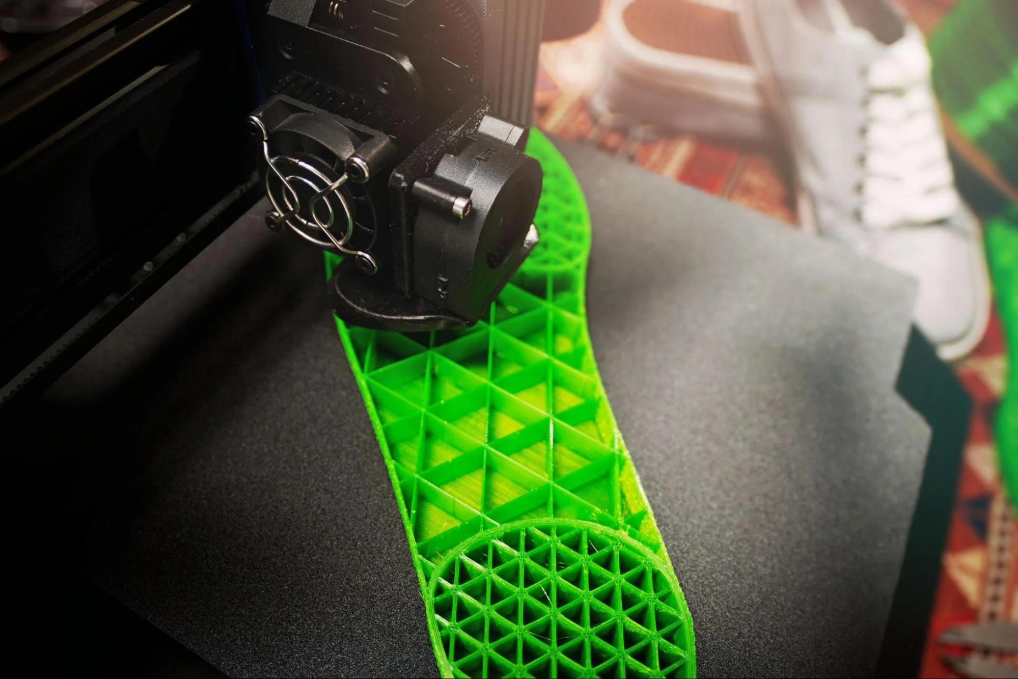

A low to moderate infill percentage (10–40%) is recommended. Gyroid or rectilinear infill patterns are great choices for flexible materials because they allow compression and flexing throughout the part. Avoid grid patterns that will create stiff, high-stress areas.
