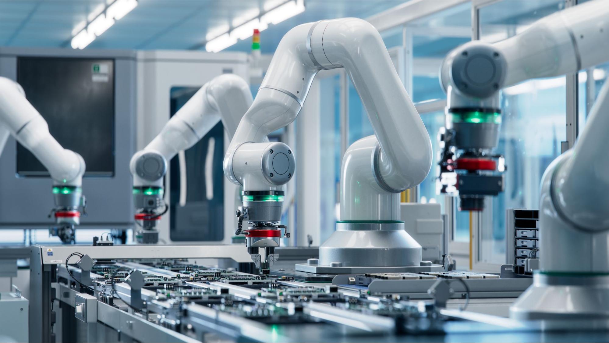

While robotics can automate many tasks, including manufacturing processes, the robots themselves must be intentionally designed and manufactured as complex systems.
Manufacturing for robotics here refers to the design and production of robotic systems themselves, rather than the products those robots later assemble. It involves selecting and integrating the right mix of off-the-shelf parts and custom-manufactured components—using processes such as CNC machining, injection molding, and sheet metal fabrication—to achieve precision, durability, and scalability in robotic platforms.
Robots are hybrid systems that combine custom precision parts, such as machined actuator housings or joint cores, with standard off-the-shelf components, including bearings, belts, and modular frames. The balance between custom-built and purchased components reflects trade-offs between accuracy, cost, development speed, and scalability.
This article breaks down the core processes used to manufacture robotic systems, explains when custom and standard parts make sense, and shows why system-level decisions are critical to a profitable manufacturing strategy.

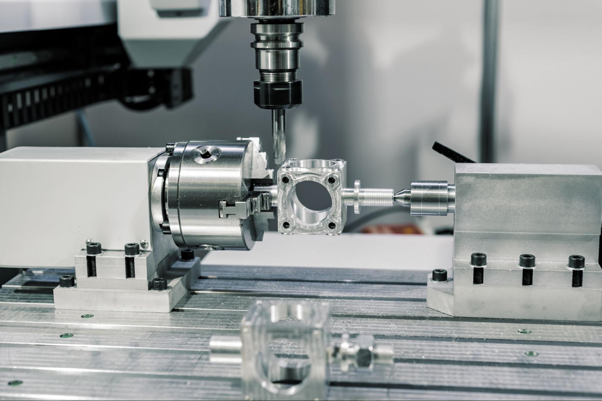

Precision Machining for Actuators and Joints
Motion-critical subsystems are where manufacturing accuracy is most observable in robot performance. Actuators and joints convert control signals into physical motion, and dimensional errors in these components show up as positioning error, repeatability loss, vibration, or drift during operation.
Why CNC Machining Is Critical
CNC machining is commonly used for actuator housings, joint bodies, gearbox cases, and motor mounts because it enables the dimensional accuracy and geometric control required for reliable motion. The process itself does not guarantee accuracy, but it makes achieving tight tolerances, coaxiality, and flatness more practical and repeatable than most alternatives.
Small geometric errors in joint components can accumulate across a kinematic chain, increasing end-of-arm positioning error or variability in motion paths. In production environments, this directly affects whether the robot can repeatedly place parts within required positional limits.
Functional Requirements for Machined Robot Parts
From a functional standpoint, machined motion components must support specific system-level behaviors. Examples include maintaining joint alignment under load, transmitting torque without excessive compliance, and preserving bearing preload over repeated duty cycles. Failure to meet these requirements can result in measurable loss of accuracy, increased wear, or shortened maintenance intervals.
CNC machining for custom robotics components.

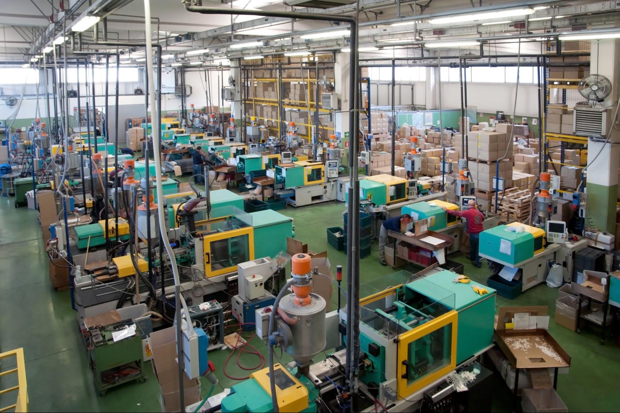

Injection Molding for Robotic Housings and Covers
Injection molding is primarily used for non-load-bearing subsystems that protect and organize the robot’s mechanical and electrical elements during operation. Filled plastics are sometimes used for semi-structural covers, but typically still require metal load paths.
Injection molding becomes particularly attractive as robot production volumes increase, because tooling enables consistent part geometry across builds. Features such as clips, ribs, bosses, and cable-routing channels can be molded directly into the housing geometry, reducing secondary operations and part count.
From a system perspective, molded enclosures, or housings, serve several technical functions. They protect motion components from debris and operator contact, constrain cable routing to prevent fatigue, and provide controlled interfaces to machined frames and mounting points. Design considerations include draft angles, wall thickness control, reinforcement around fastener interfaces, and defined clearances for thermal expansion and service access.
Injection molding for custom robotics components.

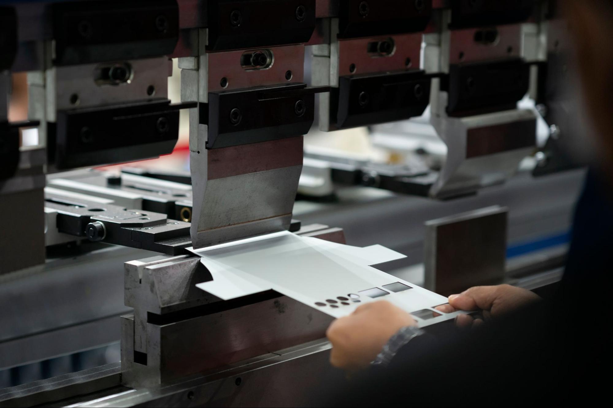

Sheet Metal Fabrication for Frames and Chassis
The primary structural frames and chassis of many robotic systems are fabricated from sheet metal using laser cutting, bending, welding, and fastening operations.
This approach is most commonly applied to mobile robot chassis, electronics enclosures, and lightweight structural panels, where flat geometries and folded sections can provide adequate stiffness without the cost or lead time of complex machined structures. Sheet metal fabrication supports relatively fast turnaround for prototypes and low-volume production when designs rely on standard gauges and simple bend geometries rather than progressive stamping.
Effective sheet metal design for robotic frames requires attention to bend allowances, weld distortion, fastener access, and tolerance accumulation across multiple formed features. When these factors are addressed explicitly, sheet metal structures can provide predictable alignment surfaces for machined joints and actuators without requiring excessive post-assembly adjustment.
Sheet metal fabrication for custom robotics components.

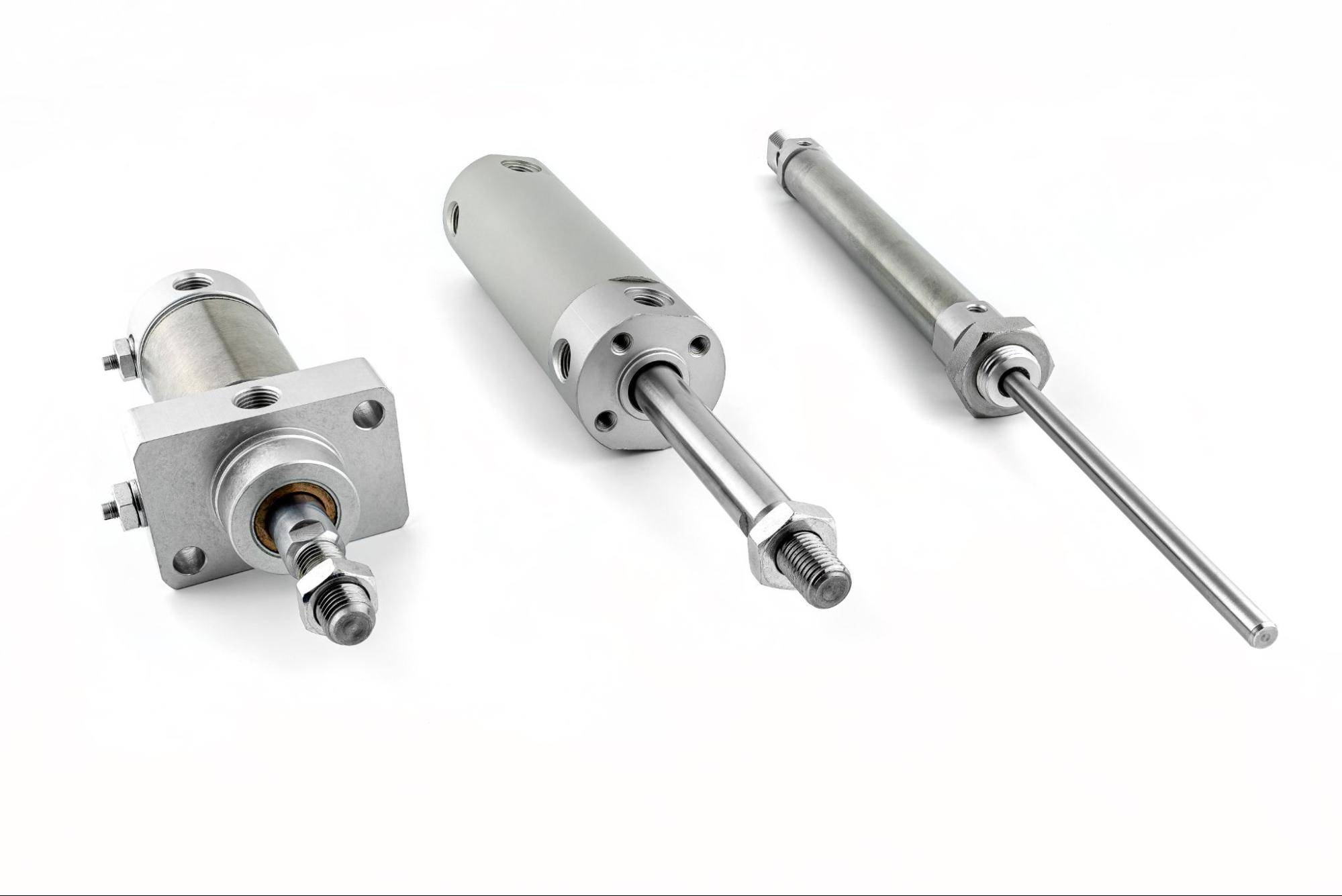

Using Off-the-Shelf Components in Robotic Systems
Not every component in a robotic system needs to be custom-designed. Strategic use of off-the-shelf components reduces development effort and technical risk without sacrificing system performance.
Robotic systems commonly rely on off-the-shelf components in the following categories:
  • Motion guidance elements such as linear guides and rails, shafts, bearings, cam and roller followers, bushings, hinges, and slides that define controlled motion and support loads with repeatable alignment
  • Motion transmission components, including belts, pulleys, chains, gear reducers, couplings, pneumatic cylinders, and fittings used to transmit force and motion between actuators and joints
  • Structural elements such as modular aluminum extrusions, brackets, and framing components used to build robot frames, guards, and support structures
  • Assembly and alignment hardware, including NAAMS locating pins, precision locating pins, jig bushings, spacers, fasteners, mounting hardware, and electrical interface components that establish repeatable datums and consistent assembly
These components allow engineering teams to focus custom effort on subsystems that require differentiation or precision.
Off the shelf pneumatic cylinders
