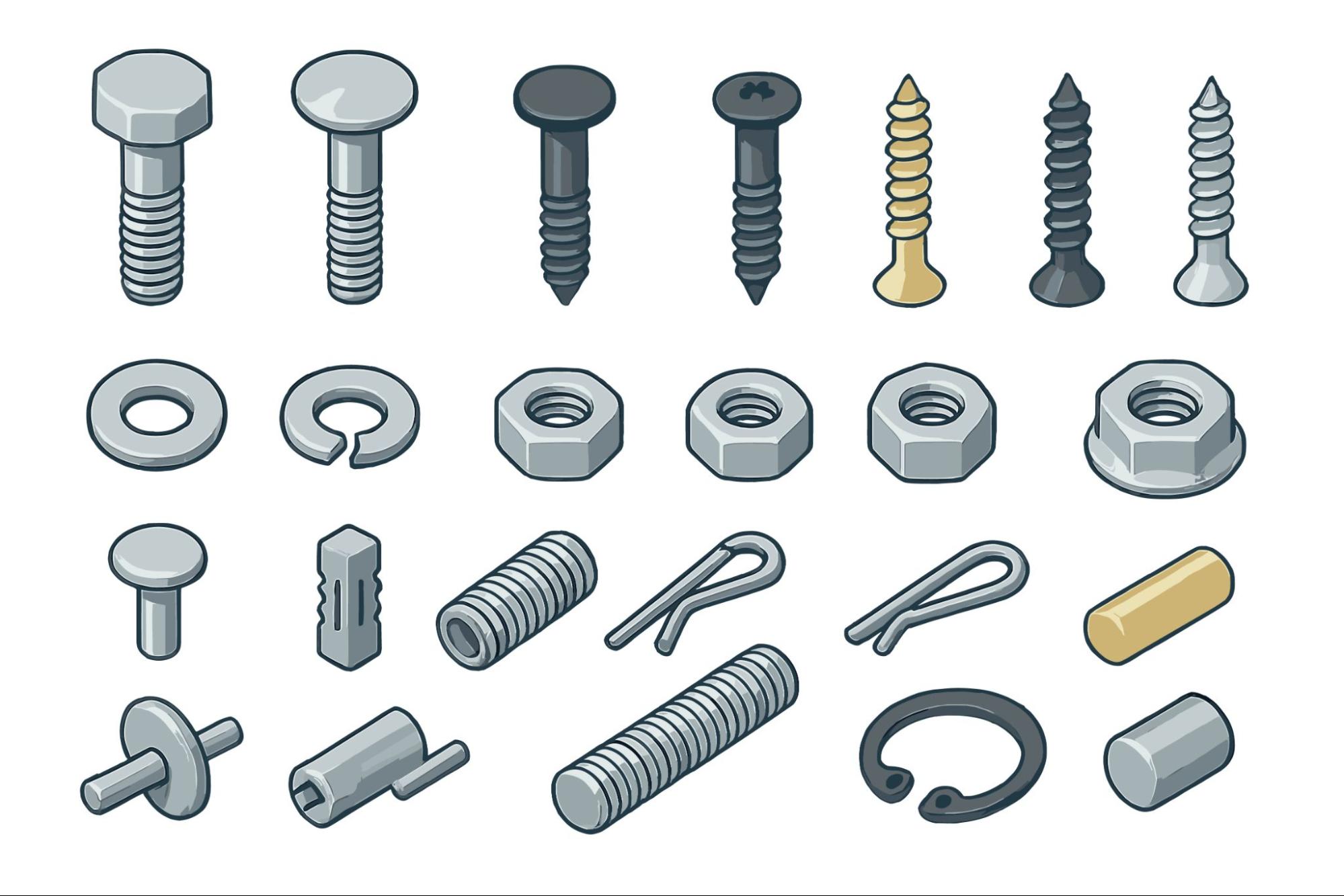

Common Types of Mechanical Fasteners
Mechanical fasteners cover a broad range of hardware. These are the most widely used fastener categories in engineering and manufacturing:

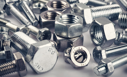

Bolts & Screws
Bolts and screws provide high tensile strength, predictable preload (the initial tension applied to a bolt when tightened), and repeatable performance. They’re available in nearly endless head styles, drives, materials, and coatings.
  • Bolts work with nuts to affect clamp load across multiple components.
  • Screws are typically inserted into a threaded hole, or can be self-threading.
Nuts and bolts are common mechanical fasteners.

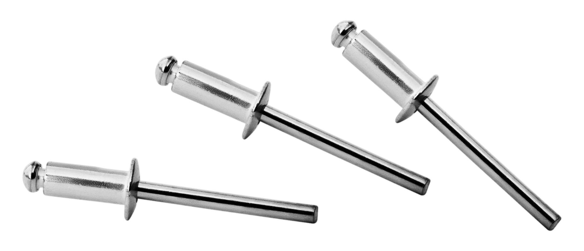

Rivets
Rivets produce permanent joints, especially in sheet metal fabrication, aerospace skin panels, and large structures. Because they don’t require threads, rivets are lightweight, cost-effective, and easy to install. They also provide excellent fatigue resistance.

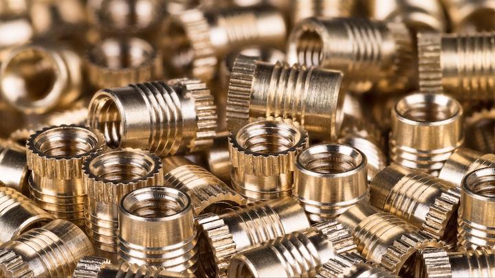

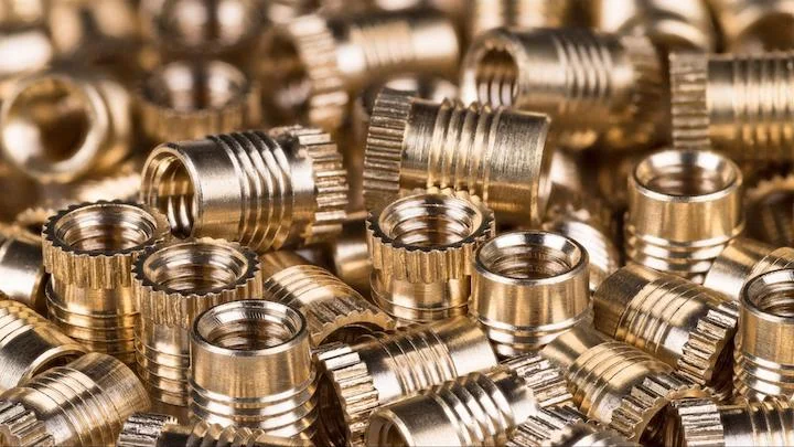

Threaded Inserts
Inserts reinforce threads in materials that would otherwise strip, especially in plastics and aluminum. They can be press-fit, heat-set, ultrasonic, mold-in, or helical wire-style.
Brass threaded inserts used for mechanical assembly.
mechanical fasteners brass

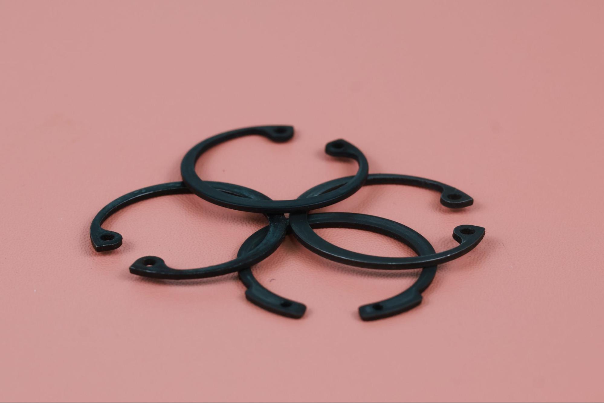

Retaining rings (circlips)
Retaining rings also known as circlips
