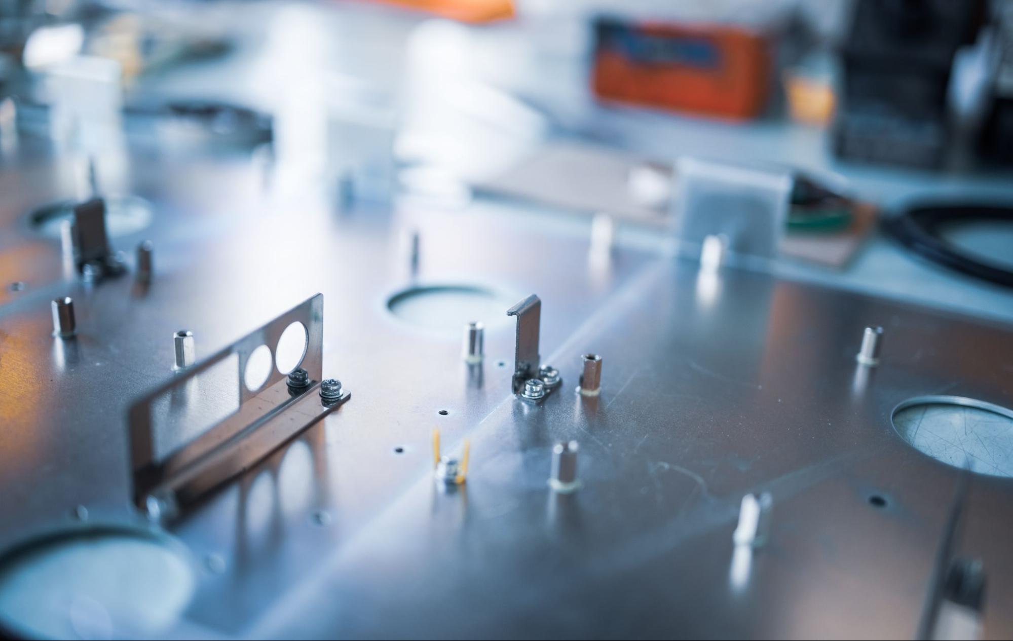

Sheet metal fasteners, such as self-clinching nuts, studs, and standoffs, provide strong, reusable threads in thin sheet assemblies where traditional methods like welding or tapping are not feasible. These fasteners are pressed into pre-punched holes, displacing the surrounding material to form a permanent, load-bearing anchor. They are widely used in electronics enclosures, aerospace panels, and automotive assemblies for efficient and reliable connections.
The use of sheet metal fasteners enables very thin sheets of metal to be reliably fixed together in load-bearing applications. While welding and gluing are alternative sheet metal joining methods, sheet metal fasteners remain key, especially for applications where products may need to be disassembled.

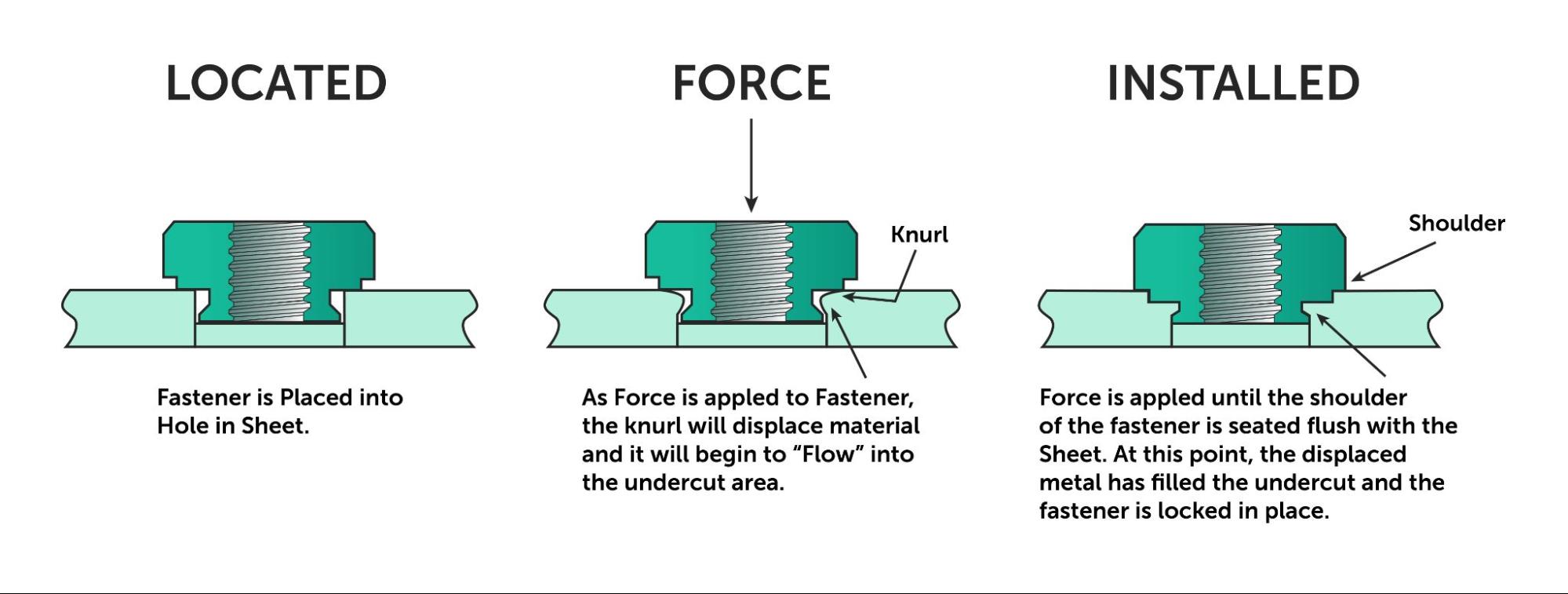

Self-clinching fasteners are installed into a properly-sized hole in sheet metal using a press to deform the sheet metal around the edge of the hole. This works using cold flow, where the sheet metal flows into the recess ring around the outer shank of the nut or stud. The metal now in the recess prevents the fastener from falling out, even under loading. Additionally, there is knurling on the shoulder of the fastener, which prevents the hardware from rotating in the sheet metal.

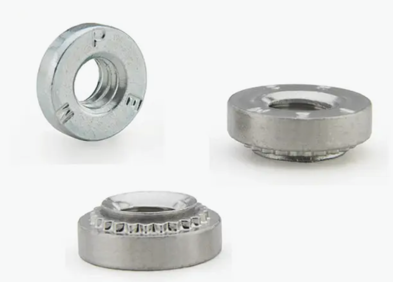

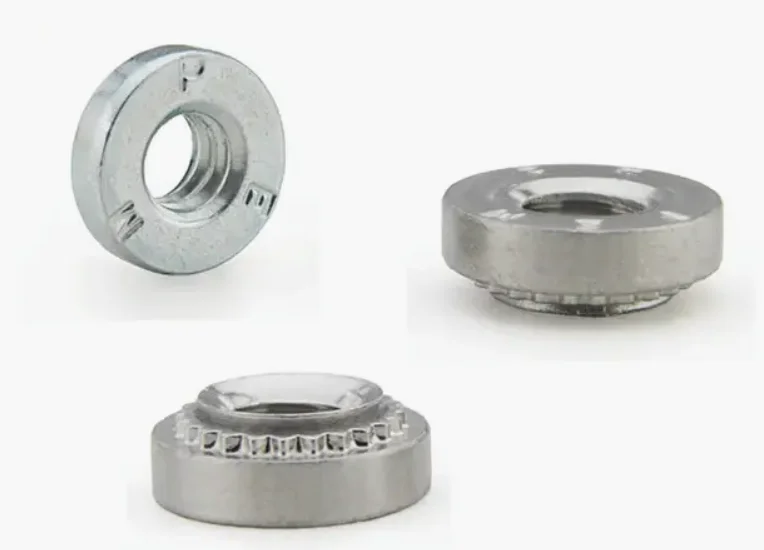

PEM Nuts
PEM nuts are added to sheet metal to attach threads used for fabricating sheet metal assemblies. They are installed by pressing the nut into a pre-punched hole in the sheet metal. The sheet metal flows into a recess around the nut. The flow of metal into a serrated clinching ring in the fastener recess means that once installed, they cannot be removed.
pem nuts
Figure 1 PEM Nuts

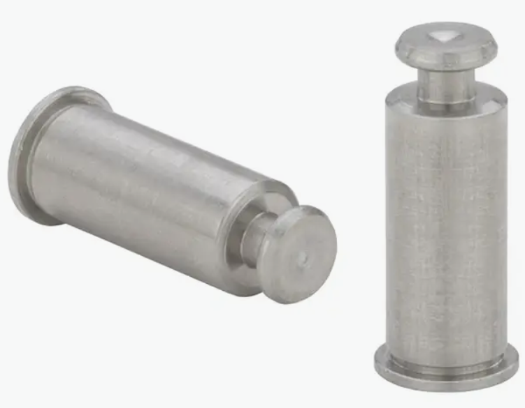

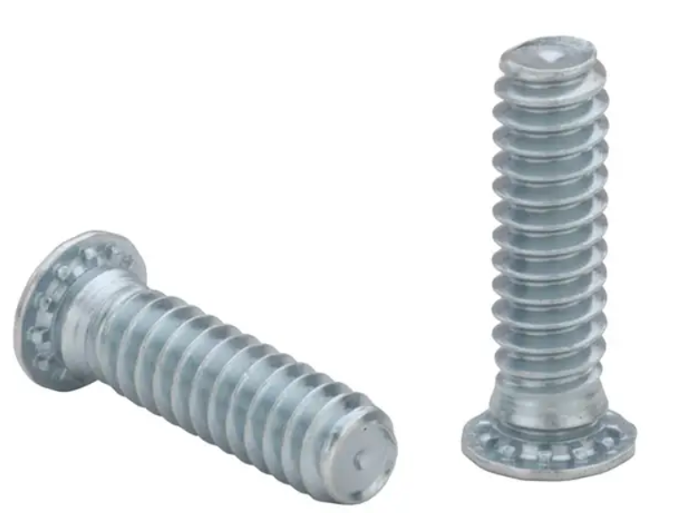

PEM Studs and Pins
PEM studs and pins operate on the same principle as PEM nuts. However, the stud features a threaded shank used to assemble sheet metal parts. PEM pins are unthreaded and are utilized for precision alignment of parts.

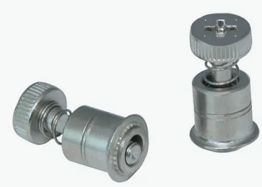

Self-Clinching Panel Fasteners
Panel fasteners are fittings that hold a captive screw with spring retention that keeps the stud retracted. This makes it easy to install and uninstall panels for maintenance and repair.

  1. The first step is to drill or punch a precisely sized and located hole into ductile sheet metal. The hole does not need to be deburred, as this excess material aids the cold flow process.
  2. Locate the shank of the self-clinching fastener in the hole from the same side the drill or punch entered.
  3. Support the underside of the sheet metal with an anvil and press the hardware into the sheet metal with an arbor or a punch. If the hardware is a nut, it should be pressed into the metal with the squeezing force recommended by the fastener manufacturer.
  4. Visually inspect the hardware to ensure that the knurling is fully embedded in the surface of the sheet metal, preventing the fastener from rotating in the hole.
