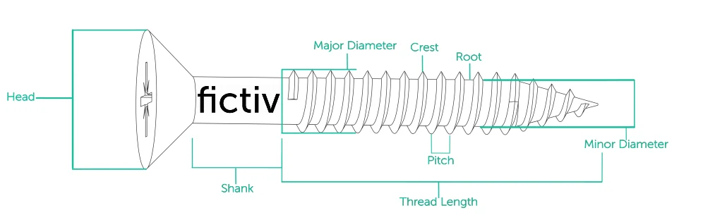

Threaded fastener diagram

While tapping is the process of creating internal threads within a hole, threading is the process of creating external threads on the cylindrical body of a screw, bolt or other part to be assembled (like pipes). When referring to an installation location for a threaded fastener, you may use the term threaded hole or tapped hole but remember that a fastener is threaded, not tapped.
Threading on a screw or bolt begins at the point of engagement of the fastener and continues through the body to the shank, or unthreaded portion, of the fastener. See the image at the beginning of this article for a more detailed refresher on threaded fastener terminology.
