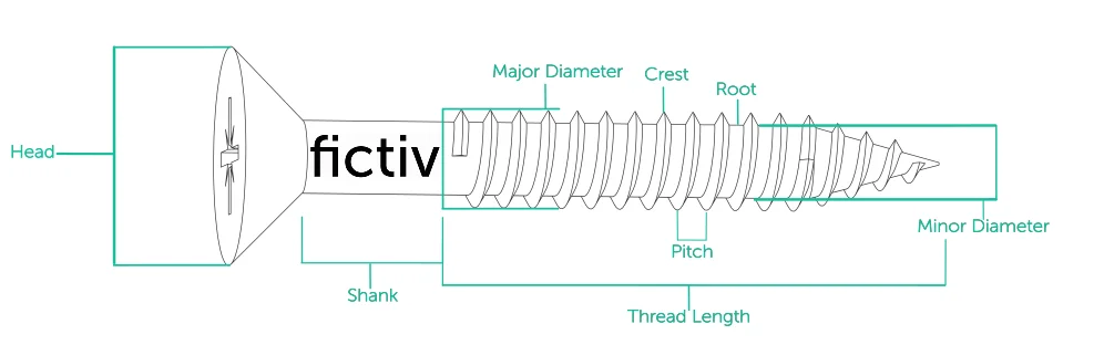

Review of important screw thread terminology
Knowledge of the purpose and working logic behind screw design is important, but it’s likely that your job duties entail designing threaded holes for screws, not the screws themselves. Threaded (or tapped) holes serve as a non-permanent joint and provide a location for fastener installation in mechanical assemblies. Threaded holes are created by tapping a helical groove, or thread, into the surface of an existing hole.
Knowing the ins and outs of threaded holes is crucial to ensuring your mechanical assembly is securely constructed, and this article discusses the various types of threaded holes, the methods used to create them, and important considerations to keep in mind when specifying threading holes in your next mechanical design project.

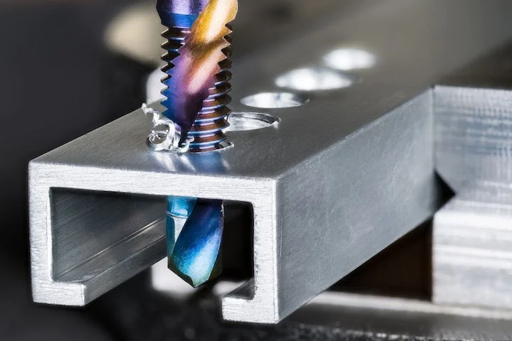

drill bit making a threaded hole in an aluminum profile

As with the production of many common geometric part features, there are a variety of methods used to create the internal threads in threaded holes, including cutting, rolling, and forming. Threaded holes are typically drilled then tapped with a thread tap. The optimal method depends upon:

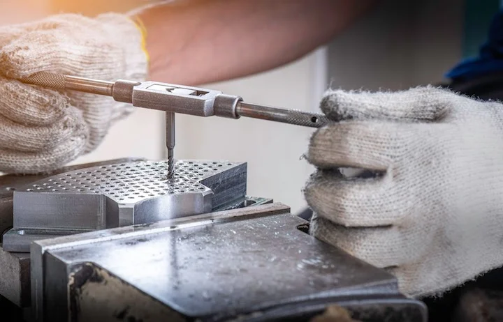

Cutting
This method involves using a cutting tool, such as a tap or die, to cut threads into a hole. This method is most commonly used for creating threads in small or irregularly shaped holes. Generally, the drilled hole diameter should be equal to the minor diameter of the fastener you will install in the tapped hole. A cutting tool, or cutting tap, works by ejecting removed chips out of the hole along the tap’s flute as it cuts threads. Chip production in a blind hole may cause jamming during assembly.
Rolling
Rolling uses a rolling tool, such as a thread rolling die, to press threads into a hole. The roll forming method (aka forming method or form tapping) is often used for creating threads in large or regular holes and is considered to be more efficient and cost-effective than cutting. When forming, the drilled hole diameter should be bigger than the minor diameter of the fastener you will install in the tapped hole.
A rolling tool, or rollng tap, works without chip formation because it forms threads via deformation instead of material removal. Roll taps are typically stronger than cutting taps because of their rigid design, so they typically have a longer tool life as well. However, roll taps are not suitable for harder materials (like cast iron) or brittle materials (like plastics).
