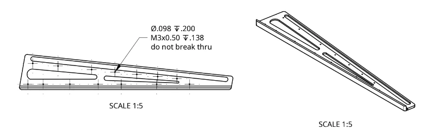

Here is an example of how to callout a blind hole for an engineering drawing:
![engineering drawing blind hole callout](https://www.fictiv.com/wp-content/uploads/2023/12/engineering-drawing-blind-hole-callout.png)
The callout ⌀.098 ↧.200 means a 0.098” diameter hole to a depth of 0.200”.
