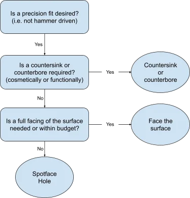

There are many different ways to approach functional design. One of the best methods to employ is elimination and reduction. Once you’ve established that a precision fit is desired, the design-by-elimination process is relatively straightforward. Use the simplified flowchart below.
![As shown in the flowchart, there are a few drivers in the decision-making process.](https://www.fictiv.com/wp-content/uploads/2023/08/decision-making-process.png)
First and foremost, is precision needed? This question needs to be asked before the design is made. Otherwise, the hammer of frustration will make an appearance.
After establishing precision needs, the performance and cosmetic requirements need to be examined. (Use the countersink holes article for additional information.)
The last drivers are the scope of the precision and the cost. If only a small target area around the hole — let’s call it a spot — needs to be faced and the cost needs to be kept down, then a spotfaced hole is the solution.

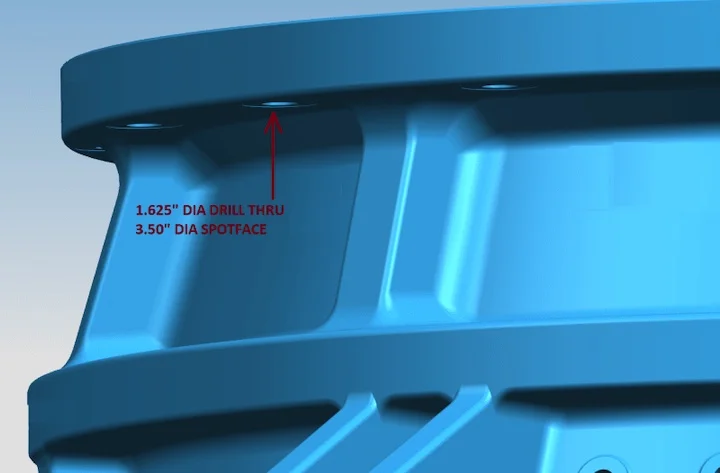

How do you call out a spotfaced hole?
A spotface is a specific callout made on a control drawing or indicated in a CAD (e.g., SolidWorks) model. The GD&T symbol for a spotface is shown below.
![Spotface symbol](https://www.fictiv.com/wp-content/uploads/2023/08/Spotface-symbol.png)
A proper spotface callout requires, at a minimum, the diameter of the spotface to be called out. (A depth is not needed.) The spotface callout precedes a hole callout as the spotface is a secondary operation.
The simplest callout combination would be a through-hole with a spotface. In machining terms, this would entail a drilling operation followed by spotfacing using a spotface tool, which can be an appropriately sized end mill, counterborer, or an undersized endmill that performs an orbital pattern. Let’s use a metric example of a 2.2mm through-hole with a 5.5mm spotface. The GDT callout (without tolerances) would be as follows

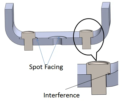

![Spotfacing](https://www.fictiv.com/wp-content/uploads/2023/08/Spotfacing.png)
What are some further considerations with spotfacing?
Spotface callouts are add-ons that become more important as the precision requirements increase. For example, if a chemical or vapor seal is needed, then high-precision injection molding may not be enough; a spotface is very likely needed to ensure a gapless seal that is closer to the CAD model. Similar to countersinks, there are other uses for a spotface besides making a level surface for a screw head to rest on. Of course, a washer or a standoff can be placed on a spotfaced area, but what if there is no need for a hole? Spotfacing of contact points can be incredibly useful.
There are some cases in engineering design where two flat surfaces need to contact each other and they must be truly flat. If there is one or more localized contact points, then spotface callouts are needed. The callout is exactly the same as shown above. The symbol refers to the secondary machining process of localized facing.
Flattening contact surfaces often fixes larger issues with a produced part. Produced parts never come out like the CAD model, but two flat contacting surfaces can be used to locate and anchor parts. For example, a large 3D-printed part may have a slight warp in one dimension. Using spotfaced contact points in this case will align the part as it is fastened together. As the part is fastened, the flat surfaces become parallel and allow for some sliding. This enables the assembled geometry to more closely match the CAD model.
