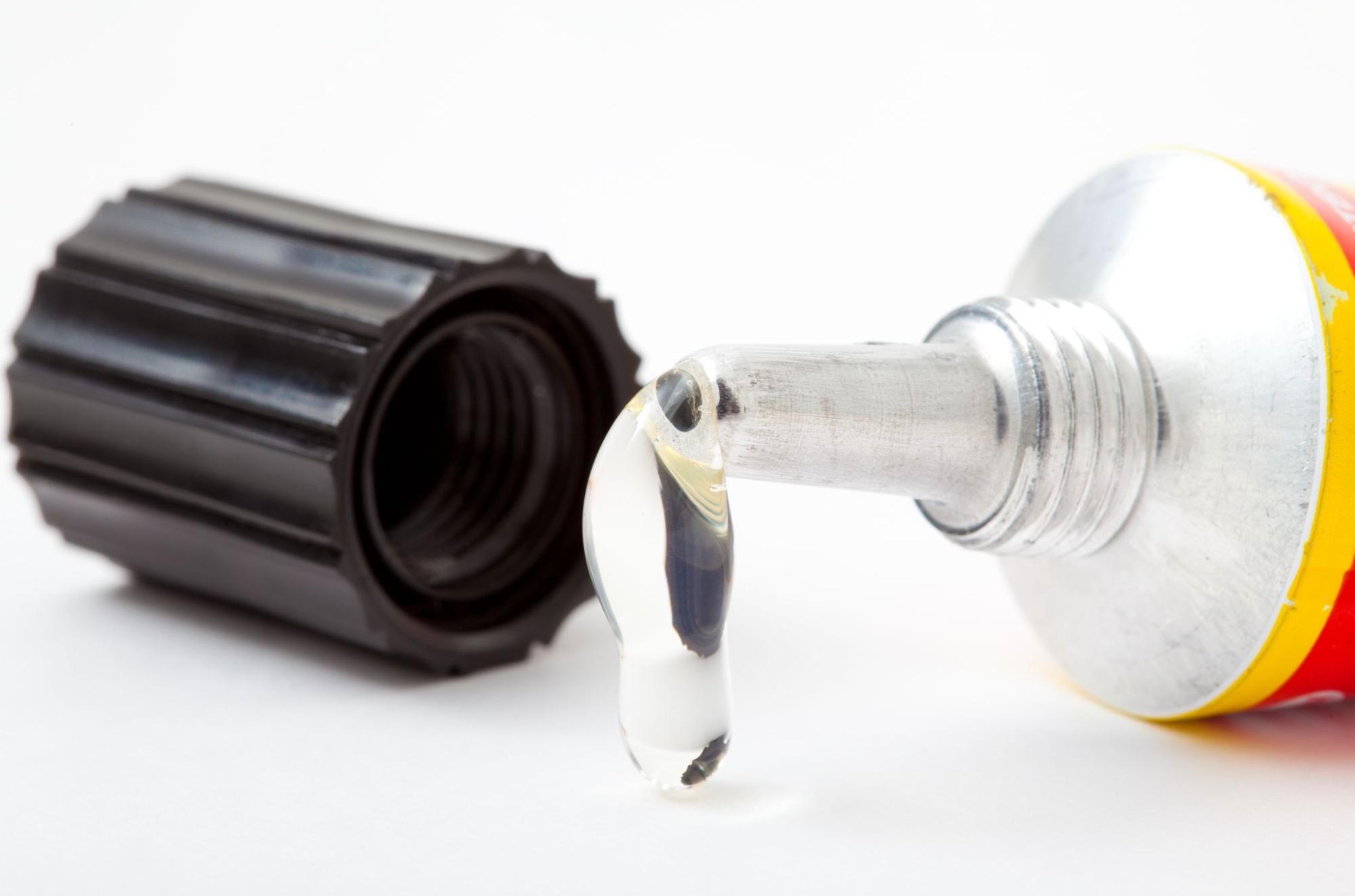

Cyanoacrylates (instant adhesives) deliver extremely rapid bonding—often within seconds—which makes them ideal for small components, sensor housings, and plastics where speed and precision are paramount. However, they are brittle and less suited for high-temperature or high-load conditions.
Urethane adhesives bridge the gap between strength and flexibility. Their ability to absorb shock and accommodate differential expansion makes them valuable for assemblies exposed to vibration, such as automotive interiors or consumer devices.

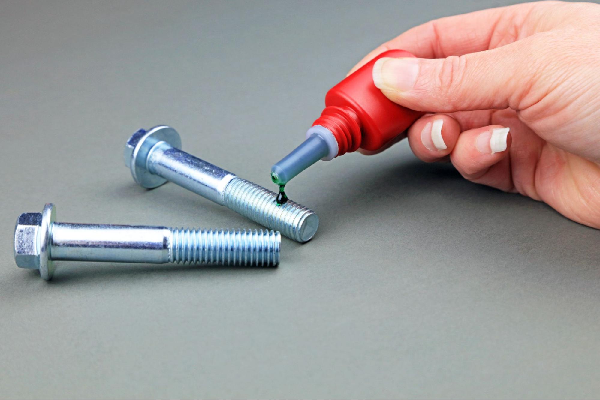

Anaerobic adhesives, commonly used for threadlocking and sealing, cure in the absence of oxygen when held between metal surfaces. They prevent loosening in bolts, fittings, and rotating assemblies.
Threadlocker is an anaerobic adhesive commonly used to secure threaded fasteners

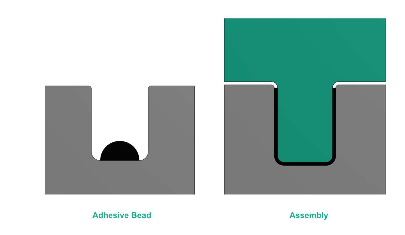

Designing Adhesive Joints for Strength and Durability
Adhesive performance depends not only on the chemistry but also on joint geometry and load distribution. Because adhesives are strongest in shear and compression, joint designs should minimize tension and peel forces that can lead to premature failure.
Below are some of the standard joint configurations for using adhesives:
  • Lap and scarf joints are preferred for structural applications and maximize the bonded area.
  • Step-lap and tongue-and-groove joints provide alignment and reduce peel in plastic assemblies.
  • Tape joints (PSA/VHB) require broad, consistent surface contact, and often include a recess to control thickness.
  • Hot-melt bead joints are appropriate for disposable or low-load components.
A groove joint is commonly used for assembly with adhesives
Proper design transforms an adhesive joint from a potential weak point into a structural asset. Therefore, when designing joints for adhesives, it is essential to consider the following:
  • Use the volume or cross-sectional area of the adhesive bead to calculate the displacement and wetting area in the final assembly based on clearance.
  • Maintain a uniform bondline thickness of 0.05–0.15 mm to balance strength and flexibility.
  • Account for thermal expansion mismatch. Metals and plastics expand (and contract) differently with temperature changes, so flexible adhesives or compliant joint geometries may be necessary to relieve stress.
  • Match adhesive modulus to expected load type: rigid adhesives handle shear loads best, while flexible ones resist vibration and peel.
