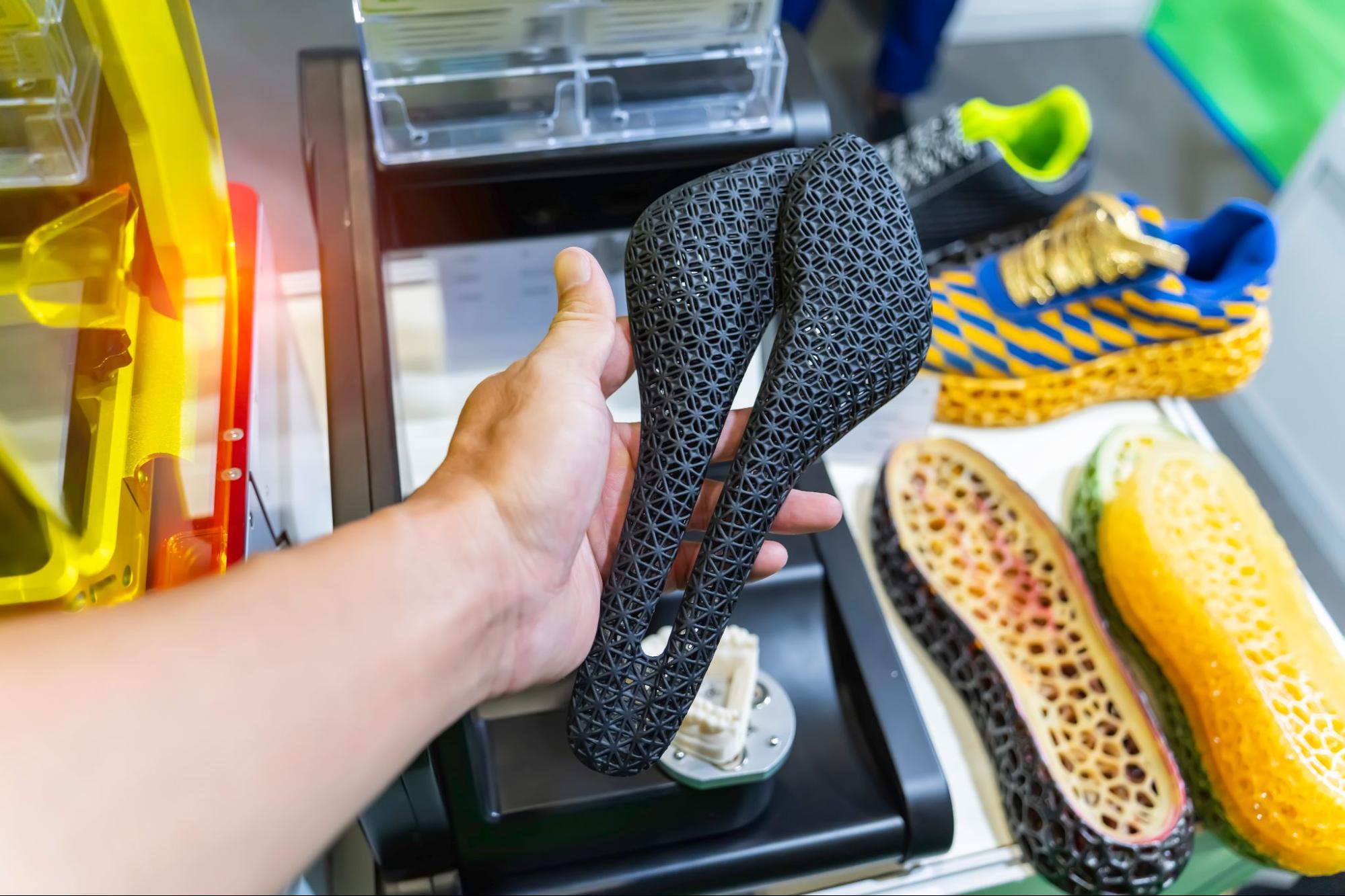

TPU material used for 3D printing bike seats and shoe soles.

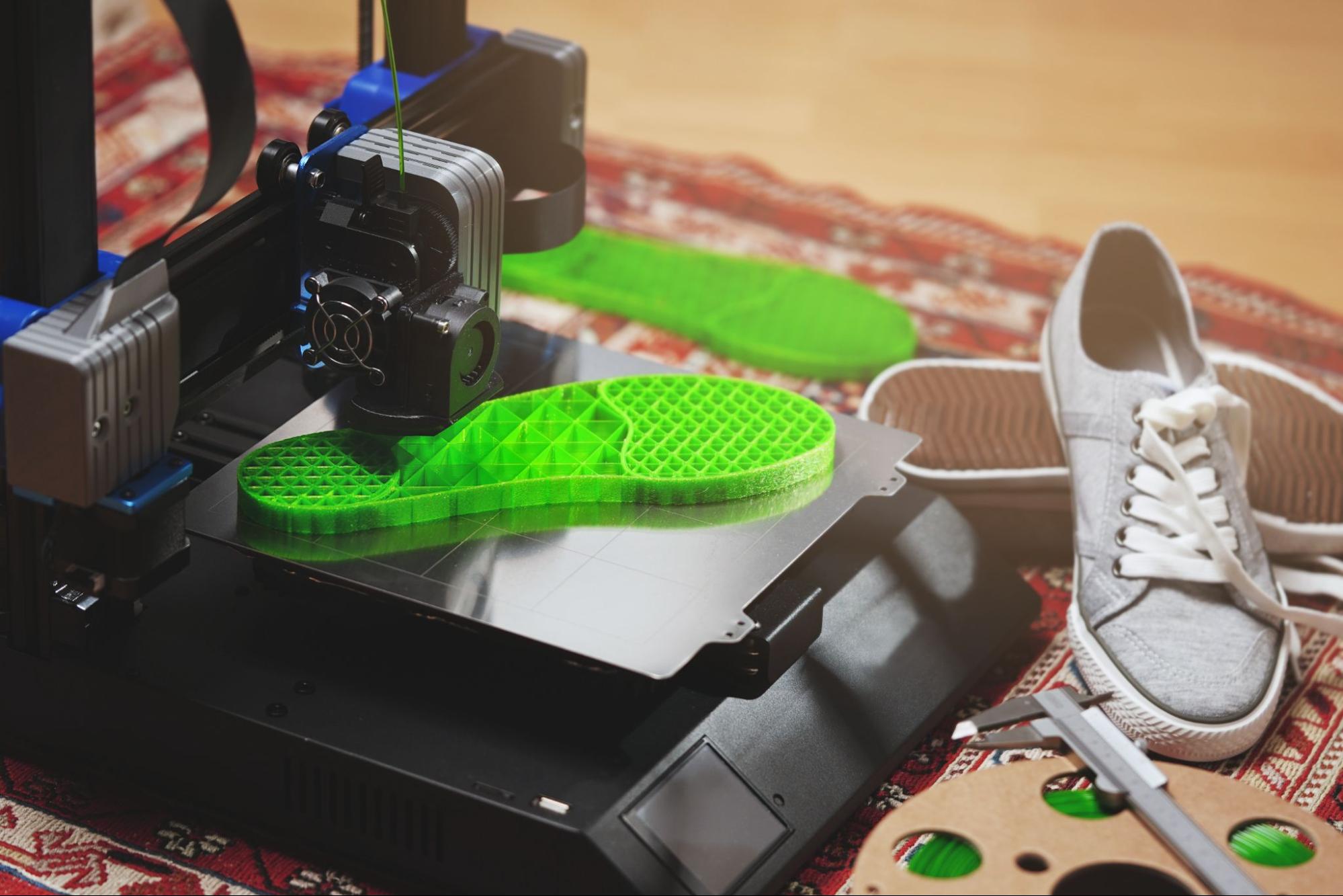

FDM Printing With TPU
FDM printing with TPU filament is arguably the most accessible way to print flexible parts. It’s practical on desktop or hobbyist machines, but can also be used in industrial printing applications.
However, printing TPU with the FDM process requires careful tuning of print settings, such as feed rates and bed temperatures. This is because the filament is soft and elastic (making it more susceptible to buckling or retracting improperly). For best results, use a direct-drive extruder, short filament paths, slow speeds, minimal retraction, solid bed adhesion, and proper part supports.
Strengths: Affordable, easy to learn, low machine cost, good for making flexible prototypes or low-volume parts.
Weaknesses: Anisotropic strength (varying according to direction), slower printing speeds, potential print issues (stringing, filament buckling), and lower strength compared to SLS-printed parts.
3D printing flexible shoe soles with FDM
