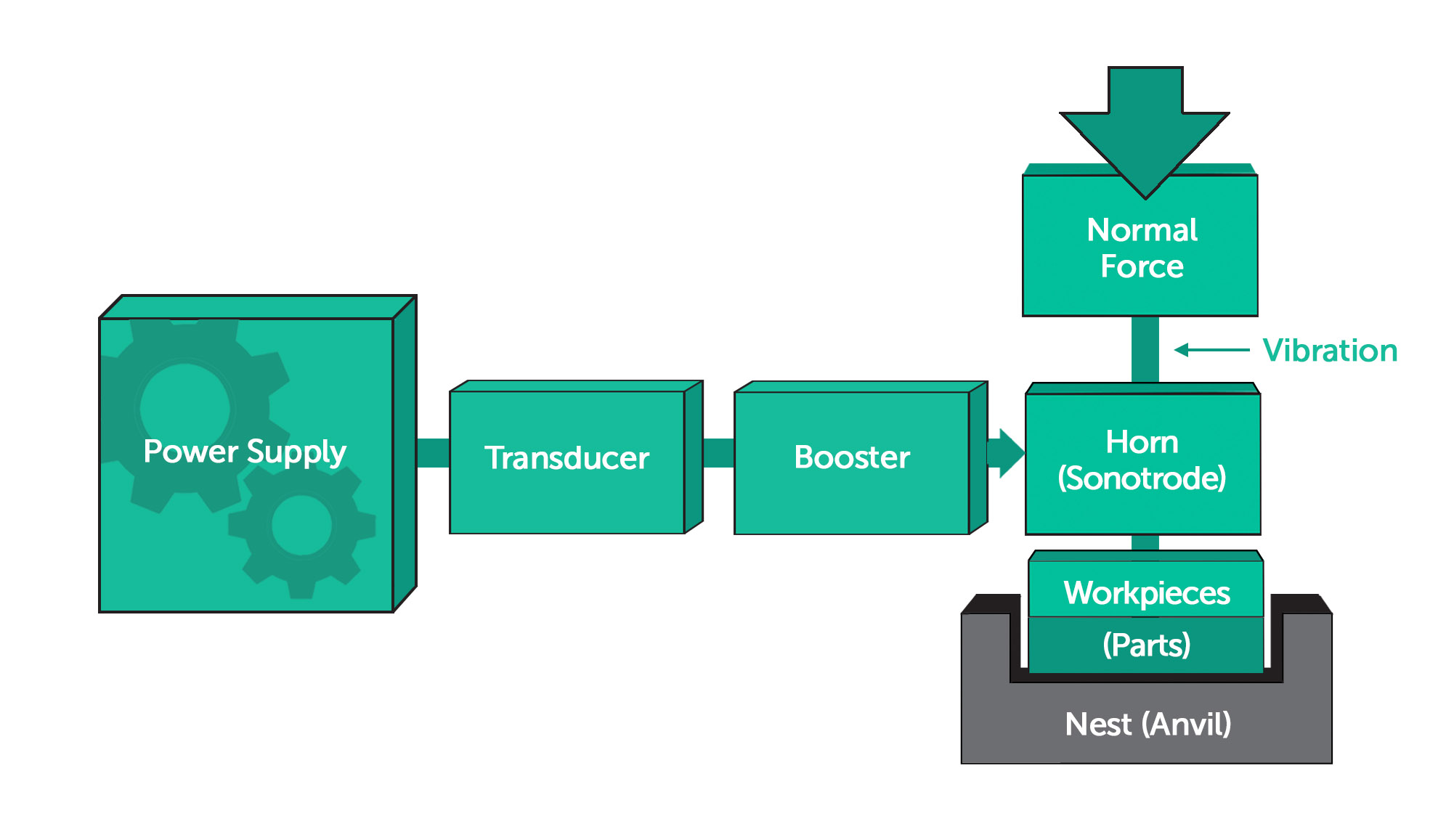

Ultrasonic Welding Equipment Overview
An ultrasonic welding system includes the following primary components:
  • Generator: Converts standard electrical power into a high-frequency signal (typically 20–70 kHz).
  • Converter (Transducer): Transforms the electrical signal into mechanical vibrations.
  • Booster: Modifies the vibration amplitude and transmits it to the horn.
  • Horn (Sonotrode): Delivers the vibrations directly to the parts being welded.
Together, these components form the ultrasonic stack, mounted in a precision press. The stack is most commonly arranged vertically, but certain automated or space-constrained systems use a horizontal orientation to accommodate part geometry or assembly layout. Proper tuning of the stack to its resonant frequency ensures efficient energy transfer and prevents overheating or inconsistent weld quality.
The nest (or anvil) supports and positions the lower part of the assembly. It provides a rigid, precisely machined surface that maintains alignment and transmits the clamping force evenly during welding. Well-designed nests reduce part vibration, improve weld consistency, and prevent cosmetic damage to finished surfaces.
As illustrated in Figure 1, the horn transmits vibrations to the workpiece, which is fixed against the anvil.
Diagram of the ultrasonic welding process and equipment
Figure 1 Diagram of the ultrasonic welding process and equipment

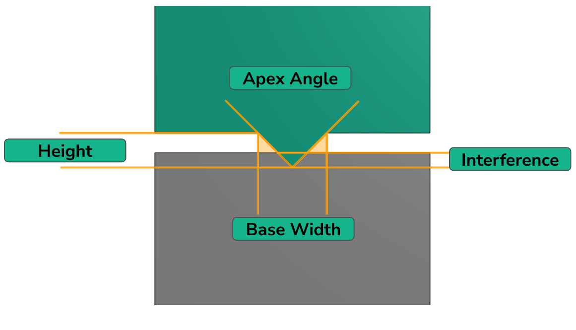

Energy Directors
Energy directors are triangular or trapezoidal ridges molded into one mating part to focus ultrasonic energy at the weld line. The sharp edge softens under vibration and collapses into the joint, creating a controlled melt. Amorphous plastics allow consistent collapse of the energy director, while semi-crystalline materials may require larger or double energy directors to ensure complete melt. For these materials, incorporating a small melt trap or secondary ridge can help capture excess flash and improve joint cosmetics.
Early weld trials are often used to fine-tune the height and angle of the director for each resin formulation. Guidelines suggest a height of 0.2–0.5 mm (≈ 0.008–0.020 in) and an apex angle of 45°–60°, with the lower range used for thin parts or high-frequency welding, and the higher end for thicker parts or lower frequencies. Designing for predictable collapse ensures the feature deforms consistently, maintaining weld strength and avoiding flashing or incomplete bonding.
Energy director profile with interference for melt depth
Figure 2 Energy director profile with interference for melt depth

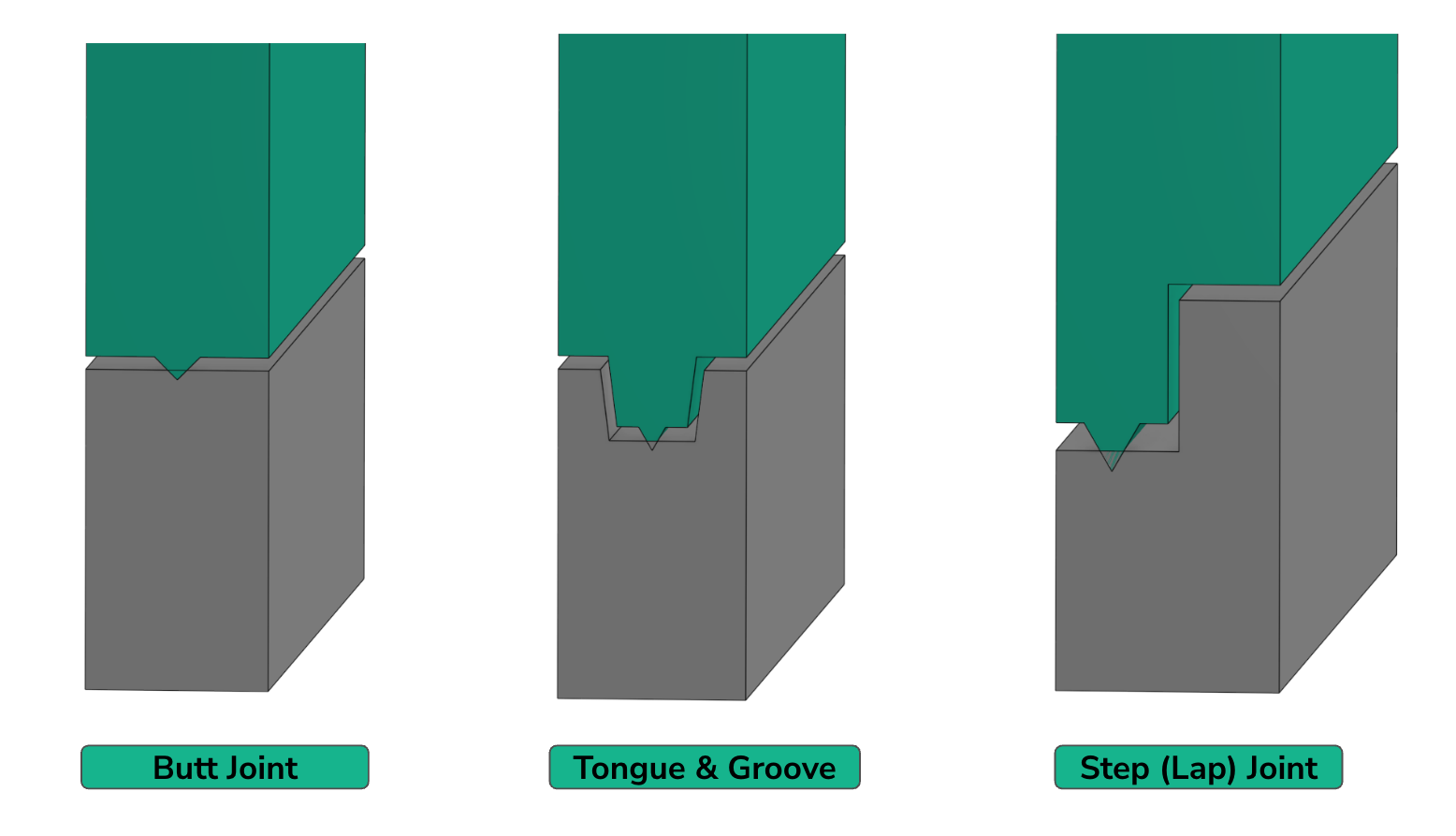

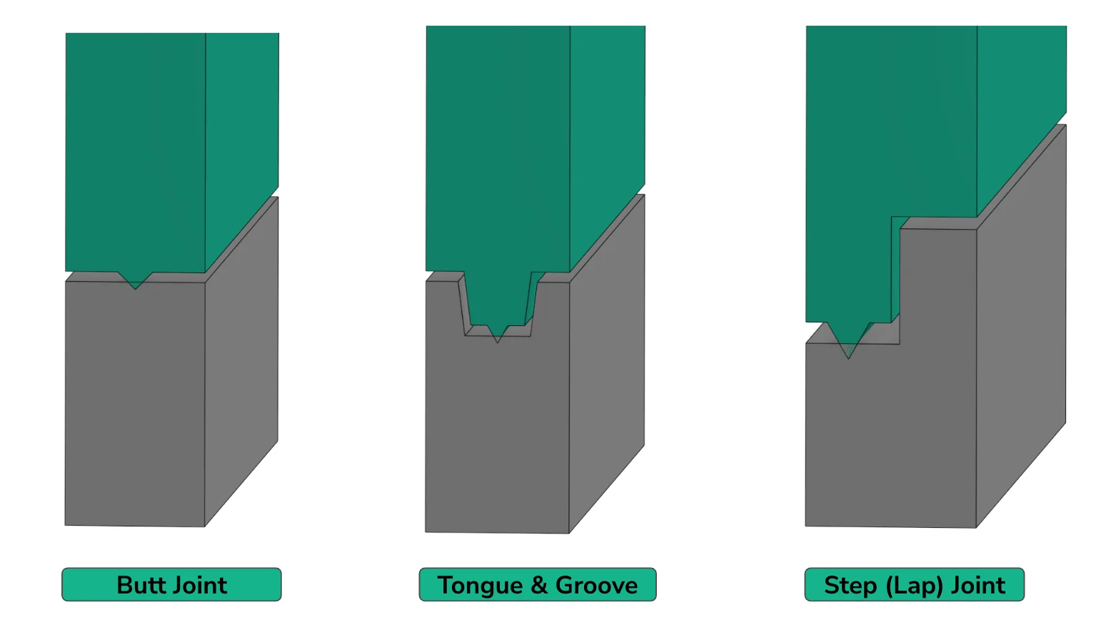

Joint Geometries
The geometry of the joint plays a major role in alignment, aesthetics, and weld performance. While some joint designs are used across many welding processes, in ultrasonic welding, certain shapes are preferred and others are avoided. Commonly used geometries include:
  • Butt Joint: Two flat surfaces pressed together. Simple and inexpensive, but with lower peel strength; best for sealed joints under light loads.
  • Shear Joint: One wall overlaps another, so vertical movement during welding creates a shear force at the interface. Provides high strength, especially for semi-crystalline plastics.
  • Step Joint: One part includes a step feature into which the other part fits, improving self-alignment and producing cleaner external cosmetics.
  • Tongue-and-groove Joint: A protruding tongue fits into a groove on the mating part, offering mechanical interlock, improved alignment, and reduced flash.
Avoid large flat interfaces with no features to concentrate energy, as they make melting difficult to control. A good joint should provide precise alignment between parts, concentrating energy (via energy directors or overlapping walls), and control over flash and aesthetics.
Joint geometries for ultrasonic welding
Figure 3 Joint geometries for ultrasonic welding
