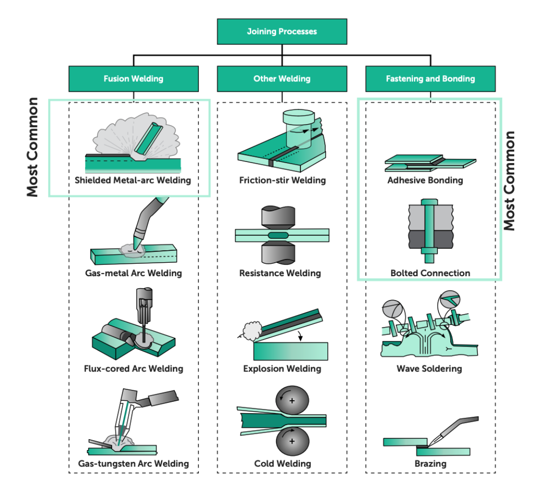

Methods of Joining Metal Assemblies
Joining methods define the performance, cost, and serviceability of a metal assembly. Below are the most common techniques and their engineering trade-offs.

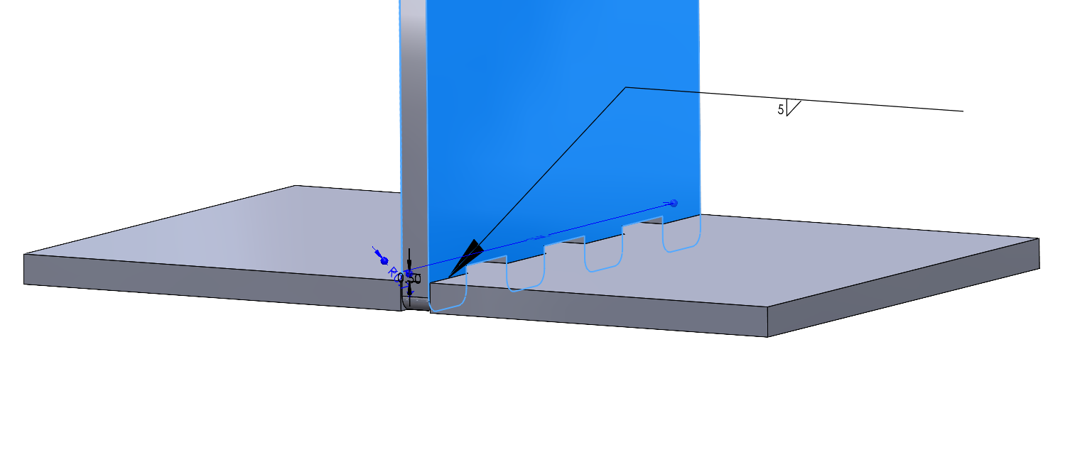

Welding
Welding permanently fuses metal components using localized heat (and sometimes pressure) to form a metallurgical bond. Common processes include:
- MIG (Metal Inert Gas): Fast, economical, ideal for thick or structural materials
- TIG (Tungsten Inert Gas): High precision, excellent for thin sections and stainless steels
- Spot Welding: Widely used for sheet metal assembly in automotive and electronics

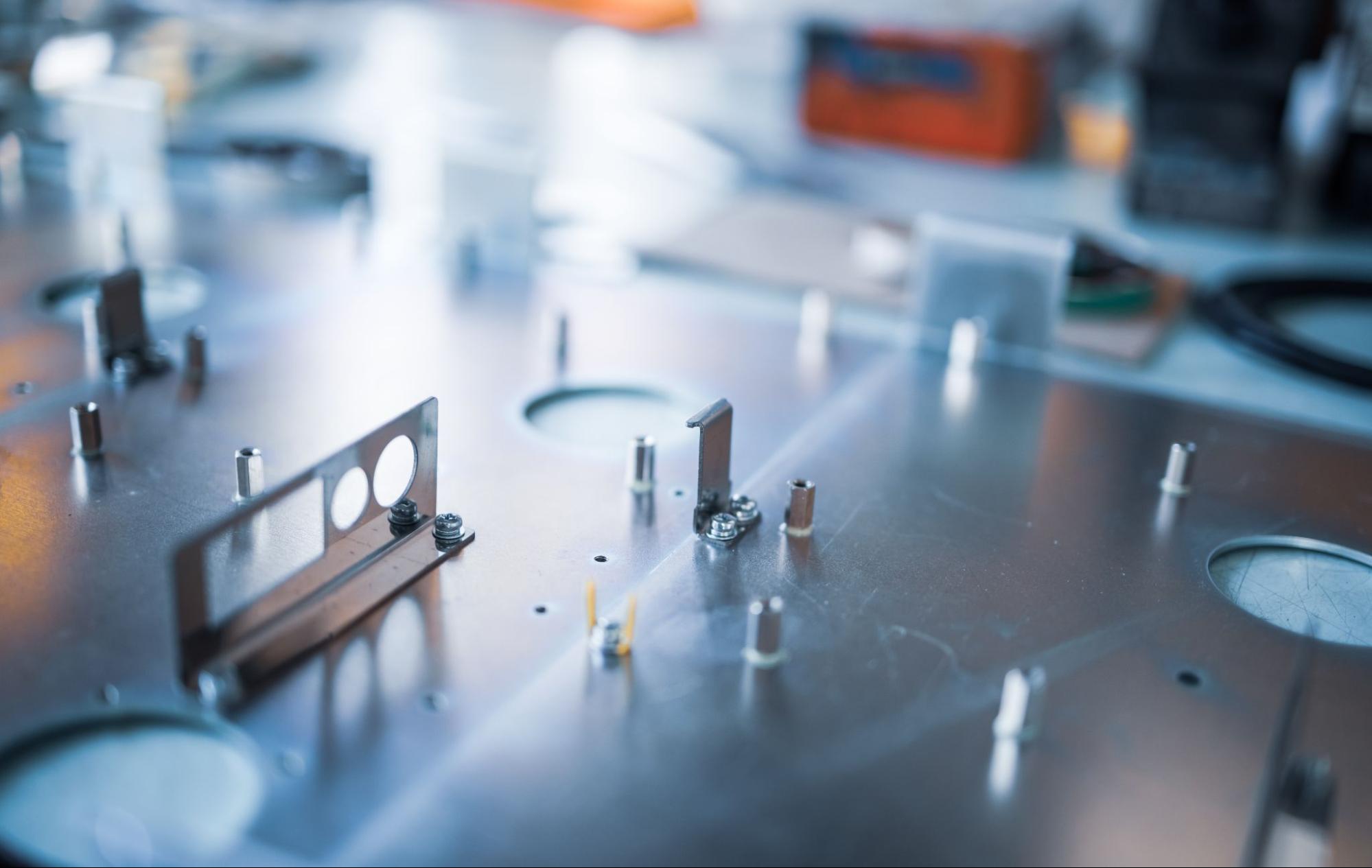

Mechanical Fasteners (Bolts, Screws, Rivets, PEMs)
Mechanical fastening is the most versatile joining approach, using hardware components such as bolts, screws, rivets, or self-clinching fasteners (PEMs) to create either permanent or serviceable joints.
- Bolted assemblies allow disassembly for maintenance or upgrades.
- Rivets provide lightweight, permanent joints for sheet metals and structural skins.
- PEM fasteners (nuts, studs, standoffs) embed directly into sheet metal for strong, flush hardware integration.

Adhesives and Bonding
Adhesive bonding joins metals using specialized epoxies or structural adhesives that cure to create a strong interface.

Soldering and Brazing
Both soldering and brazing join metals by melting a filler metal between components without melting the base parts.
- Soldering occurs below 450 °C, ideal for electrical and electronic assemblies.
- Brazing occurs above 450 °C and is used for structural or pressure-bearing joints.

- Tabs and Slots: Align and hold parts during welding or fastening. Common in sheet metal brackets and housings.

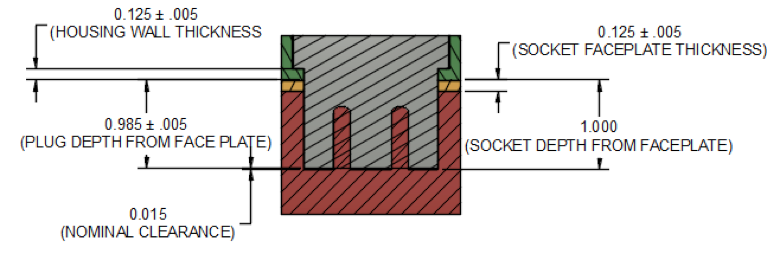

Tolerance Stack-Ups
Every manufactured component comes with dimensional variation. When assembling several parts, these small deviations accumulate, known as a tolerance stack-up, potentially leading to gaps, binding, or misalignment. Engineers must define proper datum structures, apply geometric dimensioning and tolerancing (GD&T), and model worst-case scenarios in CAD. Controlled tolerance allocation ensures consistent assembly performance without excessive cost from over-specifying precision.
