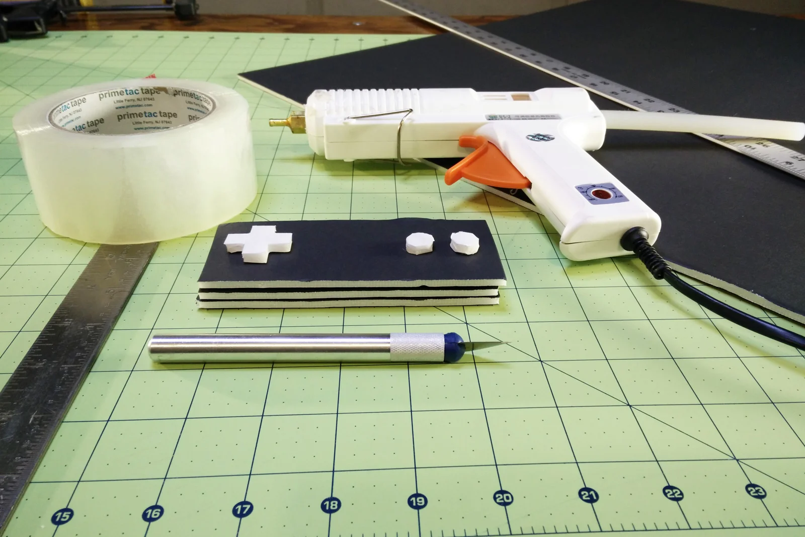

Supplies
Supplies for foam-core joining techniques
Supplies for foam core joining techniques
First, these are the supplies I’m using for this guide:
The foamcore used in all the examples pictured is Readi-board, which is manufactured in the US by Adams manufacturing for hobbyists, picnic goers, and even home remodelers. It can be purchased in bulk online, but I picked up my sheets for $1.25 a piece at my local Dollar Tree store. The sheets typically come in a 20” X 30” size and are slightly less than a quarter of an inch thick.
These are the tools I’m using:
  • Hot glue gun
  • Ruler
  • Clear packaging tape
  • Pencil
  • Exacto knife or box cutter
  • Thermal gloves.
That’s all you need!
Also, I recommend using a knife with an easily replaceable blade — a fresh, sharp edge makes the process go much more smoothly — no one wants to battle a dull blade that does more tearing than cutting.

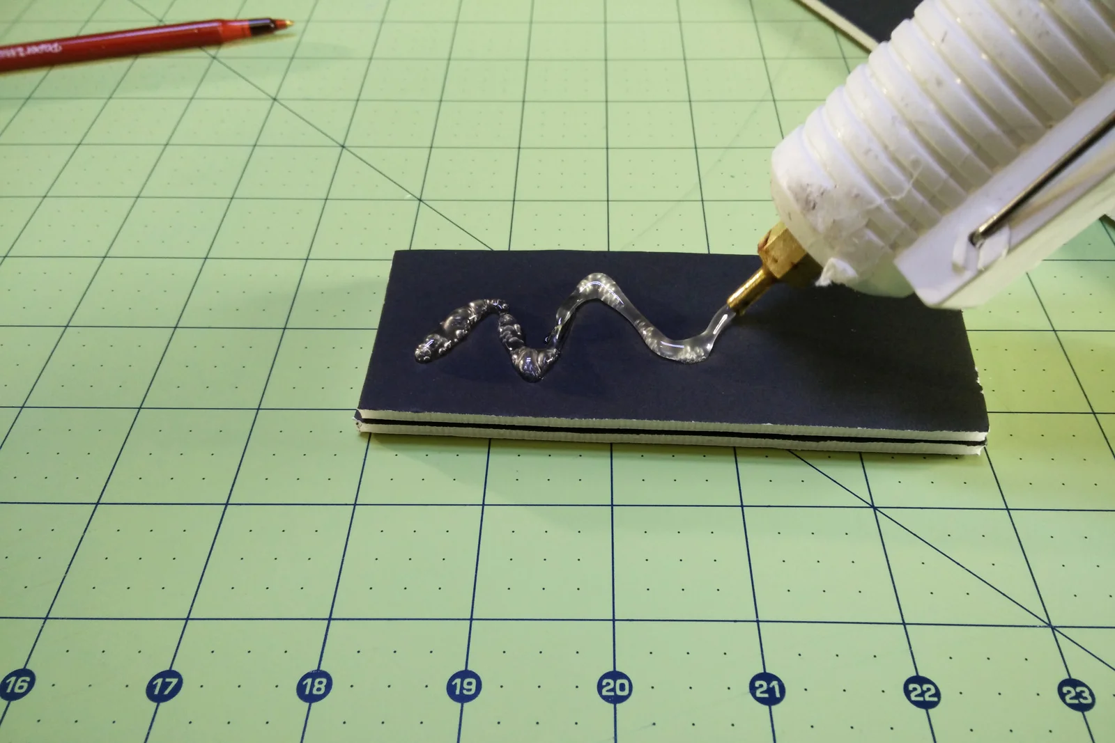

Joining With Hot Glue
Using hot glue to join panels together
Have you seen those viral 5-minute craft videos where they try to make EVERYTHING out of hot glue? We aren’t going to those extremes, but hot glue is ideal for assembling foamcore prototypes. It’s quick, cheap, and easy to use, much like foamcore.
Glue can join panels together or hold a corner joint closed. Any hot glue gun will do the trick, but if you go with a Dollar Tree model, you’ll do a lot of work.
Instead, splurge on a higher-power glue gun with adjustable temperature settings and around 100 watts of power — then you can put down glue as fast as you can pull the trigger.
Adjustability is critical since it lets you control how long the bond is workable. If you have a long seam, you’ll want more time to fill it, spread the glue evenly, and then maneuver the pieces into position. If you’ve ever crafted before, you know the frustration of glue drying before you can adequately position things.
Clamps are also helpful when doing glue-ups, but anything heavy will most likely get the job done. The technique I use the most often is just to hold the joint in position by hand while waiting for the glue to harden — it’s simple but effective!
Note: Always use caution when handling hot glue guns or cooling glue. Glue out of a glue gun can reach 380 ℉. For reference, you can get third-degree burns from exposure to a liquid at 150℉. So, use protective, heat-resistant gloves when handling hot glue guns.

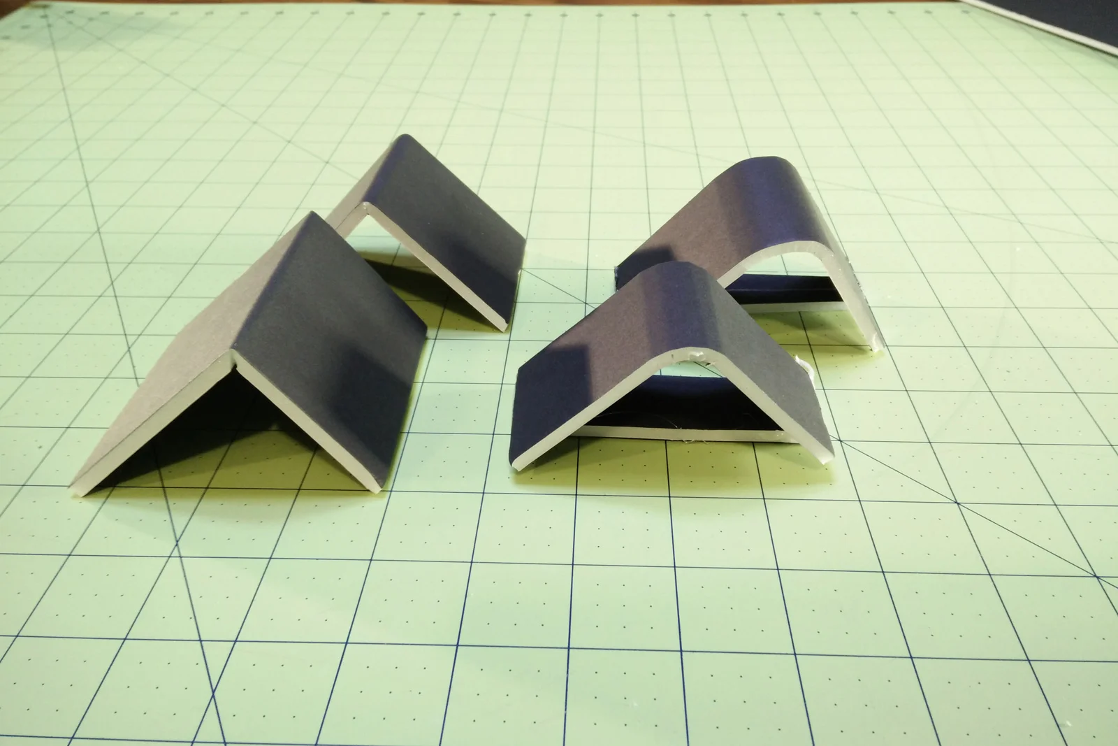

If you’re looking to model different style corners, there are a few techniques you can use:
Different techniques can produce corners with varying radii.
‍‍Different techniques can produce corners with varying radii
Gentle Corners
You can create soft corners by removing the paper on the backside of the joint and working it into shape by hand (see the example corner in the back right above).
For more control, you can create several small kerfs on the backside. If you adjust the spacing and width of the cut, this will also afford you more control over the uniformity of the corner’s radius (see the front right example above).

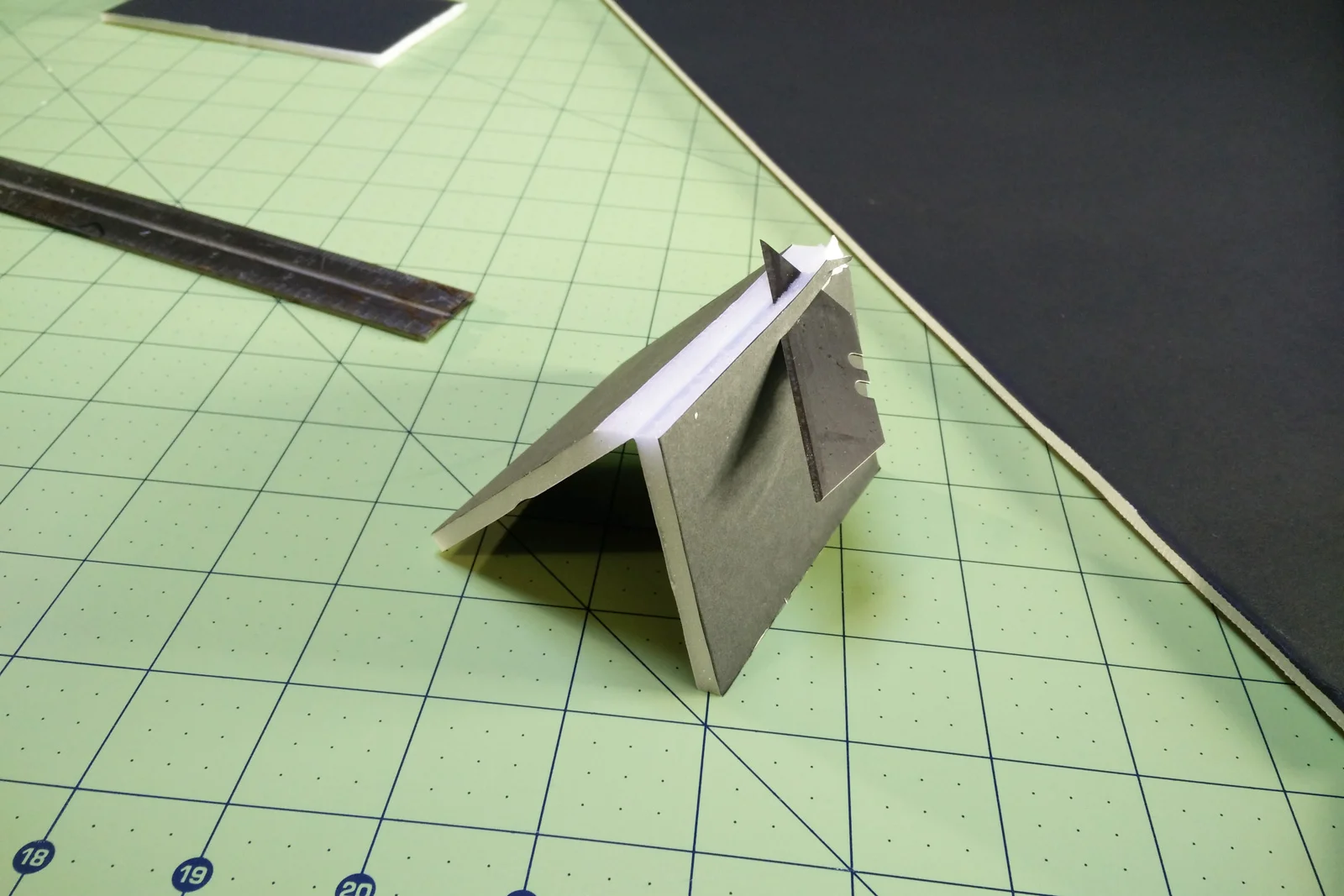

Sharp Corners
If you want a tight corner, you have a couple of options:
First, you can remove the material with a chamfer on the back side, which will give you the sharpest corner, as shown in the fr, as seen in the left rear example aboveont left example above. Alternatively, you can score the backside with a blunt object to get a corner.
The top example has been chamfeCutscored.
‍‍The top example has been chamfeCutscored
To create a sharp corner cut through the backing paper and the foam to produce a sharp corner, but leave the outside facing paper intact. Then chamfer both sides on the back at 45-degree angles.
Do a test fold of this corner to ensure you’ve removed enough material, and once you’ve done the test fold, open the joint back up and fill it with hot glue, using a scrap piece of foam to help spread the glue evenly across the joint. Presto! You now have a perfect right angle.
sharp corner example
‍A sharp corner can be created by removing the foam from the inside of the corner

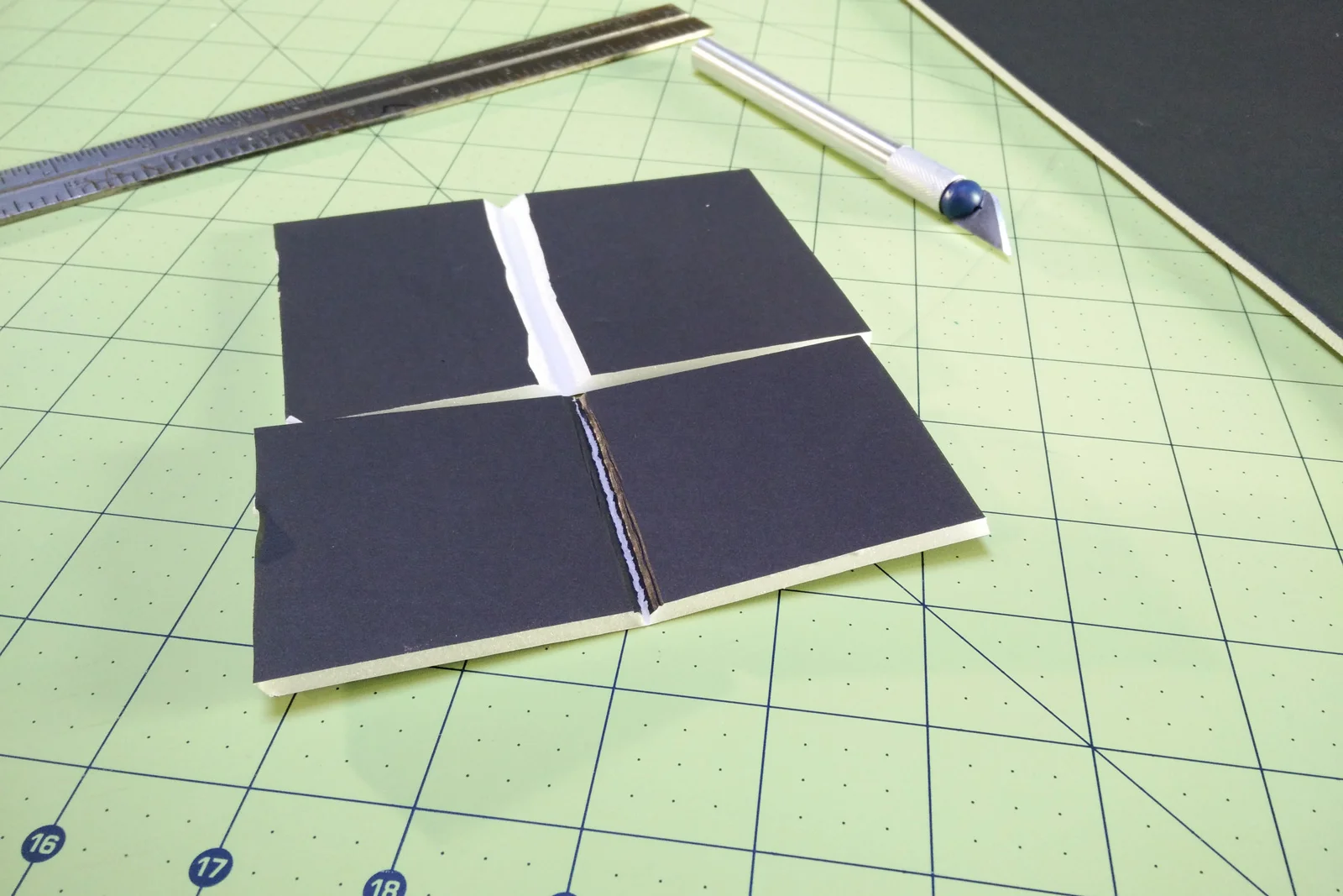

Flexible joints
A flexible or living joint can also be made using a process similar to creating a sharp corner. However, instead of filling the joint with hot glue and leaving it at a 90-degree angle, leaving it open with the outward-facing paper down and reinforcing the backside with thin, clear packaging tape works well here.
