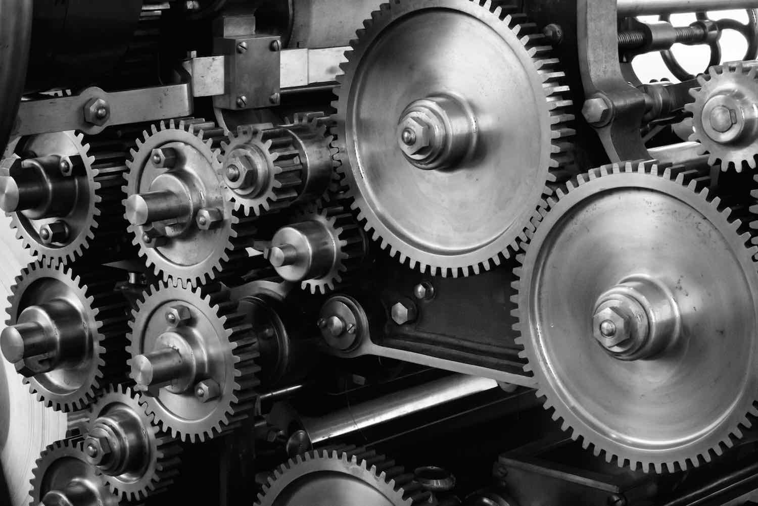

Friction is one of the five contact forces along with tension, spring force, normal force, and air resistance. Friction is what gives us traction on the road, good brakes, and allows us to walk without looking like a baby giraffe. But sometimes we just want to let things slide, and that’s when friction frustrates — engines seize up, stuck bolts, and old grandfather clocks frozen, never to chime again. Now, as engineers, we absolutely need friction (and sometimes we need less of it), but we also need to design for it to be consistent.
When dealing with gears, we want parts to slide over each other easily. But in the same assembly we may need two parts to move smoothly using controlled friction. So, how do you control the friction in your assembly of moving parts? First, let’s start with a physics lesson and review the basics of friction.
