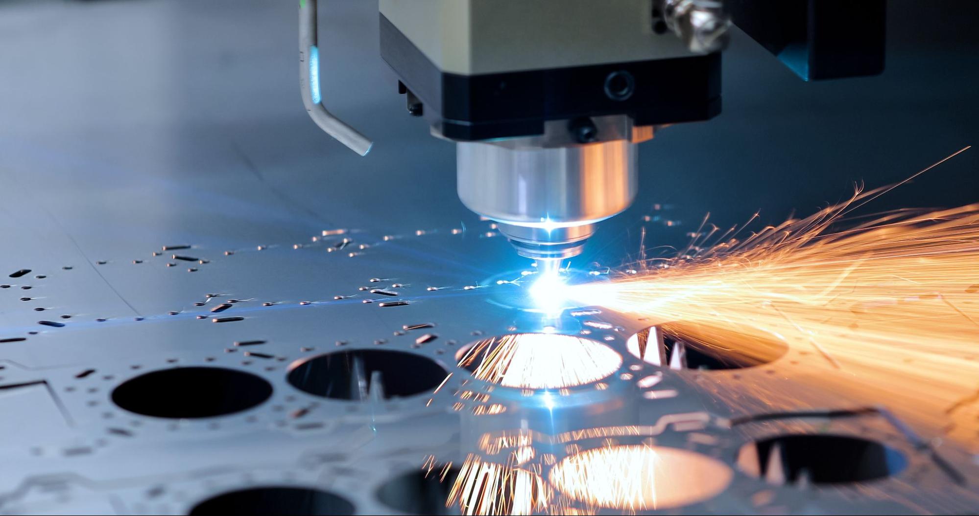

How Metal Laser Cutting Works (Step by Step)
Laser cutting begins with a design layout created using a CAD (Computer-Aided Design) software program, which generates an output file typically in 2D format. Some laser cutters can still use 3D models by slicing them into 2D layers.
The file can be loaded into a laser cutting software program, which will assist in setting the correct laser settings, such as power and speed, and define the toolpath the laser will follow. This laser cutting program will also be used to generate the machine instructions uploaded to the laser cutter. Here’s how a typical workflow looks:
  • Engineers upload a 2D drawing file (typically .dwg, .dxf. .eps, or .ai format).
  • The file is converted into machine-readable instructions via CAM software.
  • A flat, metal sheet is placed on the cutting bed.
  • The laser beam is precisely focused on a fine focal point.
  • The laser cutter’s CNC software directs the laser path to cut or engrave.
  • Oxygen, nitrogen, or air blows molten material away for clean cuts.
  • Heat is managed with built-in ventilation.

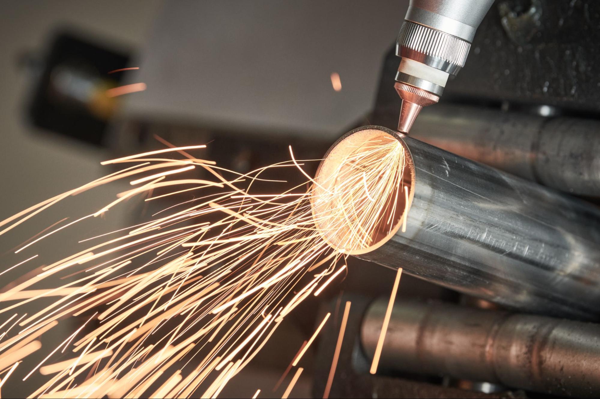

Fiber laser cutting a round metal pipe.
