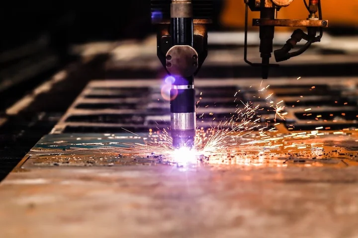

![Plasma Cutting in Action](https://www.fictiv.com/wp-content/uploads/2023/04/Plasma-Cutting-in-Action.jpg)

Plasma cutting refers to a thermal cutting technology designed to produce 2-dimensional profiles out of a thin sheet or plate made from a conductive material. Contrary to popular belief, plasma cutting is actually useful for producing complex cuts and complex parts and is especially well-suited for curves and circles. This complex shape-cutting ability is achieved by generating high-temperature plasma, which melts through the conductive metal while a drive system moves the plasma torch around the plate to trace out the required shape. In other words, the parts are held in shape while the cutting tool moves around the surface of the parts.
Hot molten slag is ejected from the cut using the compressed gas used to generate the plasma arc. Plasma cutters are often considered a less-expensive alternative to laser cutters but can still achieve good edge quality, especially with thinner sheets. For thicker sheets, the cut edge is not always as clean as with laser cutters. Plasma cutting is also an improvement over oxy-flame cutters in terms of edge quality and cut precision.

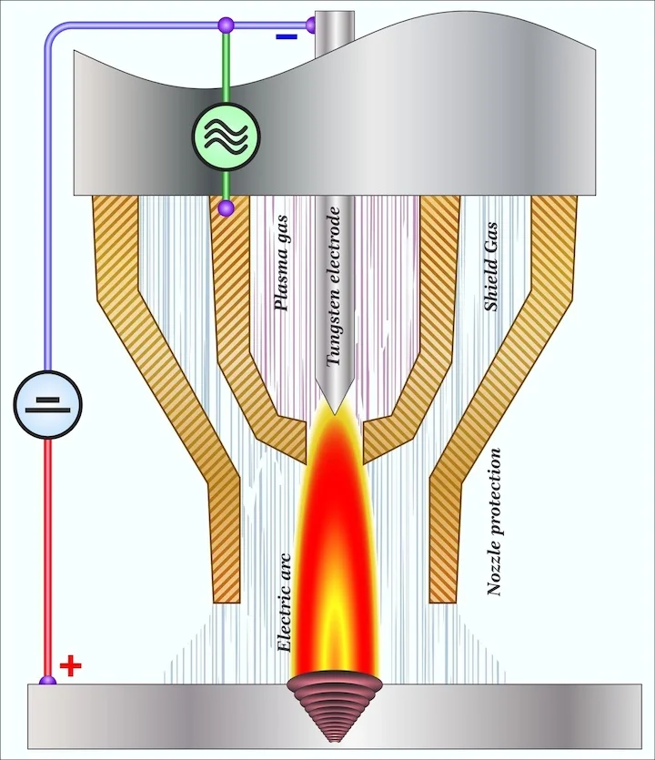

To create the plasma, an electric arc is created when a high voltage is introduced in an electrode that is situated inside the cutting head, known as a pilot arc. At the same time, a gas is introduced into the nozzle in the area between the electrode and the plasma torch body. As the gas contacts the arc, it is heated to the point where it becomes plasma. This plasma then flows down the cutting head and out of a nozzle. The arc follows the path of the plasma until it contacts the base metal. This allows the electric circuit to complete, and a constant arc is maintained, which ionizes new gas as it is fed through the nozzle. This is why plasma cutting is only compatible with conductive metals, like steel, stainless steel, aluminum, brass, and copper.
When the high-pressure plasma is directed out of a nozzle, there is an increase in its velocity, which helps eject the molten material from the cut. To contain the plasma in a tight circle, a shielding gas or liquid is ejected around the plasma nozzle, which keeps the plasma contained in a focused point for optimal accuracy. There are generally two types of arc generation techniques used with CNC plasma cutting, as described below:
- Pilot arc: The pilot arc method creates an electric arc inside the cutting head. This pilot arc creates some plasma that helps connect the arc to the workpiece as the highly conductive plasma flows through the nozzle. This method is most commonly used on CNC plasma cutters.
- High-frequency contact: A high-frequency spark is created when the nozzle touches the workpiece. Once a spark is generated and sufficient plasma has been created, the nozzle can be lifted, and cutting can commence.
![Figure 2: Basic Layout of a Plasma Nozzle](https://www.fictiv.com/wp-content/uploads/2023/04/Plasma-Nozzle.jpg)

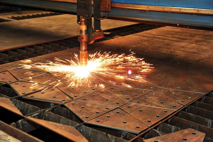

![A CNC plasma cutter cuts parts out of steel sheet stock](https://www.fictiv.com/wp-content/uploads/2023/04/CNC-plasma-cutter-cuts-.jpg)

- Your parts will then be removed when the part the cutting is complete. There will usually be some slag attached to the cut edges that can be removed either with a slag hammer or by making use of a grinding wheel. Some manufacturing facilities have dedicated part cleaning operators to perform the tedious process of deburring parts.
