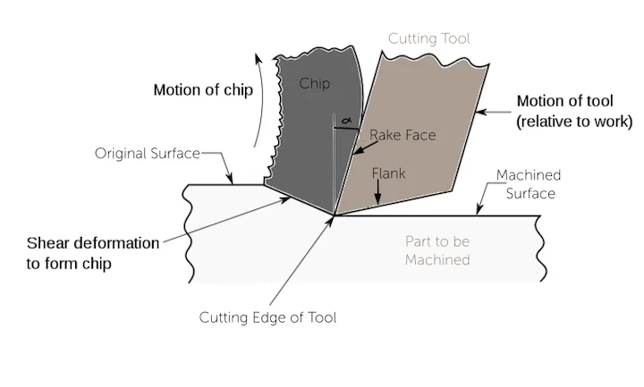

The rake angle is a pivotal part of the design of a cutting tool. It is defined as the angle of the face of the cutting tool in reference to a line that is perpendicular to the feed direction. There are three main types of rake angles:
- Positive
- Neutral (sometimes called zero)
- Negative
Various rake angles can be measured from different reference planes. However, machinability is typically measured at the true rake angle—the rake angle on which the chip slides. For single-point turning tools, this is often the side rake angle. There are generally radial rake and axial rake angles for milling cutters. See Figure 1, which illustrates the rake angle for single-point turning tools, with a positive rake angle on the left and a negative rake angle on the right.
![Figure 1: Rake Angle Illustration](https://www.fictiv.com/wp-content/uploads/2023/10/Rake-Angle-Illustration.png)
Positive Rake Angle
A tool has a positive rake angle when the sum of the flank or relief angle Figure 2 and wedge angle is less than 90 degrees. Ultimately, this means the tool has a sharper edge because it comes down to a point, and the tool face is angled toward the workpiece. This allows for the removal of material via shearing. A positive rake angle is better suited to cutting ductile materials like low-carbon steel, copper, and aluminum.

A tool has a negative rake angle when the sum of the flank and wedge angle is larger than 90 degrees. This means the tool has a supported cutting edge because it has a large wedge angle when compared to a positive rake angle tool. These types of tools also remove material using a compressive and shearing action as the tool plows through the material. A negative rake angle is better suited to cutting brittle materials like high-carbon steel.
