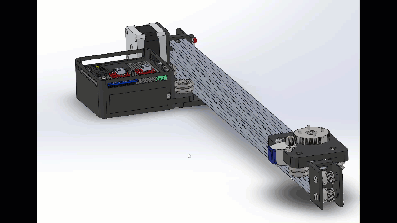

Starting with a Simple Example: Linear Rail

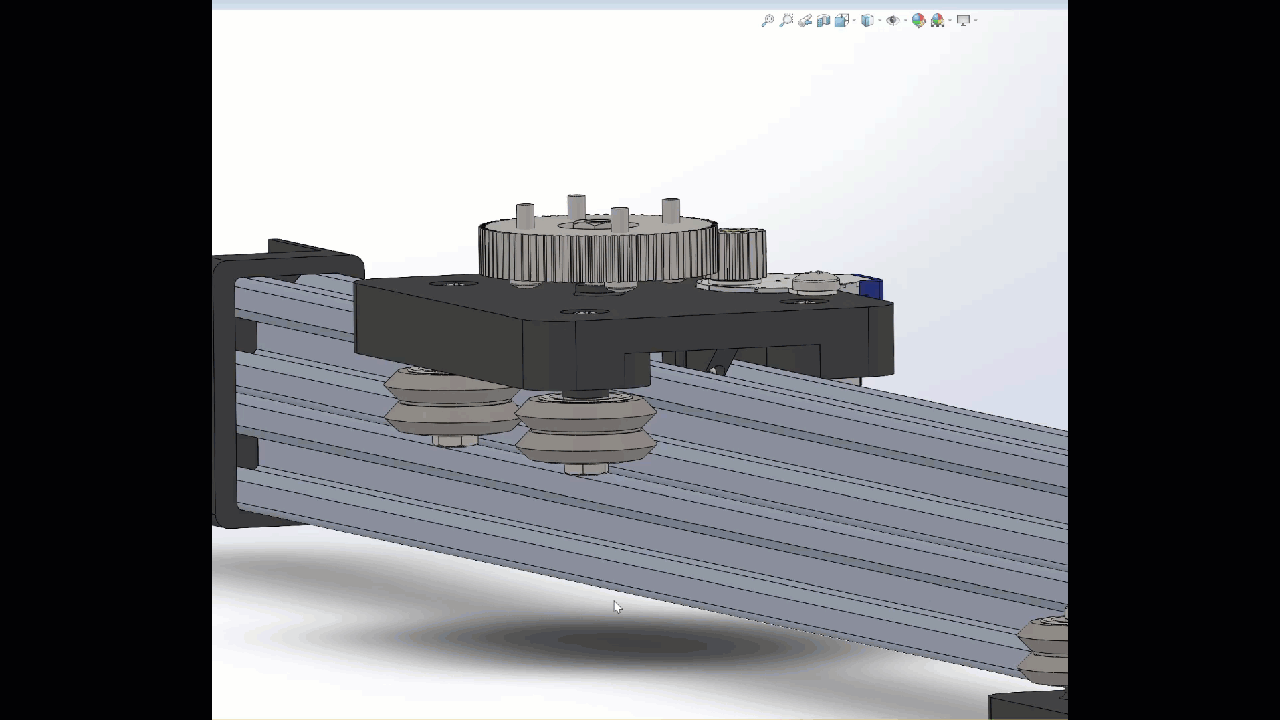

Here’s some example CAD to help us start to break down the tolerance stack process: a linear rail from  GrabCad. So let’s pretend we need to do tolerance stacks for this assembly — where do we start (and remember this is more about a process to yield repeatable results for you as a design engineer)?
gif of assy
Figure 1 GIF of Assy
Break Down the Subsystems

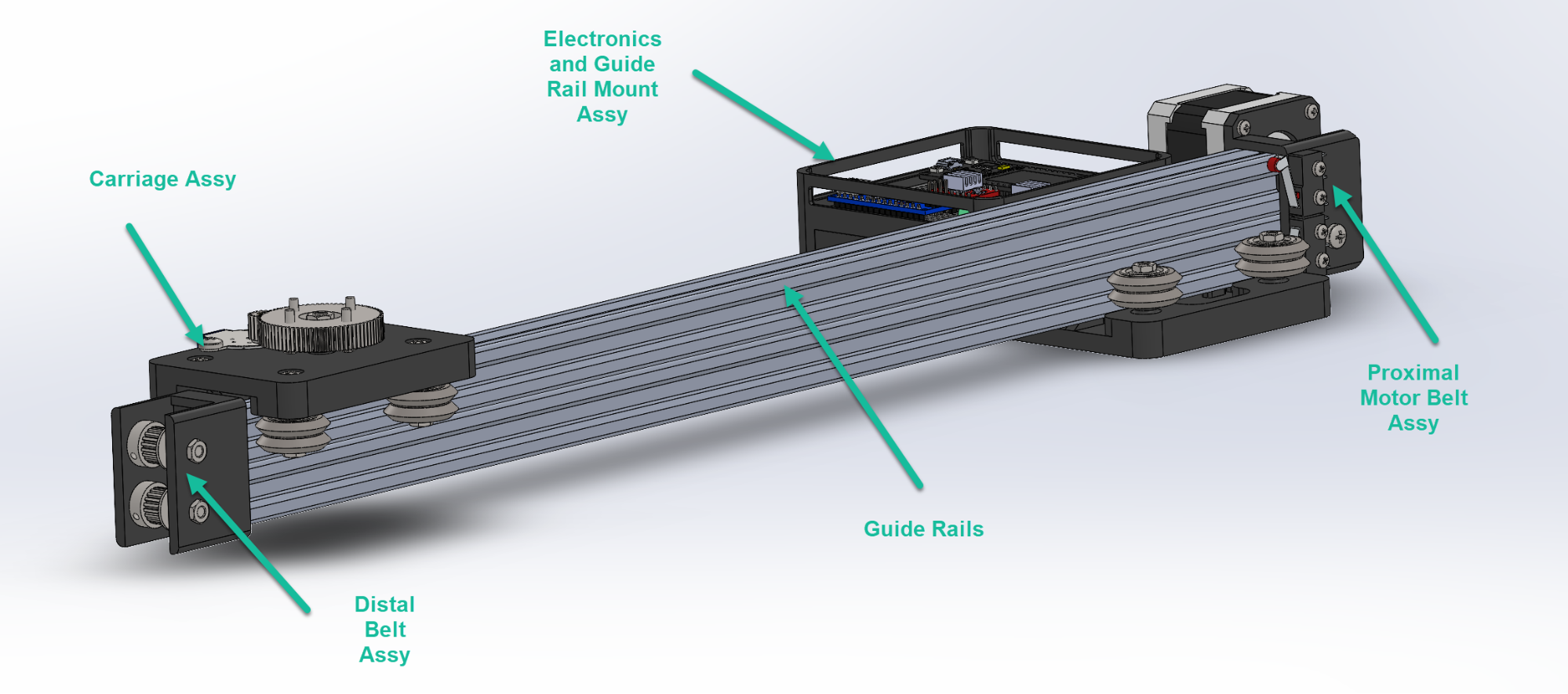

The first thing I like to do with a big problem is to break it down into a series of smaller problems, or subsystems. How do you do this? Sometimes there is a super logical method and some days you just pick something and start. Today, we be doin’ it live folks (Lee-Roy Jenkins!) so let’s just jump in.
In the figure below you can see the subsystems for this linear rail:
Subsystem Breakdown
Figure 2 Subsystem Breakdown

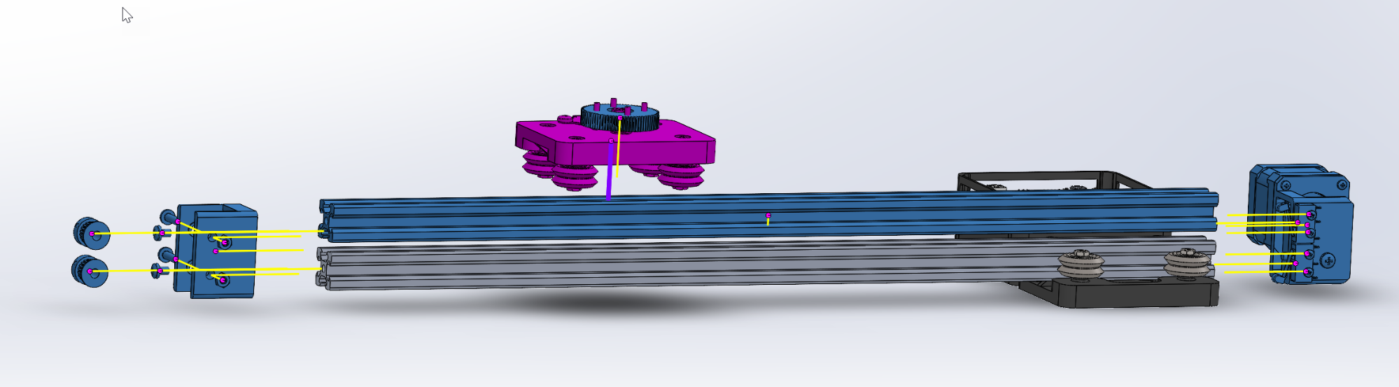

From this quick breakdown I see at least a few obvious interactions between the top rail and other parts.  You can also use the “exploded view” inside Solidworks. And once again, remember you are just trying to get an understanding of what’s going on with the assembly as a starting point.
Exploded View interactions
Figure 4  Exploded View interactions

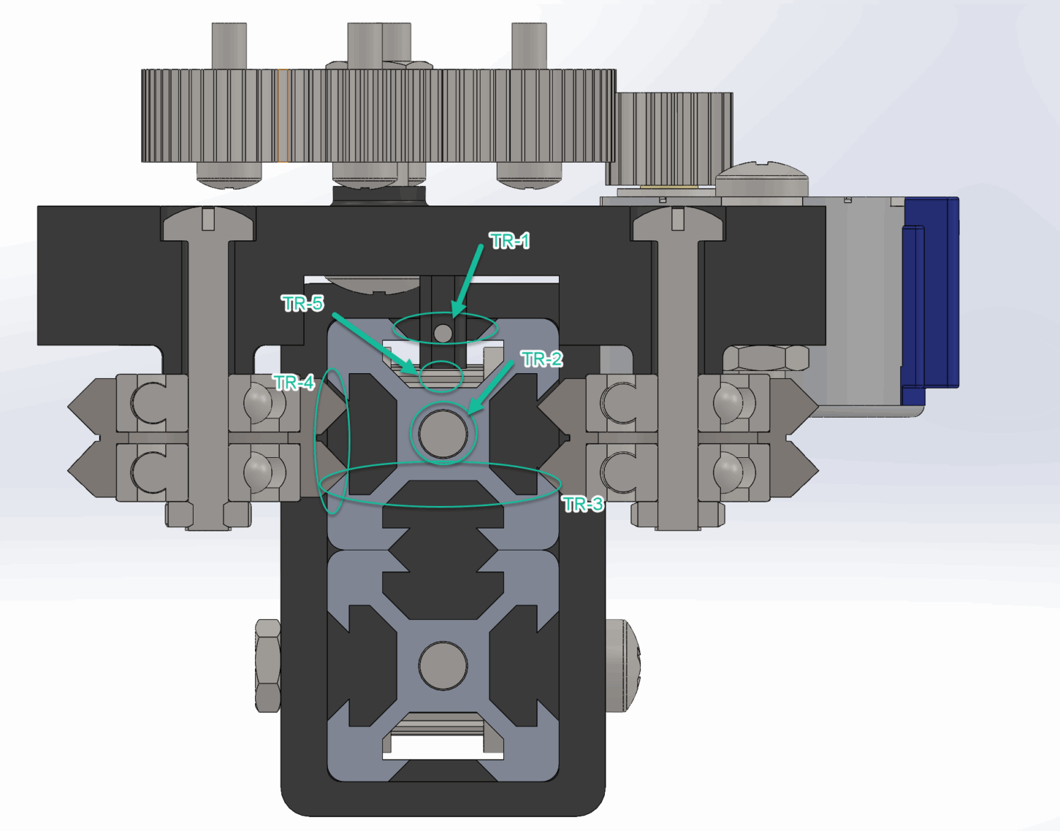

Once you’ve set up a simple interaction image you want to lay out which interactions need a tolerance stack by looking at each interaction line. There’s a good chance that there is a tolerance stack in the interaction line. Another good reason to use this method is that it will also help you and your quality engineer from doing duplicate work on your DFMEA (Design Failure Modes Effects Analysis).
Let’s start by looking at the chassis (purple image) and the top rail. If you are doing a tolerance stack, you are attempting to mitigate a risk so take credit for it! Risks are mitigated via a hand calculation, a simulation, or a test (sometimes all three of these, depending on risk).

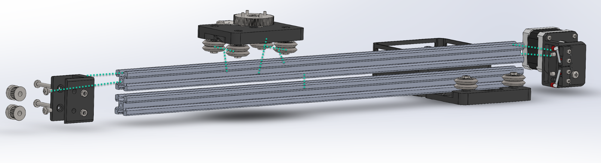

Determine Deeper Interactions
Below I take a cross section for an area of focus and start thinking about what could potentially go wrong or where there are deeper interactions.
cross section tolerance stack ups
Figure 5 Cross section
GIF of Cross-section plane
Figure 6 GIF of Cross section plane
Create Your Tolerance Stack Score Card
Next, create a table as the basis of each tolerance stack “score card.” This will ultimately be a big list of tolerance stacks that could result in some type of risk relative to the design—either function or simple assembly.
Tol Stack NameDescriptionFailure(s)Tol Stack CpK
TR-1Top rail groove width to chassis base guide fin widthFin width too wide — could not fit in TR Groove; causes grinding on rail to chassis base;fin too narrow – n/a2 part fit
TR-2Top rail center thread to screwScrew won’t fit or wont thread2 part fit
TR-3Top rail wheel bevel surface width to chassis bevel wheel spacingToo narrow — chassis can fall off track;Too wide — chassis won’t move or won’t move smoothlyTBD
TR-4Top rail wheel bevel surface width to chassis bevel wheel heightToo narrow — chassis won’t move or won’t move smoothly;Too wide — chassis will sit lower than expected (could cause collisions or fall off track)TBD
TR-5Top rail inner center beam surface to bottom of chassis fin clearanceFin too tall — chassis won’t move or won’t move smoothly;Fin too short — n/aTBD
Table 1: Tolerance Stack Score Card
Note: In reality, the top rails and chassis in this example are all off-the-shelf components, so the need to do this would be moot for a CpK analysis. Just treat this as an example!

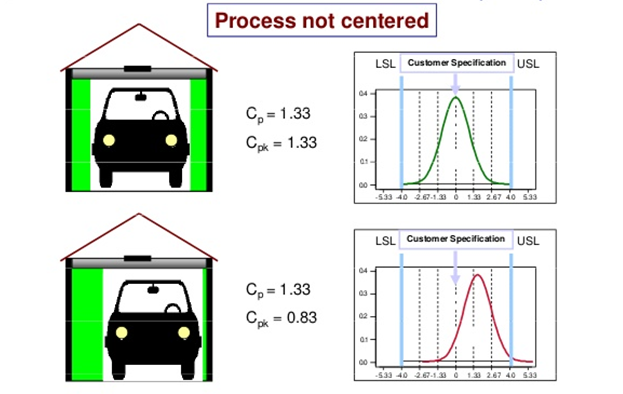

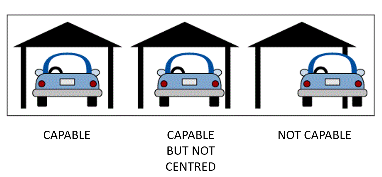

In this example, the garage defines the specification limits and the car defines the output of the process. If the car is only a little bit smaller than the garage, you had better park it right in the middle of the garage (center of the specification) if you want to get all of the car in the garage.
If the car is wider than the garage, it does not matter if you have it centered; it will not fit (Cpk lower than 1).
If the car is a lot smaller than the garage (Six Sigma process), it doesn’t matter if you park it exactly in the middle; it will fit and you have plenty of room on either side.
If you have a process that is in control and with little variation, you should be able to park the car easily within the garage and thus meet requirements.
Cpk tells you the relationship between the size of the car, the size of the garage and how far away from the middle of the garage you parked the car. The value itself can be thought of as the amount the process (car) can widen before hitting the nearest spec limit (garage door edge).
Cpk = 1/2 means you’ve crunched nearest the door edge and those mirrors are gone (ouch!)
Cpk = 1 means you’re just touching the nearest edge (the mirror)
Cpk = 2 means your width can grow 2 times before touching
Cpk = 3 means your width can grow 3 times before touching

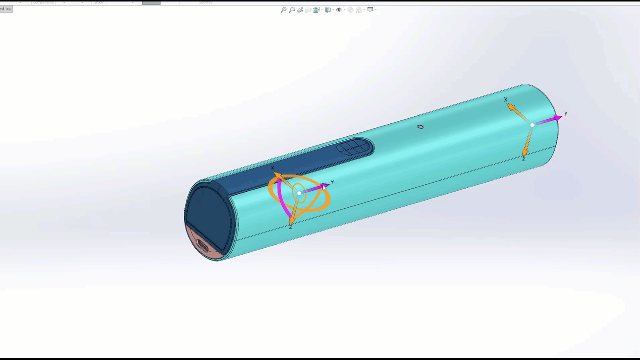

My friend Zach from Sonny has allowed me to share some images from his product that’s moving along in development (check out his indiegogo here).
Sonny Portable Bidet
The product has been having difficulty sliding a fluid canister into the device. See GIF and zoomed in image of cap below.
Sliding action of canister into housing (left)
Figure 10 Sliding action of canister into housing left

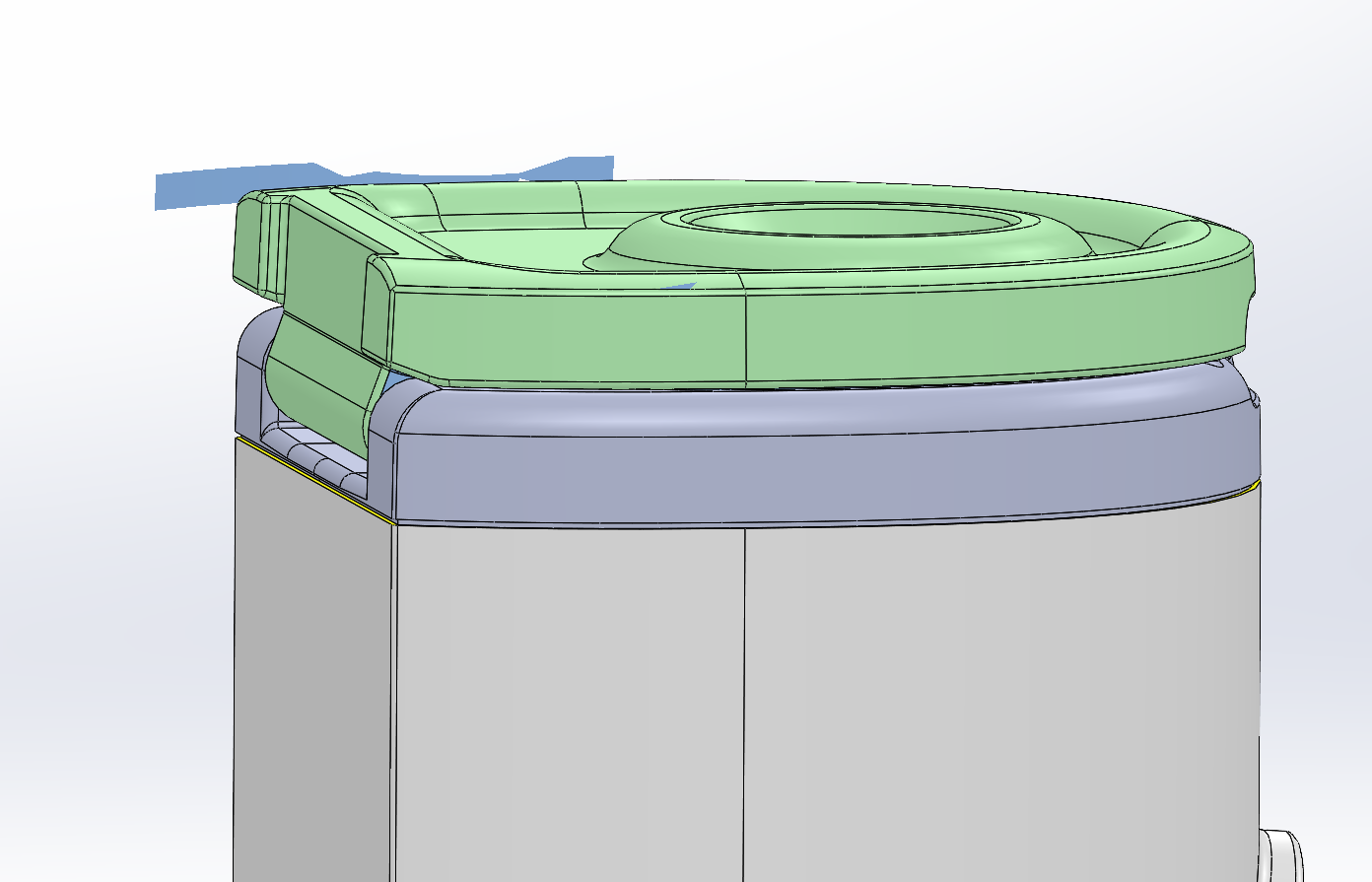

Canister (grey), collar (dark gray), lid (green)
Figure 11 Canister grey collar dark gray lid green

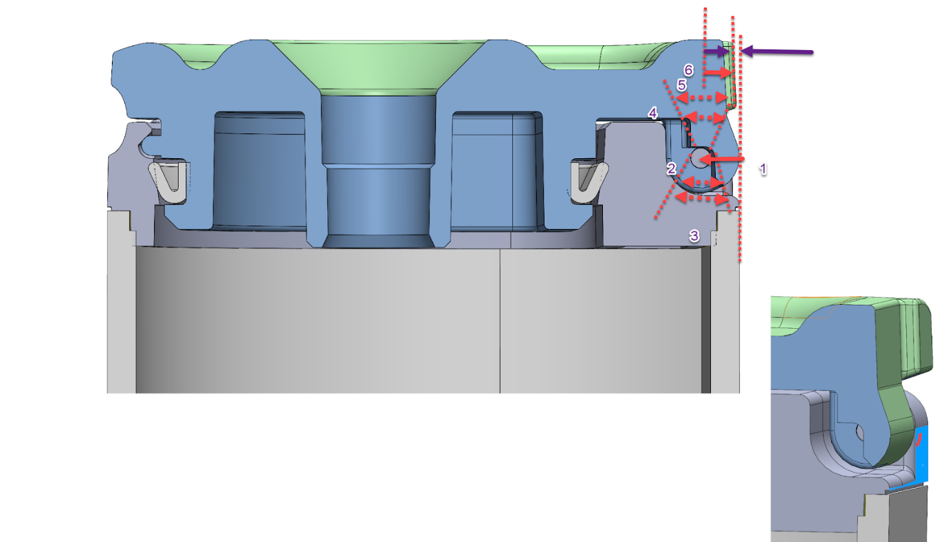

Step one here is to do a tolerance stack as a root cause; the phenomena has been seen that the canister jams/gets stuck or is hard to translate.
So I have an engineering issue that has an occurrence rate of “probable” (as it’s been seen in the first 10 devices) and if this failure were to occur in a sold product or on the production line it makes the device useless. So from a product perspective this is “serious.”
So moving to the Cpk chart (table 2), I go over to the “serious” column. Looking at the different colors, I want to be in the green zone “Acceptable” or yellow zone “As Low as Possible”. If you can’t get into these zones it likely means either a design change or some type of inprocess step handed to the manufacturing team to mitigate/control the risk is needed. That’s why anything in the orange or red zones requires an internal team/managerial review or a cross functional team review to keep everyone informed and find a solution.
Ain't nothing free folks
Figure 12 Aint nothing free folks
These are my steps in summary:
  • To fully control risk, I should do a calculation and/or a test with the design as-is, to prove progress forward (or do design change to eliminate the issue; sometimes it’s easier to know my tolerance stack from a “calc” perspective is finished if I can get a 1.33 CpK or better).
  • I take a cross section of the canister and show that I don’t want the “green” cap to be able to stick out beyond the sliding surface of the main canister body (shown with my purple arrows).
  • I complete the loop by doing the tolerance stack method.

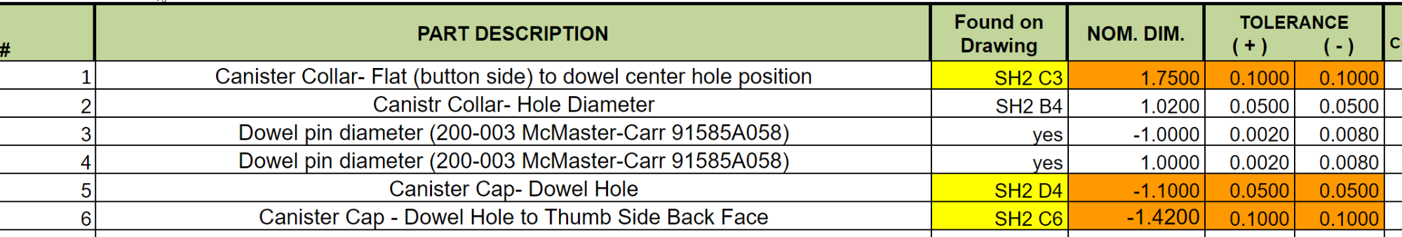

You can download a free spreadsheet workbook here as a template to performance your own tolerance stacks.
Cross section of canister assembly
Figure 13 Cross section of canister assembly
Tolerance stack loop
Figure 14 Tolerance stack loop

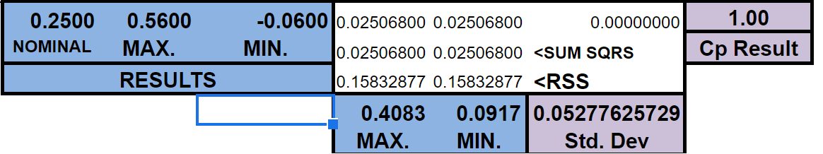

Tolerance stack results
Figure 15 Tolerance stack results
When you do the loops you create your image and you need to remember that you have to pick a direction (in my case for this one, to the left is positive); things that are interference are negative.
In this example, I was taking measures from drawings already created (or CAD if not present) and using the tolerance stacks to review if the drawings had all the applicable information. “Orange“ cells in the table were for me to remember that they weren’t on the drawing—meaning the risk is not being managed. The way to manage the risk would be to add to the drawing. Then the risk is being attempted to be controlled.
In this design you also need to set limits for your Cpk analysis. What’s important to understand when setting the limits is that it is very specific to the direct problem you are trying to solve or the condition you have identified with your arrows. You are looking for a gap and the gap needs to be greater than 0, such that if it were negative the cap would not drag the canister body.
So theoretically if the part was gone, the gap would be infinity but it wouldn’t drag so this is a theoretical solution to the problem. But for this I could have said my USL (upper spec limit) is 5, 1—it doesn’t truly matter as long as it’s greater than 0. So my lower spec limit (LSL) is, well, 0.

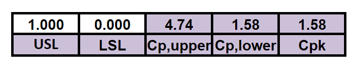

Cpk Results
Figure 16 Cpk Results
From the results we can see that the lower spec limit is being calculated at 1.58. This isn’t quite what I need to retire the risk.
At this point you might be wondering what the numbers inside the chart mean. These are ‘influencers’ and if you were doing a CETOL or vis-vsa analysis, those 3D tolerance stack softwares will tell you by % which dimensions are driving your result. If you use these tools and see something in the box that is equal or greater than 30% in our example, that’s an immediate critical dimension! Once again, your goal is to try to eliminate this issue with engineering drawing controls or a design change.

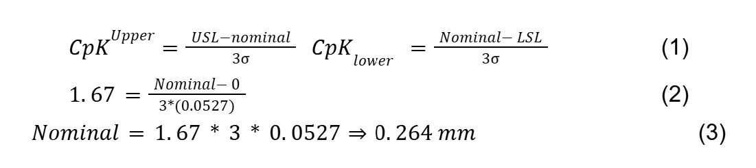

Now that I’ve finagled and messed with my tolerances, I can see I’m not quite getting the desired result. So how do I figure out what I need to do? I back calculate my equation to determine what I need:
CpKUpper=USL-nominal3   CpKlower=Nominal- LSL3 (1)
1.67=Nominal- 03*(0.0527) (2)
Nominal=1.67*3*0.05270.264 mm (3)
Figure 17 Cpk equations As Low as Possible
You now know what your nominal clearance needs to be to drive your design to be in the “As Low As Possible” zone. You could repeat this for Cpk of 2 (nominal = 0.3162mm) and if it doesn’t introduce another risk, do it. Eliminate it and avoid the ‘why’d you do that?’ shame bell look from your manufacturing team four months from now.
