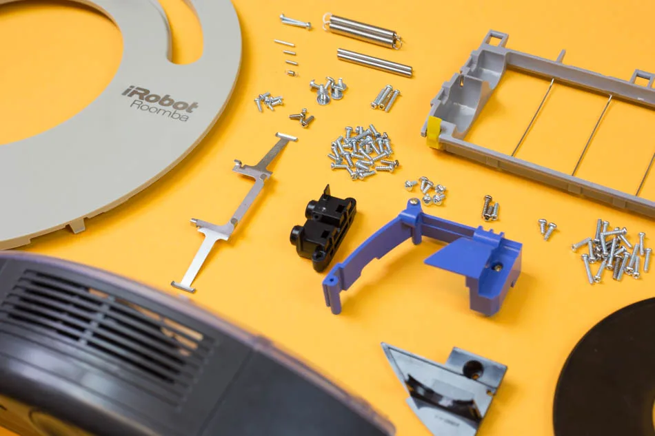

There are many ways to join or fasten plastic parts, and the right method depends on your design goals, materials, and production needs. Options range from simple mechanical fasteners like screws or inserts, to molded-in features such as snap-fits, to adhesives, welding, and other specialty techniques. Each comes with its own strengths in terms of strength, cost, and assembly speed.
Your chosen joining method will likely depend on the manufacturing method, such as machining, molding, or 3D printing. Fictiv’s guide to fasteners for 3D printed parts includes an overview of threaded inserts, self-threading screws, captured hex nuts, as well as how to design threads and cut threads with a tap.
This guide walks through the most common fastening and joining methods to help you choose the best fit for your plastic design, including:
