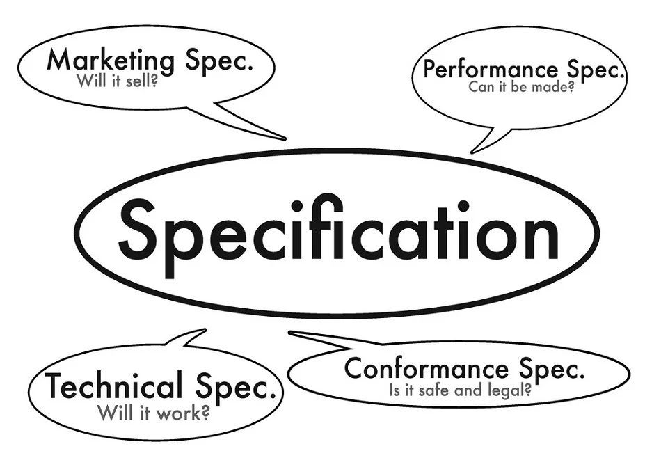

Specification Development
Now that you know where your project is going, you can begin the planning in earnest, and the first phase to plan is the specification development. This is often a phase where it’s easy to skimp, but investing the time up front to create a really good specification document will make every phases afterward smoother, so it’s well worth budgeting enough time to create a really good document with all the necessary research.
![Specification development in product design](https://www.fictiv.com/wp-content/uploads/2020/07/planning-image01.jpg)
What makes a good specification? Pass-fail requirements. Writing a specification is largely a matter of taking soft, fuzzy desired features and translating those into hardline technical requirements. “Lightweight” is a useless requirement; “under three pounds” is a requirement to which you can design.
How long will you need to plan on this phase taking? That depends on the product, but for complex products, this phase can take hundreds of man hours. Plan to research standards for different requirements and possibly to do testing or in-depth research as part of the specification development. These requirements will become your testing standard in later phases, so budget enough time to get this phase right.

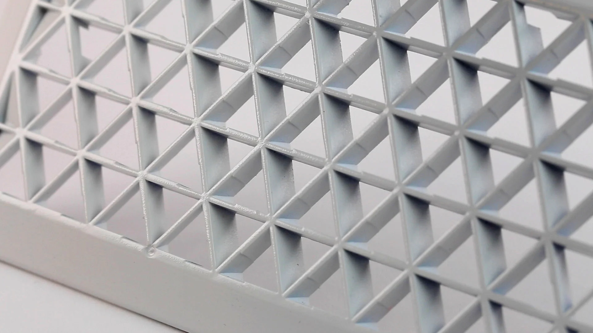

Iterative Refinement
Great designs require multiple rounds of testing and refinement, and you’ll need to build that time into your plan from the start. With more details in our article on testing, keep in mind that even for simple products you should plan on three to four iterations of “prototype-test-refine” for the complete design, before everything feels right and functions well.
