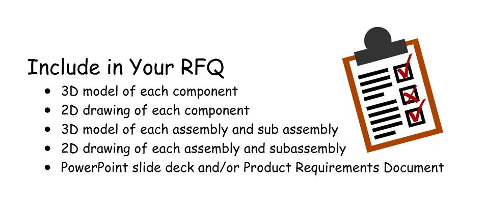

What to Include in Your RFQ Package

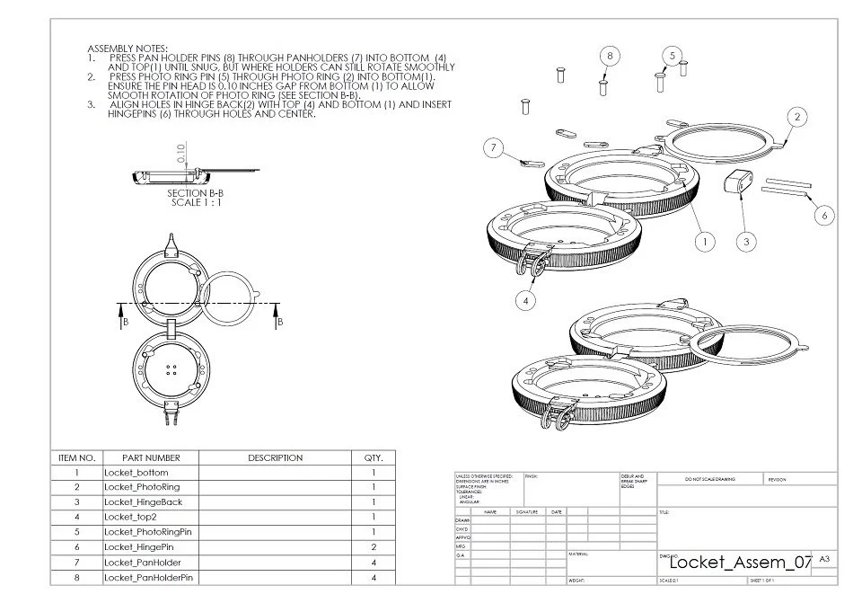

Typically, at a minimum, an RFQ package has both a 3D model of the design and a 2D drawing for each unique, made-to-order component. The 3D model, usually in STEP format, will include all nominal dimensions and all geometrical features, allowing the manufacturer to see what an ideal version of the product would be. Additionally, if your design has specific tolerances or features you need to call out, you’ll also need a 2D drawing in PDF format to let the manufacturer know how much they can stray from nominal dimensions.
If the model has a 2-inch diameter cylinder, is it okay if that comes out at 2.01 inches or 2.10 inches? The 2D drawing will call out all the key or essential dimensions with their maximum allowable variation—these will also be the dimensions measured to make sure the product is being produced according to your design. (Note: It pays to be generous when allowing variation—looser tolerances allow for less expensive manufacturing.)
In addition to these documents for each part, you’ll need the same for each assembly—a 3D model of the assembled components, and a 2D drawing of the parts together, which will include the BOM (as in, “This drawing has a bill of materials listing all of the components needed to make the assembly.”).
![](https://www.fictiv.com/wp-content/uploads/2020/09/rfq-image02.jpg)
Finally, though this isn’t required, I find communication across the Pacific is always much easier and, well, pacific, if I include a PowerPoint slide deck showing the design in renderings or prototype photos, talking about the primary features and goals, and generally trying to give the engineers on the other end a clear picture of the design goals (you can also send along the product requirements document (PRD)). Some of the engineers with whom you’ll be working have 20+ years of experience, and they may be able to spot a design flaw or manufacturing risk you can’t. Be humble and listen to their feedback—they’ll improve your design. Which takes us to the next step: requesting information.
