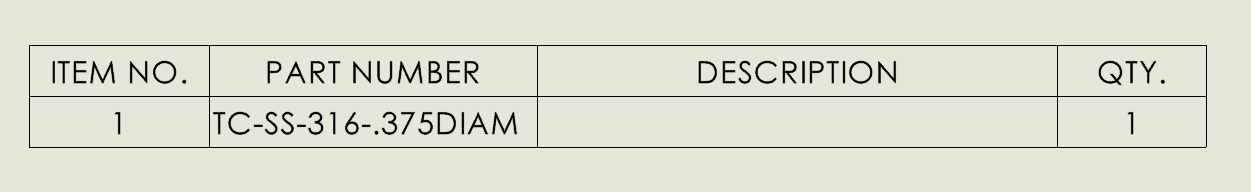

Define a Part Number Scheme Before Building Your BOM
It’s standard practice for each part to have a unique corresponding part number. In your BOM, the part number is the primary identifier, with a secondary text description to make it easier for humans to read. Regardless of what scheme you choose, it’s critical to keep a master part list, even if it’s just another spreadsheet.
There are different schools of thought on part numbering systems:
Sequential Part Numbering
The simplest approach uses a purely sequential system where the part number doesn’t provide any added information about the part. For example, a screw and a resistor entered into the system adjacent to each other will be parts 001514 and 001515. This has the advantage of being lightweight in implementation, but lacks human-readability. If you opt to use this approach in your manufacturing BOM, consider using part numbers optimized for humans as well—this can help mistake-proof your manufactured assemblies down the line.
Intelligent Numbering (Denoting the Type of Part)
A different approach is to use an intelligent system in which the part number denotes what type of part it is. For example, a screw may be part SCRW1014, and a resistor will be RES2208. This is more easily digestible for humans, but as the types of parts in your master part library increase, you’ll need to make new categories and define new rules (see example P/N designation for a super simple BOM in the image below).
BOM Example with Meaningful P/N
