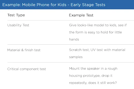

Here’s an example of what some early-stage hardware test plan overviews might look like for a mobile phone product for kids:
Examples of early-stage tests
These tests will give you the feedback you need to iterate on your designs and ultimately build a working prototype.
