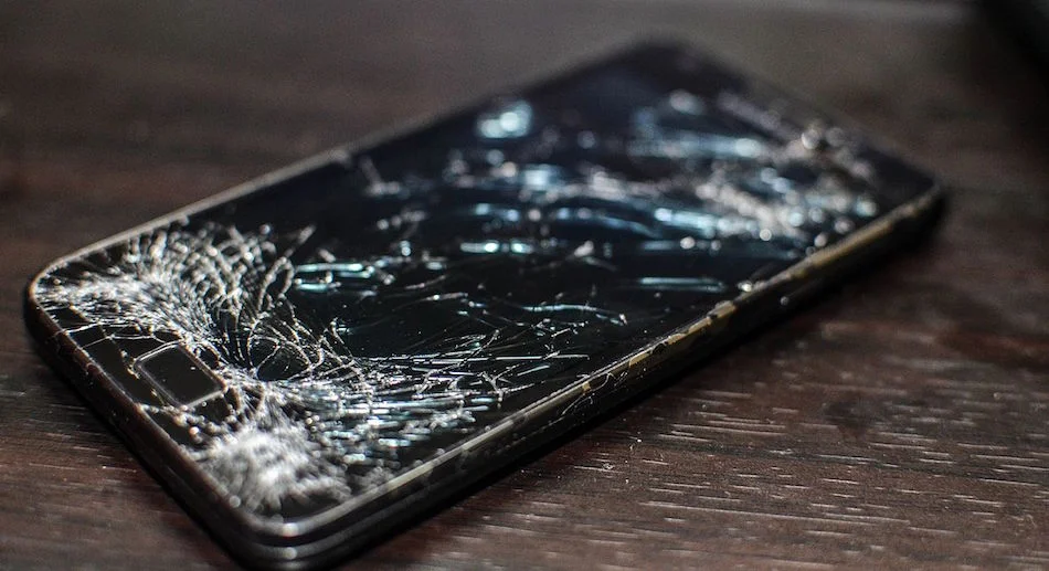

drop testing housing can be a helpful initial test
Drop testing the mechanical housing can be a helpful initial test

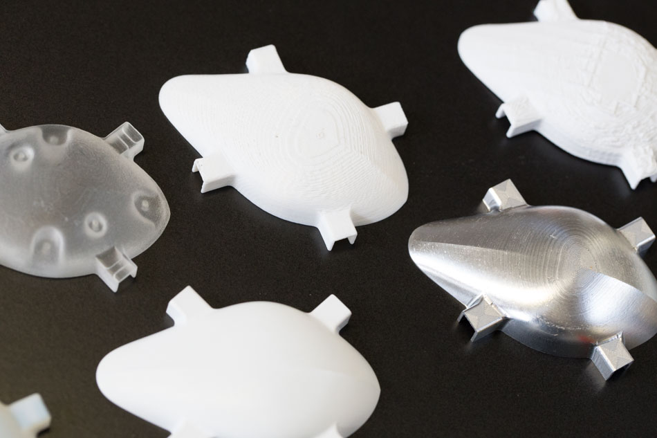

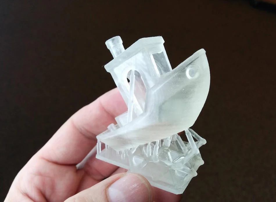

3D printed materials are helpful for prototyping

  • Sourcing and Cost Optimization: To get the most out of engineering budgets, sourcing teams should utilize commercial-grade, non-certified materials for initial verification cycles. Save premium medical-grade, flame-retardant (UL94-V0), or fully certified material lots strictly for final compliance and regulatory testing phases.
For rigorous mechanical, thermal, or cyclic fatigue testing, engineers use subtractive and formative prototyping processes to ensure data fidelity. CNC-machined prototypes in production-grade engineering plastics (such as Delrin, PEEK, and Polycarbonate) or metals (such as Aluminum 6061-T6 and Stainless Steel) provide true isotropic properties and precise tolerance stack-up validation.
Similarly, sheet metal fabrication is required to test structural chassis rigidity, drop-impact structural integrity, and thermal dissipation, while low-volume urethane casting bridges the gap for testing elastomeric components and multi-material overmolded designs before investing in hard production tooling.

3D Printing (FDM, SLA, SLS)ABS, Polycarbonate, Nylon, Photopolymer ResinsSpatial assembly checks, cosmetic reviews, and non-structural form validationHighly anisotropic; layered boundaries introduce structural shear vulnerability

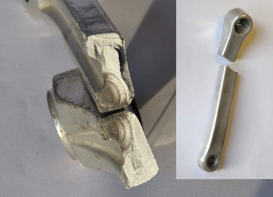

Don’t think of a prototype failure on the test bench as a project setback; it’s a successful risk mitigation event before capital is deployed for production tooling. But the value of that failure depends entirely on the rigor of your post-test diagnosis.
When analyzing test data, engineers should avoid the trap of modifying CAD geometry immediately based on a single data point. Instead, determine whether the failure was systemic in the design or an isolated anomaly in the rapid prototyping process itself.
To systematically translate test anomalies into actionable design revisions, execute a four-part failure analysis protocol:
  • Isolate Design Flaws from Manufacturing Defects: Before redesigning a feature, verify that the prototype was built to specification. In molded or cast parts, failures often stem from localized manufacturing anomalies—such as internal porosity, material contamination, or weak knit lines (where polymer flows meet). Conversely, if CNC-machined metal parts fail under identical load profiles across multiple samples, the root cause is likely a systemic design flaw such as an unexpected stress concentration or an incorrect tolerance stack-up.
  • Deploy Physical Root Cause Analysis (RCA): Move beyond digital data logs to examine the physical hardware. Utilize non-destructive evaluation (NDE) such as industrial CT scanning to check for internal voids or micro-cracks before sectioning a part. For destructive analysis, inspect the fracture topology under magnification. Identifying whether a failure mode is ductile (showing material elongation and tearing) or brittle (clean, sharp fractures) tells you exactly how the material behaved under stress.
  • Audit and Filter Data Outliers: When a single test sample fails prematurely while others pass, do not simply average the data or discard the outlier. Conduct a thorough statistical check. Isolate whether the variance was caused by an uncalibrated test fixture, human error during setup execution, or a genuine statistical deviation in material performance that could manifest as a low yield rate in mass production.
  • Close the Loop and Update Risk Matrices: An engineering change is incomplete until the lesson is implemented. Feed your findings directly back into your active Design Failure Mode and Effects Analysis (DFMEA). Update the severity, occurrence, or detection rankings for that specific failure mode, and document the explicit CAD or material modification implemented to mitigate the risk in the next build cycle.
