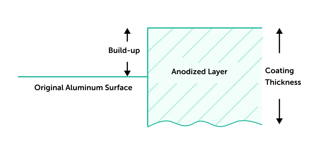

Coating Thickness vs Build-up
Part of the anodizing process is to remove the naturally occurring oxide layer, in a process called deoxidizing, by immersing the parts in an acidic solution. The electrochemically formed oxide layer is thicker than the naturally occurring oxide layer. Therefore, the build-up is actually less than the coating thickness, or the actual dimensional growth is less than the thickness of the anodized oxide layer.  Here are the terms commonly utilized in anodizing and you can see these in more detail in the image below:
