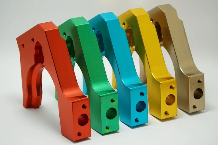

![CNC Machined hard anodized color parts](https://www.fictiv.com/wp-content/uploads/2023/04/CNC-Machined-hard-anodized-color-parts.jpg)
Hard Anodizing Color Properties & Considerations:
- Thicker coatings generally produce darker colors. The thickness of the anodized layer determines the depth or intensity of color achieved. The thickness of the oxide layer created through hard anodizing can also be controlled to achieve different levels of hardness and corrosion resistance. This can be useful in applications where durability is important.
- Hard anodizing produces a range of colors, including black, gold, blue, red, and green.
- The specific shade of the color can vary depending on the alloy used and the process parameters, such as the current density, temperature, and time.
- The color of the anodized layer can fade or change over time, especially when exposed to UV light or harsh environments.
- Hard anodizing is not suitable for achieving exact color matching, and there may be variations in color between different batches.
- Hard anodizing colors are durable and long-lasting. The dye or pigment is absorbed into the pores of the oxide layer, creating a color integrated into the metal itself. This makes it more resistant to wear, scratches, and fading than surface coatings or paints.
- Hard anodizing colors can be customized to achieve specific shades and finishes, depending on the needs of the application. Common colors achieved through hard anodizing include black, red, blue, green, and gold.
- Hard anodizing colors can improve the electrical conductivity or insulation of the metal surface. This can be useful in electrical and electronic applications where conductivity or insulation is important.
Hard anodizing colors offer a range of benefits, including improved durability, corrosion resistance, and aesthetic appeal. The specific benefits and colors achieved will depend on several factors, but hard anodizing colors can be a valuable solution for many applications.

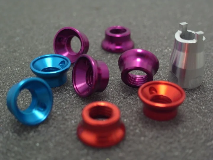

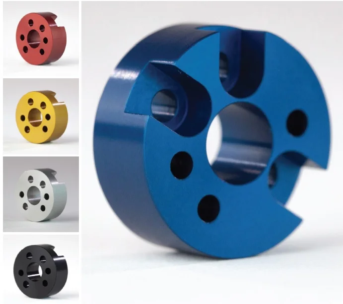

What are the Standard Hard Anodizing Colors?
Several standard anodizing colors are commonly used in industrial applications. The exact shades of these colors may vary depending on the specific alloy being anodized and the process parameters used. Still, the following colors are commonly achieved through anodizing:
1. Clear or natural anodizing: This colorless, transparent finish provides good corrosion resistance and protects the underlying metal from further oxidation.
2. Black anodizing: This dark, matte black finish is achieved using black dye. Black anodizing is often used for decorative purposes and to reduce glare on anodized aluminum surfaces.
3. Gold anodizing: This light to medium gold color is achieved using yellow dye. Gold anodizing is often used for decorative purposes and to improve the appearance of anodized aluminum surfaces.
4. Red anodizing: This bright, deep red color is achieved using red dye. Red anodizing is often used for decorative purposes and to improve the visibility of aluminum parts.
5. Blue anodizing: This medium to dark blue color is achieved using blue dye. Blue anodizing is often used for decorative purposes and to improve the appearance of anodized aluminum color surfaces.
6. Green anodizing: This light to medium green color is achieved using green dye. Green anodizing is often used for decorative purposes and to improve the appearance of aluminum surfaces.
It’s important to remember that the appearance of these standard anodizing colors can vary depending on the specific dye used and the thickness of the anodized layer. Additionally, custom colors can be achieved through anodizing, including purple, pink, and bronze.

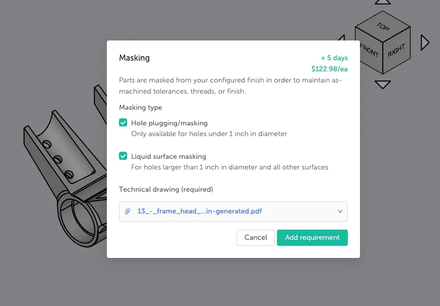

Tips for Masking and Plugging Parts Before Hard Anodizing
For parts with threads and holes or intricate designs with complex assemblies, masking and plugging prevents anodization buildup that may negatively impact the function of those features, especially if you require tight tolerances.
Masking can be used for aesthetic purposes, such as different colored areas, or to protect or promote certain physical or electrical properties, such as electrical conductivity in specific areas. Depending on the part complexity and masking design, masking and plugging can actually reduce the costs in the anodizing process because you may not need your entire part anodized.
How to Communicate Masking Requirements
While there is no single method that all design engineers must use to call out masking and plugging requirements, traditionally, communicating masking or plugging requirements involved
- Callouts on 2D drawings for the finishing type that includes notes or flag notes for surfaces to be finished or to be masked
- Masking and plugging legends on drawings. Basically, a table that shows what the masking or plugging requirements are for each part in an assembly.
- Highlighted or color-coded drawings with masking one color and non-masked areas another color.
- Complex masking drawings which accompanying the part drawings, to show the dimensions of masked areas and are often associated with notes or instructions for masking.
Fictiv provides tools that enable you to break free from these types of tasks when sourcing your parts. Customers can easily request and specify masking directly in our intelligent digital manufacturing platform. This option provides much needed time savings and productivity gains compared to the methods above to traditionally specify masking or plugging.
![Fictiv platform options for selecting masking](https://www.fictiv.com/wp-content/uploads/2023/04/Fictiv-platform-options-for-selecting-masking-.jpg)
You can specify holes and surfaces that require masking before anodization, paint, and other finish coatings. To learn more about how to specify masking in the Fictiv platform, check out this article.
Pro-Tip: you can learn more about masking and Fictiv’s finishing capabilities in our Ultimate Guide to Finishing CNC Machined Parts.
