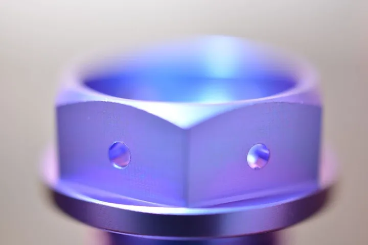

![Anodized titanium fastener](https://www.fictiv.com/wp-content/uploads/2023/05/Anodized-titanium-fastener.jpg)

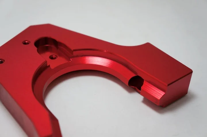

![anodized aluminum part](https://www.fictiv.com/wp-content/uploads/2023/05/anodized-aluminum-part.jpg)
