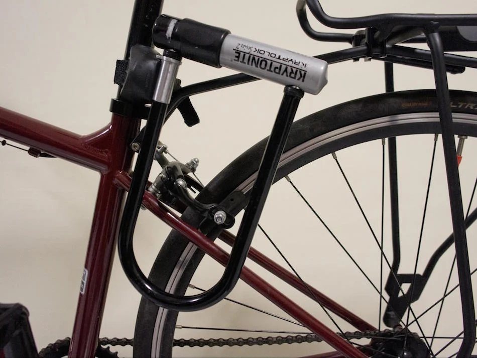

Bicycles are a great example of how you can design a corrosion-resistant product. Typically made of steel, aluminum, and carbon fiber, bicycles are also regularly exposed to the elements. Rain + road dust = water + electrolytes = corrosion. Adding a physical barrier to prevent direct contact with the external environment helps to keep corrosion in check; options include painting, powder coating, vinyl wrapping, anodizing, and even waxing. These methods, referred to as passive coating, serve to keep water and salt out, preventing corrosion, and it’s important to plan for them when designing products that you know will spend time outside in the elements.
bike frame with U lock
Painting
You can plan to make your design corrosion resistant by factoring in the need for passive coating, which is what bicycle manufacturers use to improve corrosion resistance. Bicycle frames are painted to form a barrier layer—painting on a clean, dry surface means moisture can’t get trapped beneath the coat.

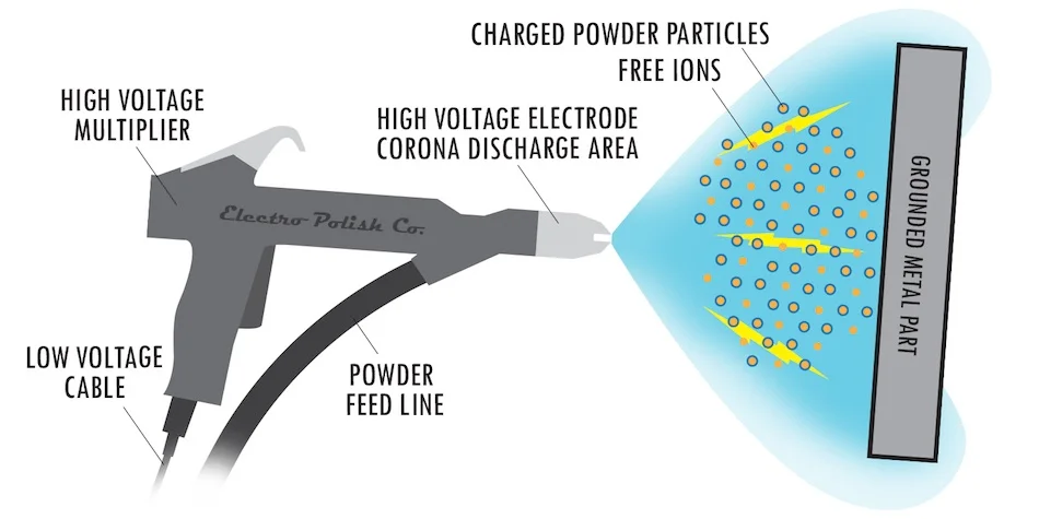

if you’re designing a product like bike racks, many of which are made of aluminium, you’ll want to plan to have the product powder coated, to avoid the pitting that can result when aluminum is scratched and in contact with water. Powder coating is done by spraying a layer of dry powder (thermoplastic or thermoset plastic polymer) electrostatically.
In powder coating, the powder coat gun has a positive charge, while the workpiece is grounded. This electrical difference drives the tiny particles towards the workpiece, kind of like the hair-rising balloon experiment you may have done in school. This ensures even coating, which is followed by a curing session.

You count on your U-lock for security, and you don’t want it to get corroded, so most U-lock manufacturers wrap the locks in vinyl to protect them from the elements—and as a designer, you’ll want to plan for this. Vinyl wrapping is like shrink wrapping; heat is applied once the U-lock has been sleeved with the vinyl (see the black, U-shaped tubing in the image below).
U-lock
‍Vinyl wrapping is like shrink wrapping heat is applied once the U lock has been sleeved with the vinyl

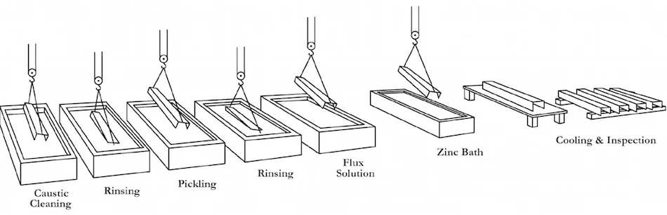

Hot-dipped galvanizing is a high volume manufacturing technique. The process is shown below. Each object has to go through caustic cleaning, followed by a few more stages of preparation, before it is dipped into a zinc bath and cooled.

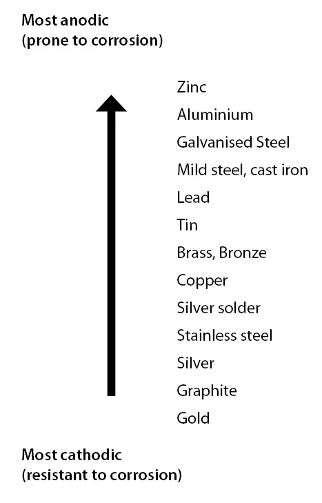

 Ensure galvanic compatibility

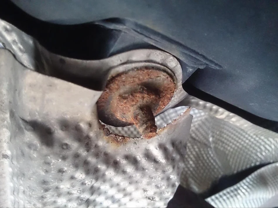

When you’re designing fasteners, it’s important to ensure that there is galvanic compatibility with the fasteners and the object. On the Galvanic Scale, metal that is more anodic is more prone to corrosion, and when more anodic metal is in contact with a metal that’s lower on the scale, corrosion activity is enhanced. The greater the disparity, the faster the rate of corrosion.
Galvanic Scale
Therefore, you don’t want to mix and match coating and metals; if you choose hot-dipped zinc-galvanized material, use fasteners and hardware with the same coatings. Screws and rivets are the most commonly used fastening methods, and the majority of them are made of steel, which happens to be lower on the Galvanic Scale, so you have to be aware of this.
If you start combining different types, there’s a chance the different metals will start their own corrosive reactions—which is exactly what you are trying to prevent. Stainless steel will degrade galvanized steel, so don’t install galvanized sheets with stainless steel screws.

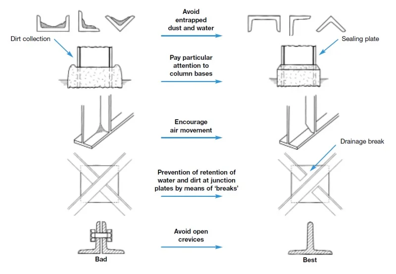

Avoid crevices in your design
The graphic below shows how drops of water on the body of a product can result in rust formation. When the surface of a reactive metal gets wet, the oxygen concentration is lower relative to the surrounding. The area around the drop becomes cathode, while the surface below is anodic.
how drops of water on product body can cause rust
This localization of electrical activity is what causes spots of rust to form on a kitchen basin, which gets worse with a lower grade of stainless steel. You can design against this form of corrosion by removing traps to ensure that there is uniform oxygen concentration around the bodywork.
We can learn from the construction industry, which does crevice corrosion prevention best. Rules like allowing water and dust to flow freely but not get trapped onto the surface are helpful. Designs are simplified to reduce the number of crevices, and if crevices cannot be avoided, weather-sealing can help counter corrosion.
In other words, reducing the number of joint parts, coating, and sealing can help avoid crevice corrosion.
