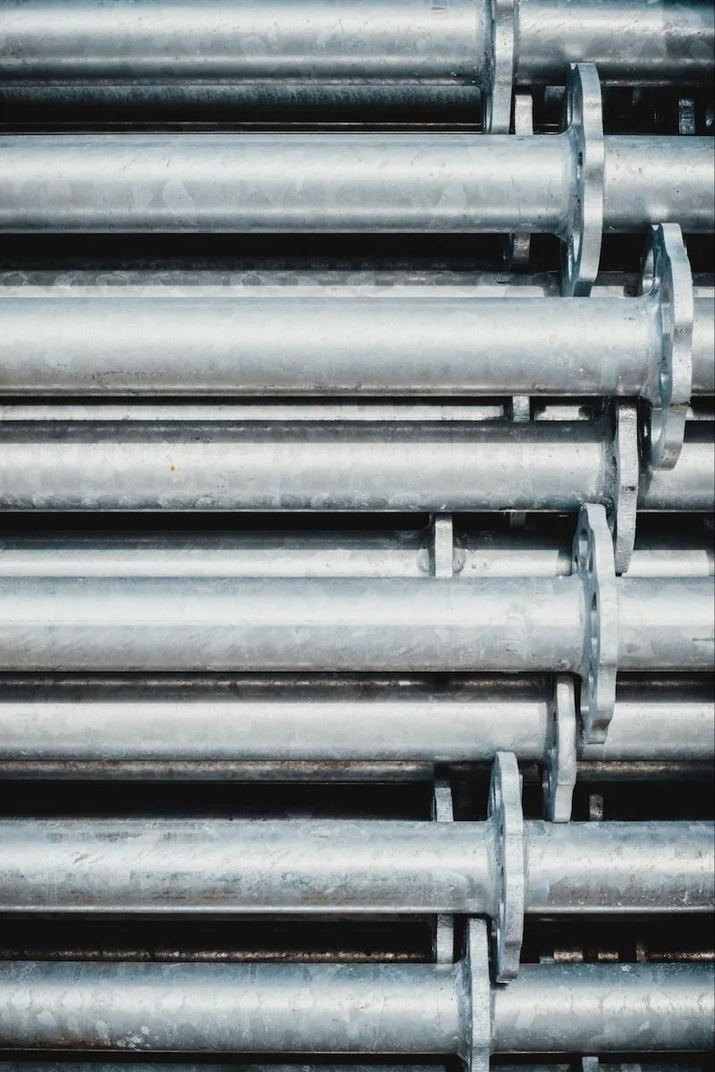

Oxidized metal tubing Photo by Bernard Hermant on Unsplash

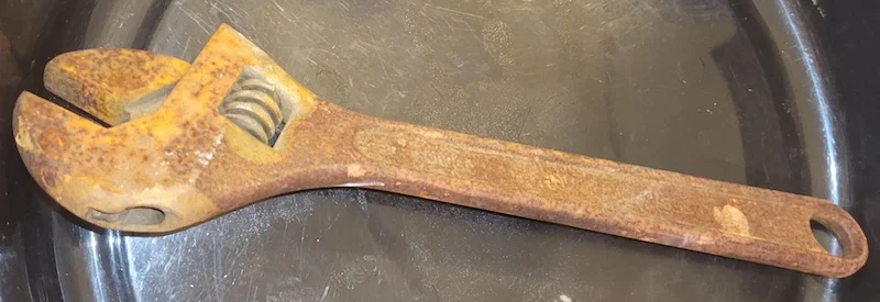

a rusty wrench I left sitting outside over the winter
Rust is used to describe the process of iron corrosion, so if a metal alloy doesn’t contain iron, it can’t rust. The byproduct of the corrosion of iron (rusting) is iron oxide, as shown by the following chemical formula:
corrosion of iron
The formation of rust (FeOH – iron oxide) requires the presence of water and oxygen, and rust is permanent. You cannot reverse the reaction of rust, but you can remove rust from a surface and there are methods to prevent further rusting.
