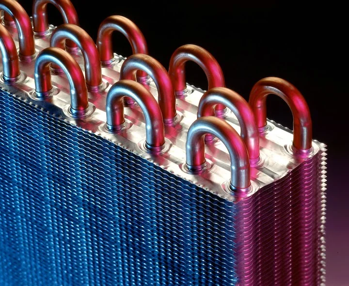

shell and tube heat exchanger with fins on the tubes
The best materials for heat exchanger design are materials with a combination of high thermal conductivity, high temperature resistance, excellent corrosion resistance, good mechanical strength, low cost, and wide availability.
Copper
Copper is the most well-known metal with high electrical conductivity. Copper also has a high thermal conductivity due to its lattice-like atomic structure, which allows efficient energy conduction throughout the material. The number of free electrons in each atom of copper also allows for fast and efficient movement of energy via thermal or electrical conduction. This high thermal conductivity means that heat transfer from the hot to cold fluid will occur as efficiently as possible and with as much speed as possible.
Copper also provides excellent corrosion resistance, fluid compatibility, and good mechanical strength. Copper comes in many alloys that are generally readily available and relatively inexpensive. In addition, it’s relatively easy to machine and weld, making it suitable for multiple manufacturing methods. Copper is especially suitable for tube and shell heat exchangers thanks to its high ductility — which allows it to be drawn into thin-walled tubes or extruded into small wires without fracturing.
