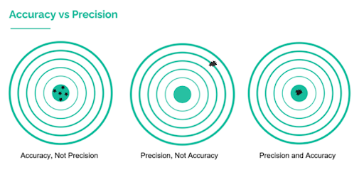

“Precision machining” is a term many manufacturers throw around to entice potential buyers and elevate their perception of their capabilities. But to truly understand what a precision machined part is, we need to review the definitions of precision and accuracy, two terms often used interchangeably and incorrectly. Both are related to quality, but they are not the same thing.

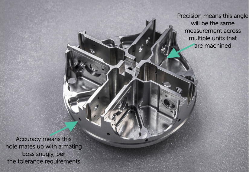

Accuracy means how close to the targeted values something is; for example, how close the measurement is to the dimension. High accuracy means a measured value doesn’t deviate much from the desired value.
Precision is the ability to replicate consistent attributes across many produced units (for example, hitting the same dimension when machining 200 parts). Precision is repeatability.

Therefore, precision machined parts have the same dimension across many machined components. When a machine shop says they can hit your precision requirements, they can hit your dimensional requirements across multiple parts of the same design.
Now, the ability to do this also means that a shop is more likely to hit your design’s accuracy targets/tolerance requirements — but technically, a machine shop can be capable of high precision without ever meeting accuracy requirements.
You ideally want a precision machined part supplier who can meet both accuracy and precision requirements so you can make sure your parts are consistent and meet your design intent.
