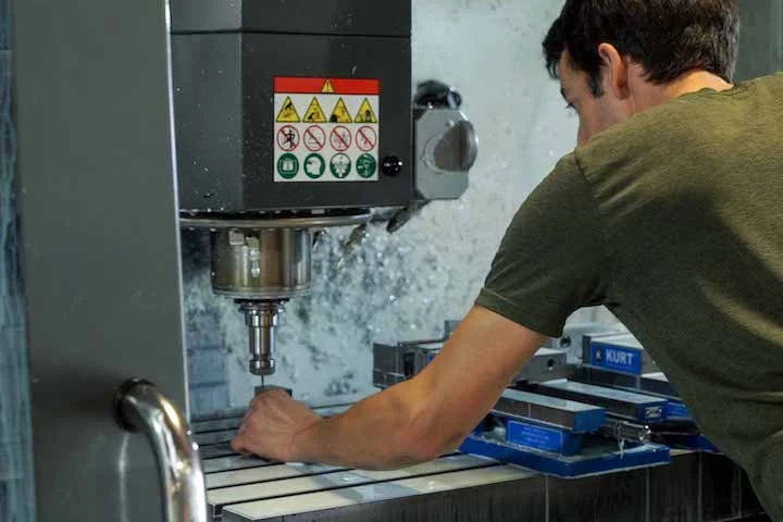

2. Reduce the Number of Setups
A CNC machined part requiring more than one setup
Each setup required to machine a part adds time to the overall process, so reducing the number of setups helps reduce lead times. This can be achieved by either designing parts to be machined in a single setup or consolidating multiple parts into a single setup. You can also break down larger parts (that would require more setups) into smaller parts that can then be assembled. Consult with your manufacturing partner on your strategy to see which approach will make a net impact on lead time.

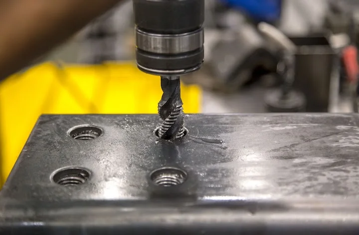

3. Design Features to be Standardized and Machined with Standard Tools from Standard Materials
Part with standard threaded holes
Designs requiring only standard tools and materials help reduce lead times by reducing the time required for tool changes and material procurement or handling. Standard tools are readily available, and their performance is well-known, which makes life easier for the machinist.
Similarly, standard materials can be easily sourced, which reduces material handling time and overall lead times. Common materials reduce lead times because they’re easier to source and stock, and common materials may be easier to machine, which reduces machining time.
One area that’s simple to standardize is to only specify standard threads. Custom threads are rarely necessary, and manufacturing them only adds to your lead time. Another opportunity for standardization is to design standardized parts, which reduces the need for custom tooling and setups that add time and cost.

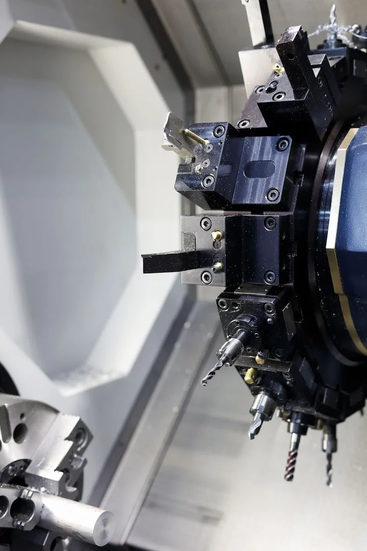

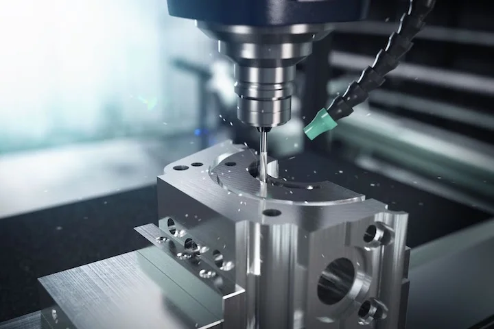

4. Account for Your Design’s Tooling Requirements During CNC Machining
CNC machining tool changer
Designs optimized for tooling can have a significant positive impact on lead times. This includes
optimizing tool paths, which reduces the time required for machining by using the most efficient tool paths and reducing the number of tool changes required.
Speaking of tool changes, every time a tool is changed during machining, it adds to the lead time. So, design parts that can be machined with fewer tool changes by minimizing the number of different tools required.

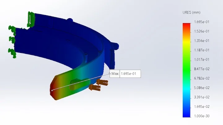

9. Test, Optimize, Simulate, and Prototype
FEA of a face shield headband
Before proceeding to large-scale manufacturing, you should do some prototyping to test and optimize your designs. Prototyping allows for quick testing and optimization of the design before full-scale production. This can help to identify potential issues and reduce lead times by ensuring that the final design is optimized for manufacturing.Also, if you can, use simulation software, like a Finite Element Analysis program, to evaluate your design. This software can be used to optimize the machining process and identify potential issues before production begins. This can reduces lead times by minimizing the need for trial and error during production.
